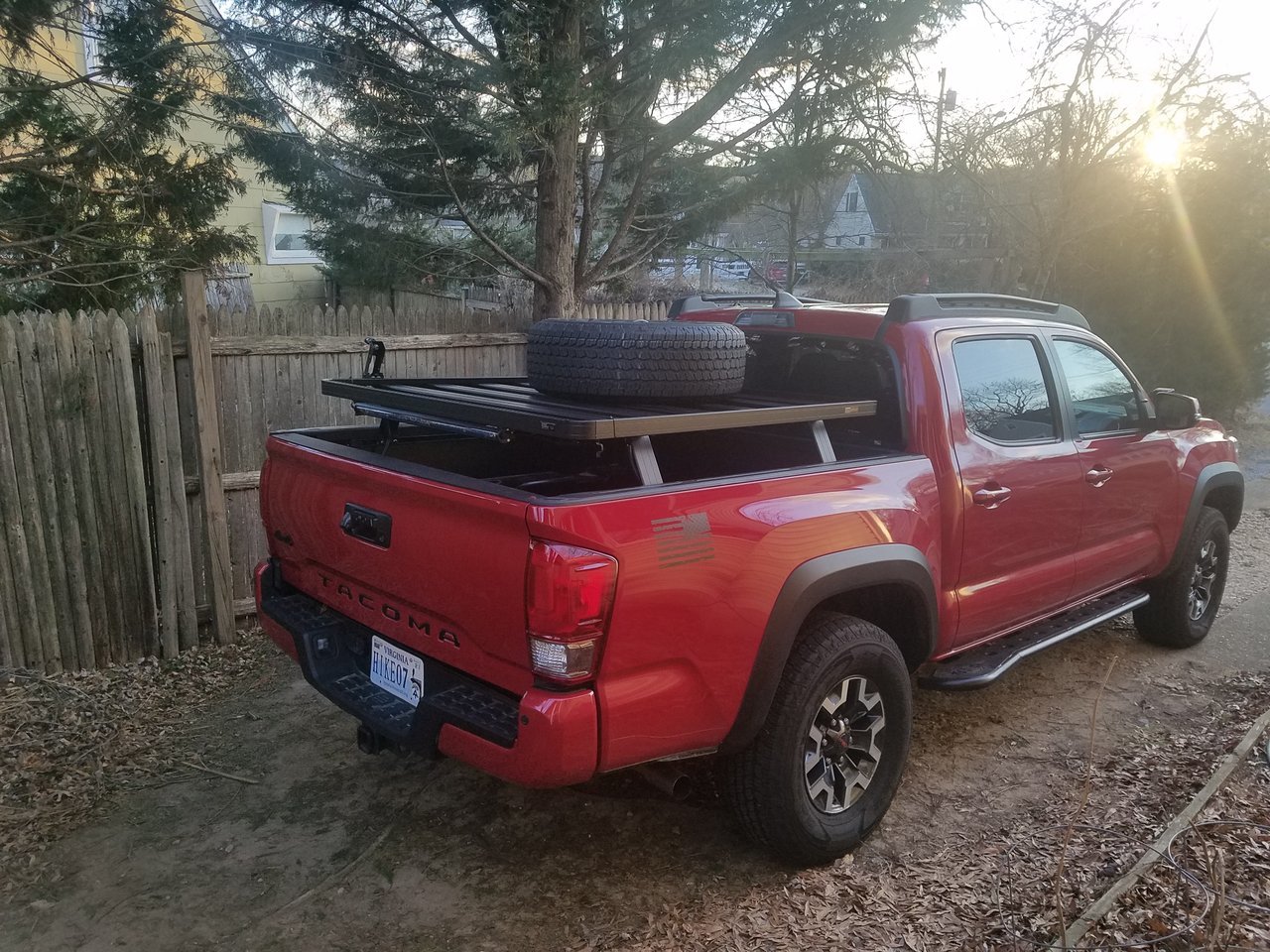

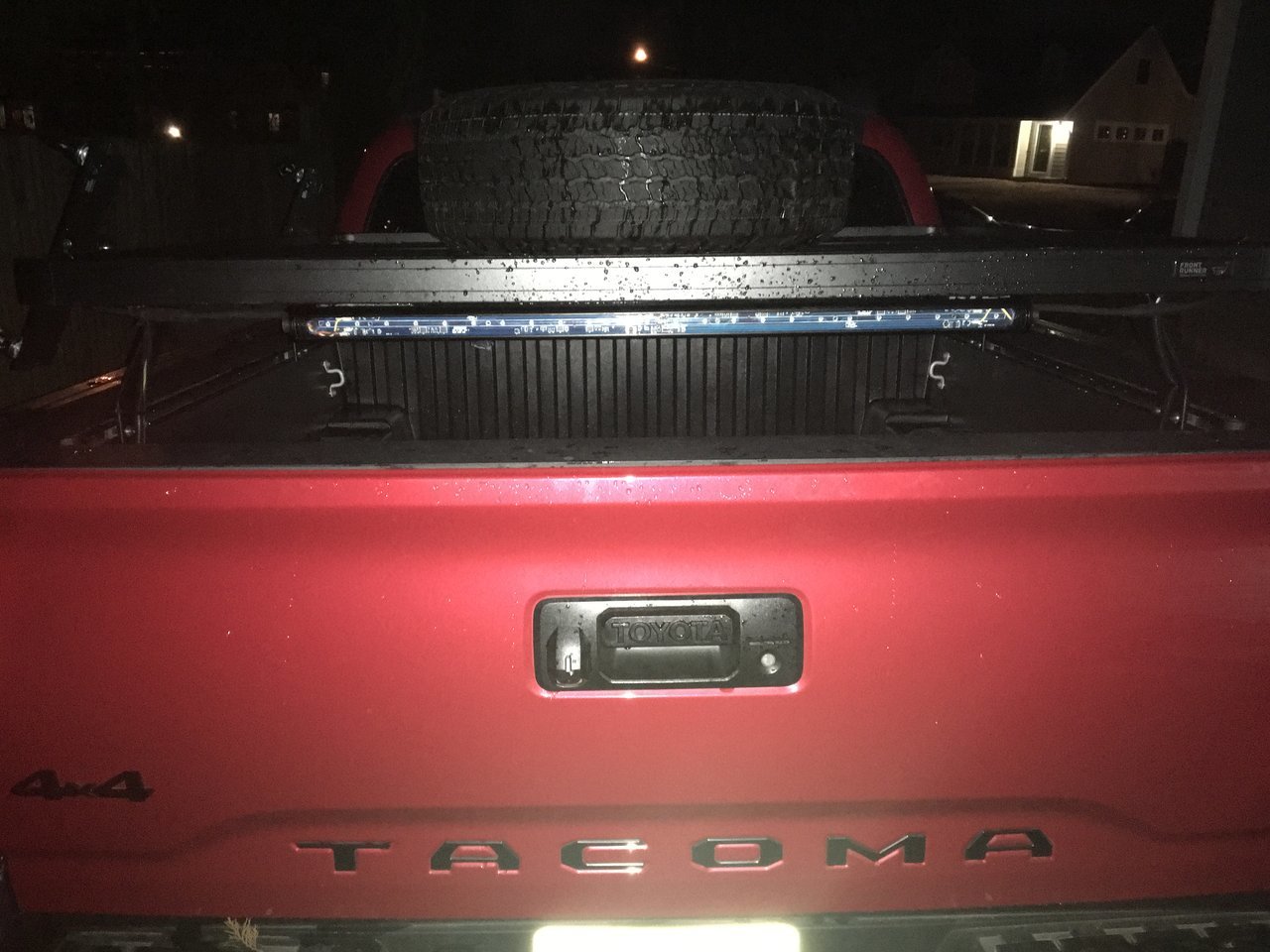

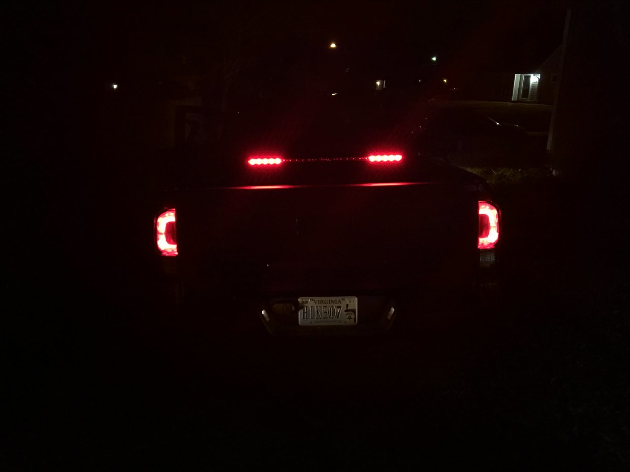

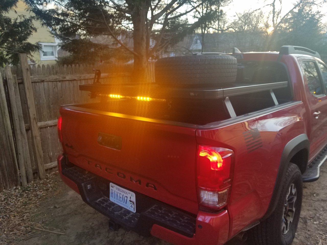

    Took some quick pictures of my install.IMG_0285.jpgrIMG_0288.jpgIMG_0291.jpg I couldn't get a shot of the turn signals because apparently my timing sucks.
    Coot83 likes this.

    Thanks for posting here as well. Any photos of the truck during the day?
    Once again, very nice job on the install!

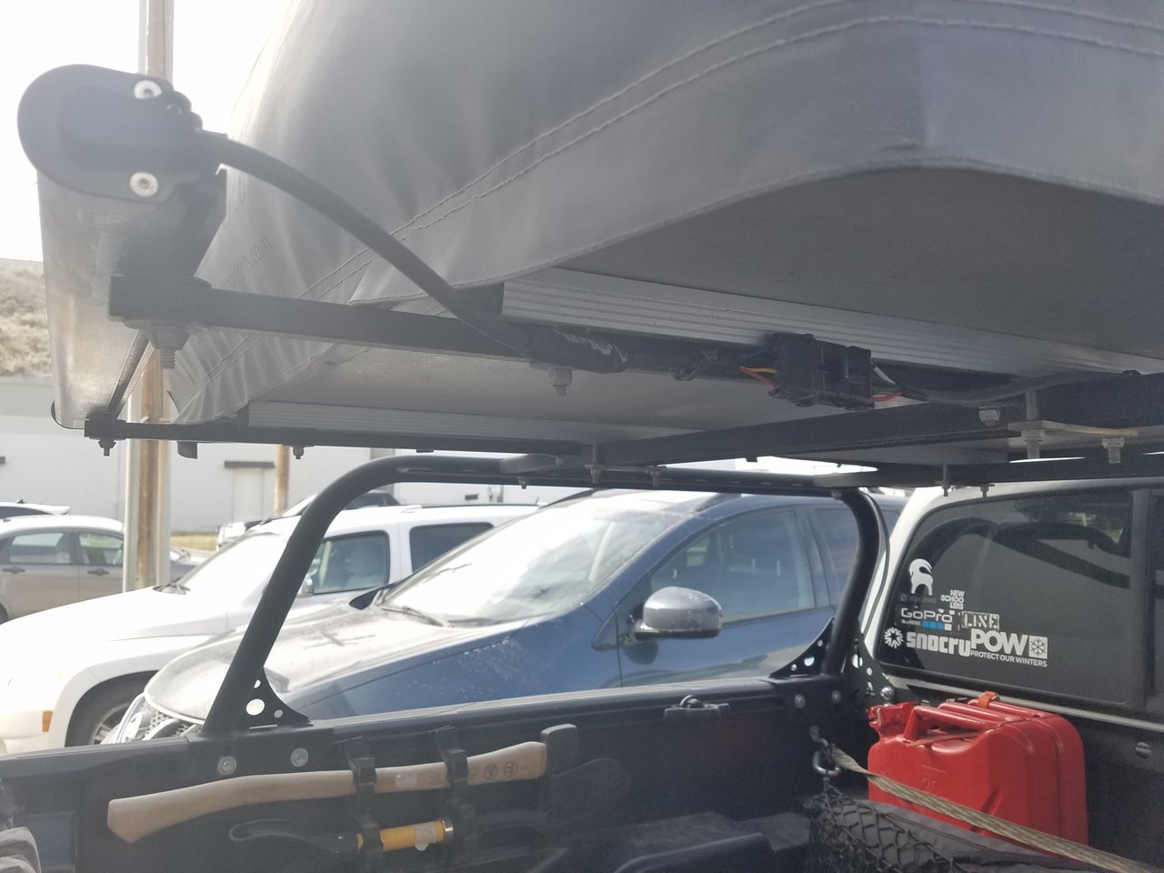

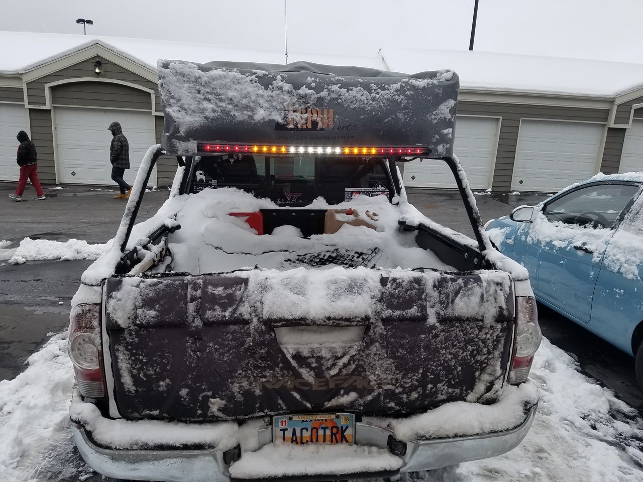

    Don't have the -S model, but I used the trailer brake controller green wire as the brake signal since it was more proximate to the engine bay. The running R/A and W rev lights are run off a switchpros unit, but I looked at tapping my taillights or the trailer harness for inputs when I was looking at the -S model.
    @Coot83 / @paranoid56 I used weatherpack connectors (you can see one just below the right red LEDs) at the front bed rail and at the bar to make it QD since my bed rack is disassemble-able as well and I could mount to the back of my prinsu if I didn't run the tent. As far as legality, I couldn't use it as a 3rd light because state code says it has to be centered...but your states may be different.
