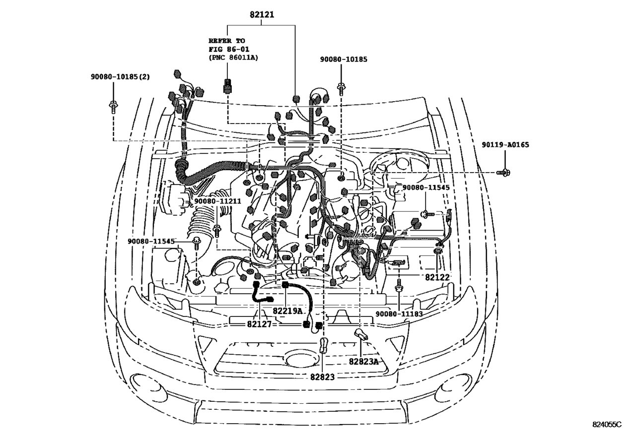

    I found the assembled connector with pigtails (can give a link if needed), but does anyone know the part # for this entire harness / have a diagram showing all its branches? I only need to replace the male amp connector (the pins on the prndl switch corroded off and are stuck inside the male half) but there is basically no slack in the harness to pull enough wire down to solder on the new connector.

    82121-04470
