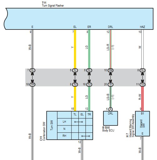

    There are two fuses that supply power to the Turn Hazard Flasher Module:
    1. IG1 Fuse 10 Ampere.
    2. TRN-HAZ Fuse 15 Ampere.
    Are they both good? You said you replaced the Flasher Controller so there isn't much left to the circuit:

    No, it isn't the horn fuse.
    The Horn Fuse is labeled "HORN" 10 ampere and is in the fuse box under the hood.
    The TRN-HAZ 15 ampere fuse is labelled "TRN-HAZ" and is also in the under the hood fuse box.
    The IG1 10 ampere fuse is labelled "IG1" and is in the fuse panel to the left of the steering wheel in the cab.

    You cannot tell a blown fuse by looking at it, you need a multimeter to check resistance. A good fuse should read 0 ohms across it.
    Look at the prints I posted above.
    I would undo everything that was done up to now and put it back to stock.
    Screw LED's. They aren't worth the headache.
