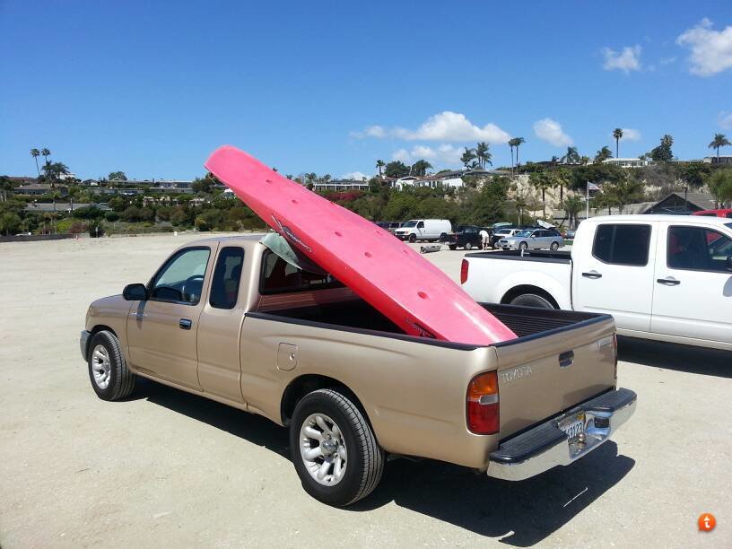

    I want to install a simple back rack / headache rack but I don't want to drill holes into my bed rails. My SR5 does not have any post holes in the corners nor a track system to utilize, and I would like to keep it that way. Has anyone ever done something with feet that sat in the bed and/or mounted into the tie down points at the front of the bed? I am considering making a custom rack that would bolt in place of the anchor points using the same Toyota bolts.
    Goal is to take the weight of this kayak off my roof because after only 2 trips I've already scratched the paint :-( Currently resting on towel with straps through the kayak into the bed tie downs, but the towel tends to shift, especially in windy conditions at the beach here.
    I don't want a big rack, just a simple single bar that runs at the height of the cab. I also like having the option to mount a flood light to use when camping.
    Thanks for your help and suggestions.

    Cheap, quick and ugly would be a simple PVC hoop just above the cab 3-4" lashed to each corner tie down point. 3" tube seems like it would get the job done,,maybe thicker if you feel the need.
    Some cutting with a hacksaw, a bit of pvc glue, a couple 90° elbows,, done. Easy to remove to utilize the full bed then if needed. Stick each leg down in to a open cavity cinder block, then lash each leg to the tie down.
    Since you already have mounting holes drilled and threaded into the bed (corner tie downs). You could use those as a more sturdy point of attachment for a better roll bar type setup.

    Lol! As much as i like the removable concept, I'm not looking for something that may snap apart on the freeway. We will be taking the kayak to Yosemite later this year (cruise @ 80 mph on interstate 5).
    I will explore the option but that sounds flimsy to me...

    I drilled holes in my bed rails for my in-process rack, but while working things out I also explored clamping a rack to the bed rails. Though I went in a different direction, consider how a rear cap is held on, a few c-clamps with perhaps a spacer to take up some of the space under the rail could hold your rack to the top of the rail pretty well.
    I'd suggest some sort of a front edge or tabs that would overhang into the space between the bed and cab, other wise you'd be relying on friction only to hold your rack in place. I'm not sure what materials would work best as there is still a lot of risk of scratching, especially between the bed and cab if the bed moves around. A piece of angle iron over the front lip, welded to some sort side rails is where I would start. Then a A-frame on each side connected with a top cross bar.
    This is more or less what I have made, but instead of clamps I drilled the rail and bolted everything in place. If I haven't explained it well, I can get a pic or 2 tomorrow.
    Oh, I think I see a drop in bed liner... that might be a deal breaker for clamping to the rail, unless you want to cut holes in it to get under the rail. The problem I see is that you need 2 points of contact to hold a vertical frame in place. i would not trust holding a rack in place by the tie downs only. Regardless of how you did that I think there would be too much leverage at the top of the rack to keep it secure.

    I can tell you have thought this out. I was considering just a simple unistrut rack (cross bar attached to verticals with feet in the bed) with tie downs holding in place, so it's good to hear a second opinion confirming my concerns about the leverage involved with an 80 lb kayak at highway speeds.
    I don't mind cutting into the liner, have already done this several places. I picked it up used for $20 lol
