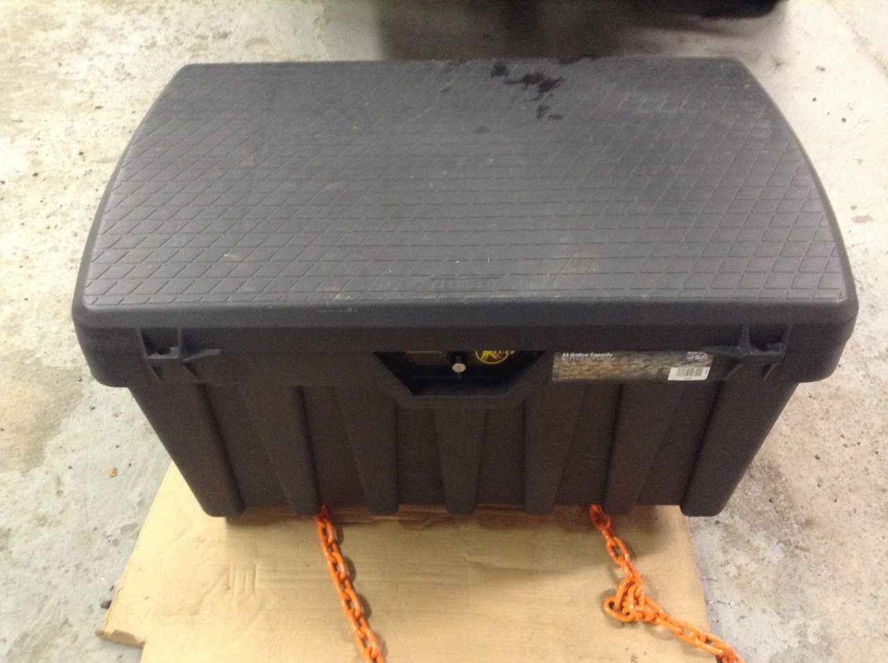

    I use a (modified) Contico 53 gallon storage bin.
    https://www.tractorsupply.com/tsc/product/contico-pro-tuff-bin
    https://www.walmart.com/ip/CONTICO-Portable-Tool-Box-37-W-x-21-D-x-20-H-3725/19514860
    I bolted some 2'' steel tubing underneath, the box is pre-marked for holes.
    I ran some heavy hardened chain in and around and then padlocked it to the front bed tie-downs.

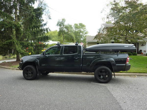

    It's made a great place to store all the crap I have to tote around up here in the winter (shovel, tarps, axe, etc.) It has a built in lock and can be padlocked either side as well. I have less than $100 in my setup. If you want something less hands-on, you could mount a roof-top carrier to the bed with crossbars.
    https://www.tacomaworld.com/threads/bed-bars-rack-for-truck-bed.116467/
