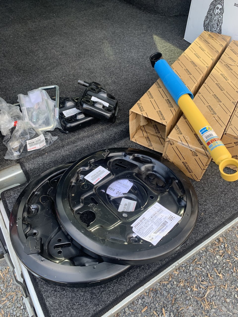

    Hey everyone, I just bought a ‘03 extended TRD. It came with new uninstalled bilsteins and oem backing plates for the rear. The struts are straight forward but I couldn’t find much on the rear backing plate replacement.
    Do you all have any pointers or a DIY that I’m not seeing?

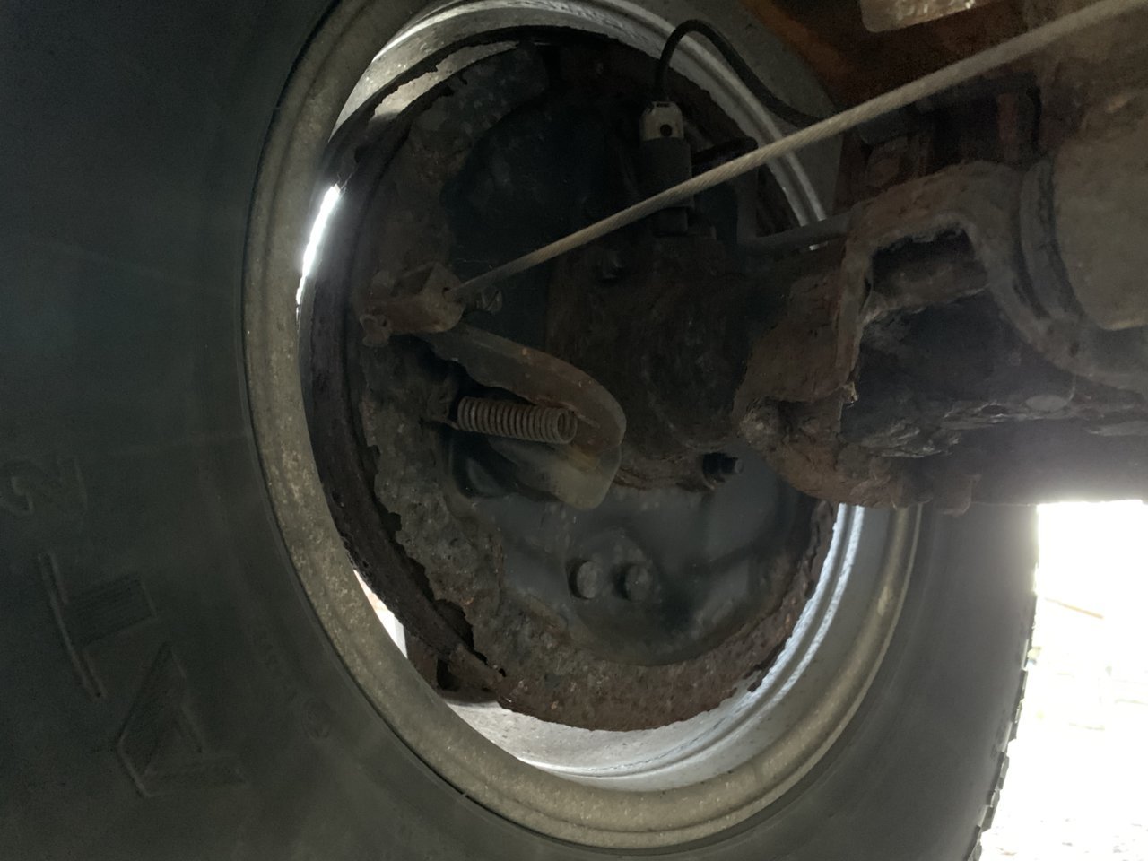

    What do the existing backing plates look like?

    Pretty rusty. I have my first PA inspection coming up on Friday so I’m patching myself up for what they say. I’ll post a pic when I get home.
