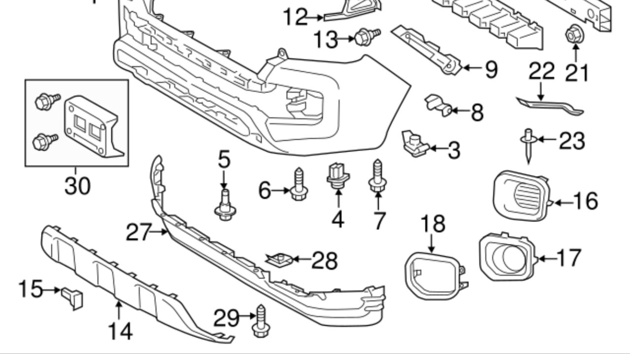

    I’m replacing a dented and now sagging lower trim panel (some asshole hit me in a parking lot with no note). When I pulled off the front bumper trim a blue clip came out:
    All I’ve found are part schematics like this
    Help on where it goes please!

    Help with what? It looks to me like item 15.

    spoiler clips
    gotta drop bumper to find which one is missing

    I believe that is one of two blue clips that hold the lower bumper valance to the bumper. There are other clips molded into the valance also but there are blue ones on each side and they’re kind of a pain to remove. I could be wrong but it looks very familiar from when I replaced my lower valance (the piece the license plate bracket screws into). Lower corner each side. You will have to look hard to find them.

    Yep. The difficult thing to do was to get them unclipped to remove the old valance. I ended up just taking wire snips and cutting part of the valance to remove the blue clips so I could remove the lower valance. Going on was easy as the blue clips just insert through a U-shaped clip. It’ll snap once it’s through. Assuming I’m correct about that part. It’s possible the same part could be used elsewhere also.

    You have to remove the radiator splash guards to see those blue clips. And your grill. The radiator splash guards will pull straight out once you remove the push pin.

    You are talking about the lower valance, right? If so, pull grill and splash guards. Get a flashlight. Lower corners looking from the inside of your bumper. You’ll need to be a bit of a contortionist to see them.

    Yeah the clip loop on the valence broke like the side that got hit did
