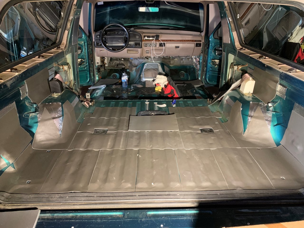

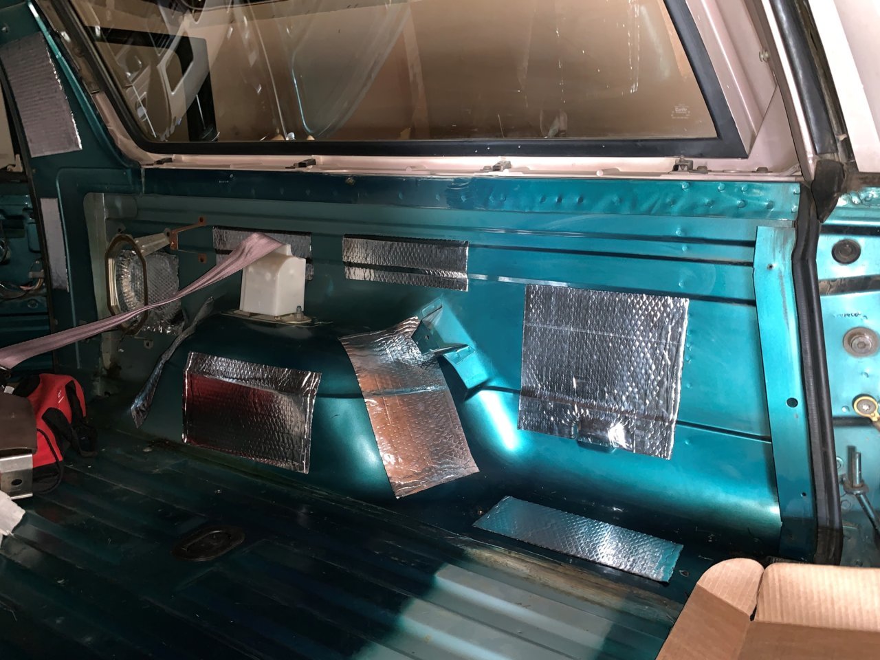

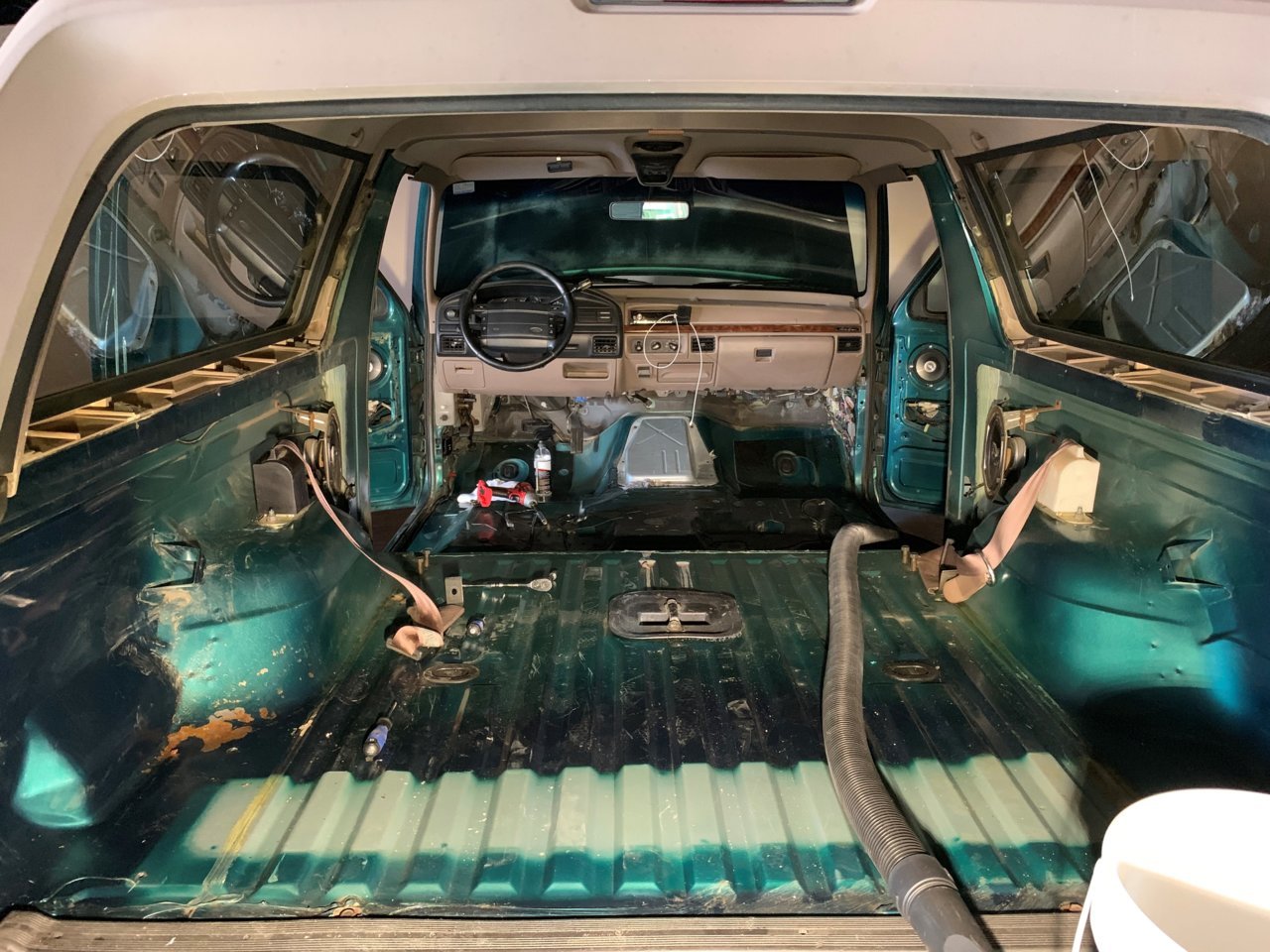

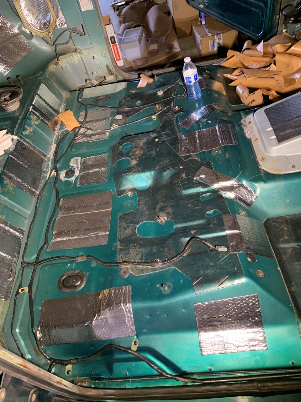

    Ok guys, i know NOTHING about audio. I need to know if these components will work nicely together, and have a good balanced sound.
    A heads up, the truck I'm working on is a 96 Eddie Bauer Bronco. I used to have a Tacoma, and honestly this group is much more in tune with things than the Bronco crowd. They're either old and grumpy, or they want to do a full professional show build, which I'm not interested in. I just want a bit more volume and depth than it currently has.
    I've gutted the interior and put down butyl damping tiles @ 25% coverage (Per sounddeadnershowdown.com info) and will be covering with 100% CCF and MLV.
    1. Do speaker baffles make a difference? Should i add them when putting in new speakers?
    2. Do i bother with new speaker wire? It would be easy to run under the carpet with everything pulled right now.
    3. I want to run JL Audio C1-690 6"x9" components in the rear panel, and JL Audio C1-650 6.5" components up front. I will mount the tweeters separately.
    4. Will a Kenwood KAC-M1814 drive those 4 speakers well? I don't plan on a subwoofer if i can get decent depth out of the 6.5 and 6x9's. If i did, i would run a single 8" powered sub under a seat.
