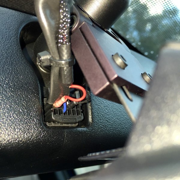

    Blendmount and mirrortap, DO ET!

    Nice, I just dont like putting suction cups on my windshield because it damages my tint. Ive seen people post in the forum that they adapt the gopro mount for the detector. But I like where mine is because I can get to the frigging mute button when needed.

    Checkout "Blendmount" and "MirrorTap". I've used both these products in the past.

    I used the exact same stuff for my 2012 Subaru STi. Works like a champ. Only thing is on my Subaru it has auto-dim cancellation when you shift to reverse so when I shift to reverse the radar detector turns off. No biggie really, ive only broken the speed limit in reverse twice..........

    Confirming the wires used in the above post are correct. I did the same thing with a mirror tap. Very easy job once you know which wires to use. My detector is mounted on top of the rear view mirror with velcro tape. I had my '05 Tundra this way and like that it is more out of sight.
