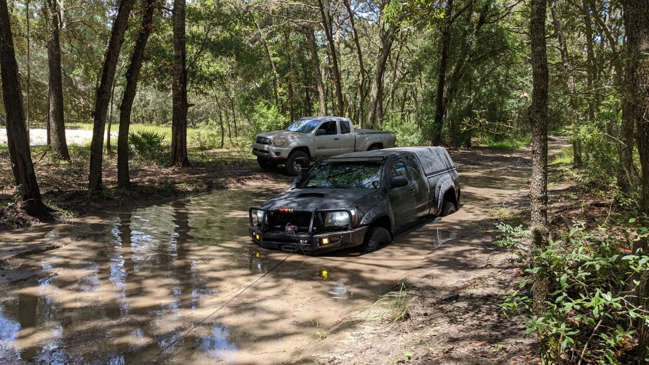

    Mine just keep on going, had to use it last weekend after getting a little too confident through puddles.

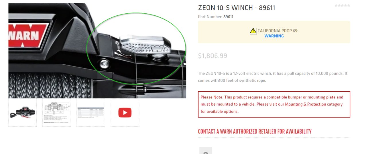

    Pic below is what he is talking about. If this lever is not fully in the locked position, the winch will not spool. Think of it as N and Drive/Reverse on your transmission. You have a N position so the spool is decoupled from the winch so you can manually drag the line where you want it. You then manually put it in Drive/Reverse via the lever when you want to engage the winch. That lever is how you put the winch in and out of gear (so to speak).

    it sounds like his winch doesn’t have a lever at all. It’s wireless without a lever if I’m not mistaken.
    if it works periodically, it might just be dirty solenoid contacts. Does it feel like the winch draws power when you engage it? I would also try changing remote batteries if you haven’t done so already. If you get a chance, can you post pictures?
