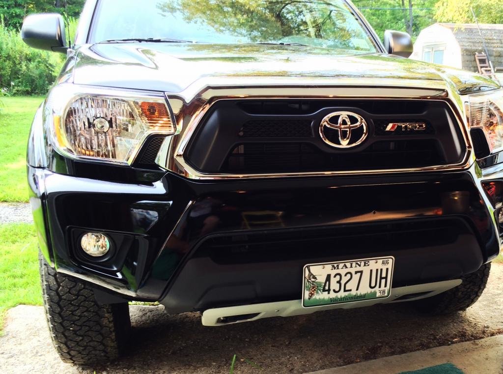

    Today I fabricated a no holes license plate bracket of my own design. At least I think it is as I have not seen this design any where else but it is difficult to check every old thread on this forum to see what everyone else has done.

    Some will ask why not use the stock location for the front plate? For most people the location of the front plate is probably of little concern but for me I did not like the stock location and did not want my front bumper drilled since I did not think it looked all that great. Unfortunately, despite explicit instructions to leave the bumper alone there was a lack of communication and the dealer drilled the bumper anyways. I received a bed extender for free for their mistake but now I will have to come up with a solution to fix their mistake. Not sure what that will be quite yet. Also, I just like the looks of the plate lower and not blocking part of the air flow to the radiator.
    Here is my solution. I have the OEM front skid plate and looking at the mounting point of the skid plate I noticed that at the location of the two top allen head bolts there was just enough room between the bumper and skid plate for a 1.5 inch wide by 1/8 inch thick flat piece of aluminum to fit.

    And here is what it looks like on the truck.
    48f51884-8363-43d8-b99d-1a4ca4336b15_zps_a2bc9b83f9d15c88df6c737e9694f74368bf9d94.jpg

    And a few final thoughts. The bracket is remarkably sturdy for only using three pieces of flat stock aluminum. I had originally planned to use a few more supports or cross braces to make the bracket more rigid but in the process of test fitting the current design it was obvious that no additional support was needed. The final product tilted forward just slightly, causing the bottom of the license plate to rattle when it was tapped. I did not want to listen to that noise every time I went over a bump so I placed a few self-adhesive pads to the back of the plate between the plate and vertical support. These eliminated the noise and made the plate almost completely vertical.
    I used another two pads on the back of the vertical support between the support and the plastic bumper piece, on the off chance that someone or something pushed the plate backwards I would avoid metal to plastic contact and damage to the plastic bumper. Unfortunately it was too dark to get good pictures of these pads tonight. I will take a few pictures and post them to show where they were placed and what they look like.
    Overall I am very pleased with how the no holes plate bracket looks and works. I had considered painting it black or polishing it up but you cannot see the bracket unless you look for it so why bother. Incidentally, all the hardware is stainless as well so no worries about rust.
    Thanks for checking the project out.
