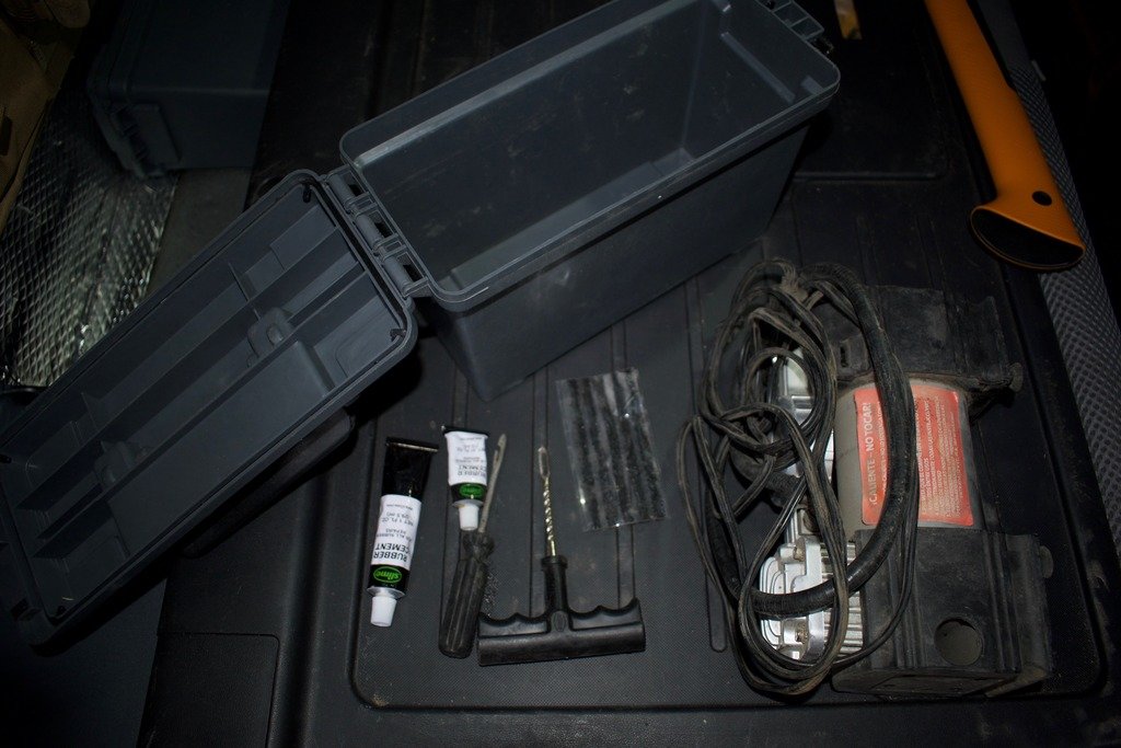

    Harbor freight sells little plastic ammo boxes for 4.99$ on sale that are amazing little storage containers for the price, and I found as luck would have it we can fit 5 of them on the floor of the rear storage area. They fit like a glove with a little trimming of the plastic paneling that goes around the rear Left and right seat belts (can not see trimmed area with seats up)

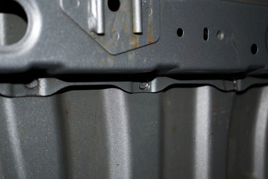

    I wanted as much room as possible, so I also removed the Child seat safety retainer bar going across the rear of the cab. There was about 20 or so spot welds that needed to be drilled out. This is done VERY carefully as the sheet metal is the only thing between the elements and inside of your cab. I basically just scored around the spot weld with a ~5$ spot weld drill bit from harbor freight and then popped them off one at a time.

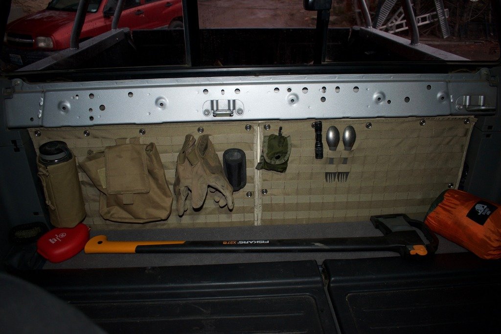

    Once that was removed I covered the entire area in sound proofing material, I then got a sheet of 1/2 plywood and attached it to the rear of the cab, Then attached the molle paneling to that.
    Used an extra piece of the 1/2 plywood to make a "cover" for the storage boxes.
    This setup turned out to be way better than I expected. TONS of room for stuff back there and I can keep it all very organized.
    It also has the added benefit of making a level surface back there for my dogs.
    Total Cost ~100$
    Molle panel ~30$, Plywood ~15$, Carpet material to cover plywood for bin cover ~10$, Bins 25$, 80 mil 10 sq feet sound deadener 22$ amazon, stainless hardware for molle panel ~5$ Links to products used at bottom of post
    Bin 1: Flat repair kit (12v air compressor, patches, rubber cement and patching tools)

    On the molle as of now: First Aid kit (not in pictures), compass, flashlights, gloves, keys to rotopax mounts, accessories and hardware for RTT, Glow sticks, mosquito reppellant, sunscreen, Titanium sporks, hydroflask, cpr mask, fire extinguisher.
    On floor over storage bins I usually cary my guns, axes, camping hammock / grill etc...

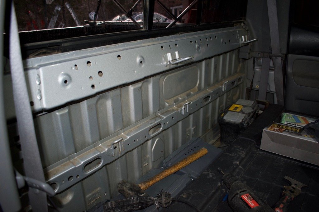

    Before:
    Spot weld removal
    After:
    Picture of the bins under the cover
    Picture showing one of the bins and contents:

    The Molle panel is cut in half, and mounted appropriately. Ended up being a perfect fit for the space.

    I wonder if removing the cross bar compromises the structural integrity of the cab?

    I was thinking the same thing and actually started a thread asking that exact question, My belief as well as others is that part of the cab is "corrugated" for structural rigidity, as it is in many other trucks.
    Many trucks do not have that bar across it and simply have the "corrugated" stamped steel in the rear....From all of the research I could do, I found that it is almost certainly just there for a tie down point for "car seats" for babies.

    I tac welded some nuts to the rear of the cab and used bolts through plywood, in retrospect, heavy duty velcro would have been more than sufficient. The weight of the stuff that is on the molle is more vertical than lateral if that makes sense.

    The corrugated back wall is for added structural integrity- but is not enough on its own bc of the thin/ light metal used. The bar that was removed would add to the cabs side impact resistance as well as helping to prevent things from coming through the back of the cab. I worked at a body shop and we repaired an F-150 that did an emergency stop (without hitting anything) and the (properly strapped) load he was carrying came through the back of the cab and pinned him into the steering wheel (could have used one of those bars!).
    It will hopefully not be tested in a side impact- or with a shifting load. But there is that very slight chance that you could be taking away a small percentage of your trucks safety. Although the plywood has to add something!
