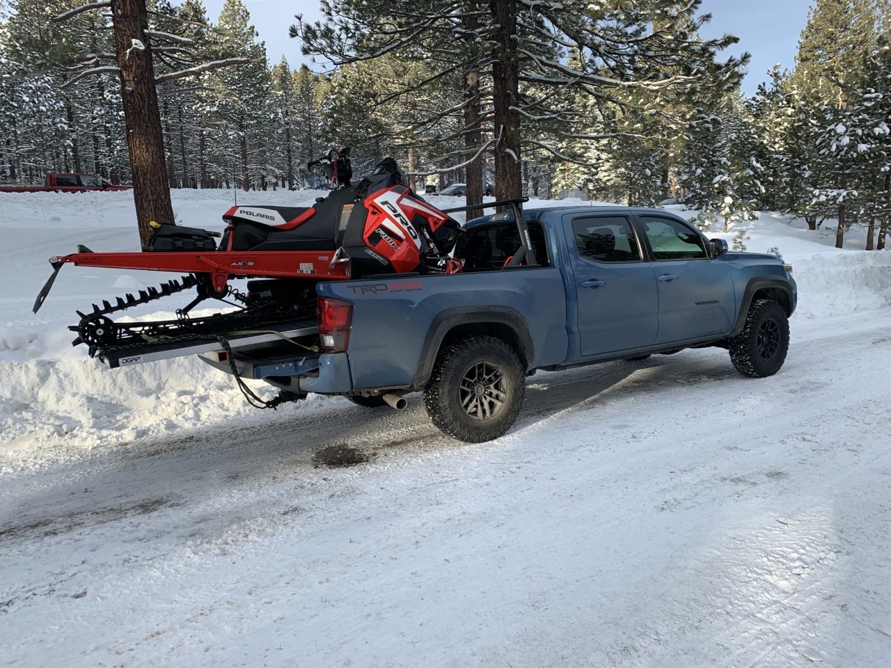

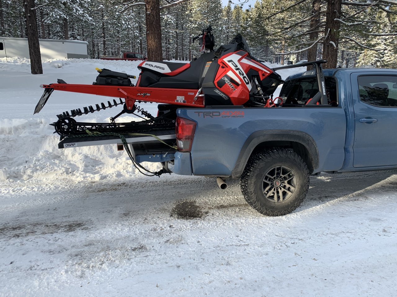

    when moving to the tacoma, the sled was the biggest concern. my approach was to bolt in aluminum tubes using the bed bolts. they cantilever over the tailgate so no loading on that weak point. working with dgrp ramps he made a slightly narrower ramp than his standard to fit between the wheel wells. these are cantilever style ramps where you drive the sled up onto the ramp park it, and it's balanced so you can pick up the ramp from rear with sled on it and push it in on rollers riding on my tubes.
    need a sled with a narrow ski stance for this set up, alternatively taller tubes / box structure and the full width ramp
    works well with less risk to truck bed and cab from driving sled into the bed

    it is a 19 RMK with the narrow stance plus the skis moved all the way in on the spindles ( a bit too narrow imho). with the tubes, ramp, and sloping wheel wells it fits with some space to move the skis out a little

    also, the ramp was built at 44" wide vs the standard 48.
    the sled is a 155 tunnel / 163 track. I went long bed to get as much weight as possible in front of or near the rear axle.

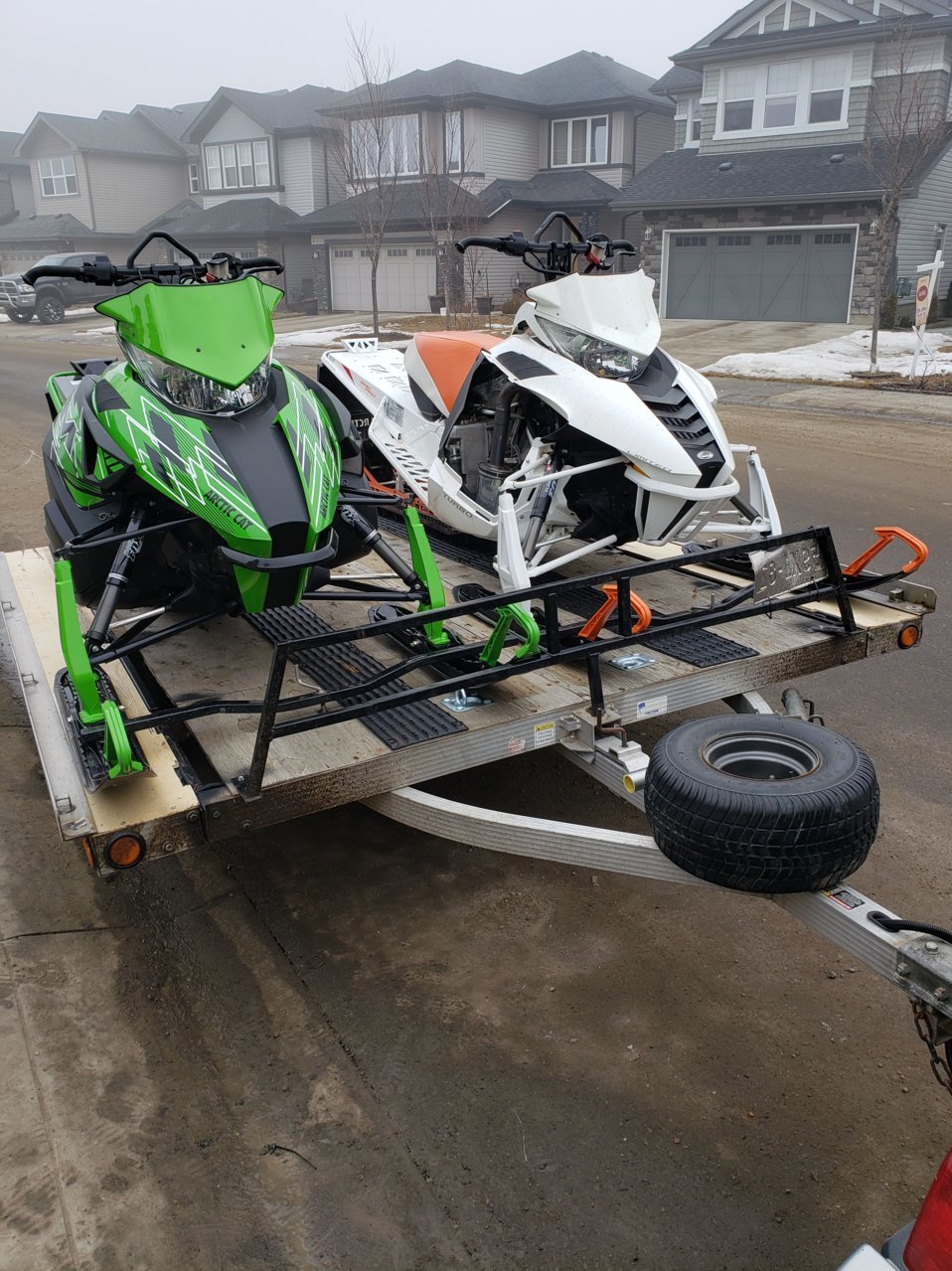

    I opted to modify my trailer - makes it bit more versatile. You can see where the outside ski is resting ( the clean plywood ) are actual 'wings' that fold in and convert it from a double into a single.
    There is a pic of it behind the FJ in the single config with the wings folded in - kinda hard to see.
    This year going to redo the deck and add receivers (3 places) at the front for a manual/electric winch to haul up dead machines.

    I reached out to DGRP Ramps via email. He was super responsive. At the time there was no added cost and he just needed a little time to build it with his next run.
    after 3 seasons it still works amazing. I tweaked my rail design a little by cutting them at the tail gate adding a slip in connection for the bed rails and added a brace that slides into the hitch receiver. Super bomber and puts some of that overhanging load into the hitch. This way rails stay in for season and the extension goes in for sled transport.
