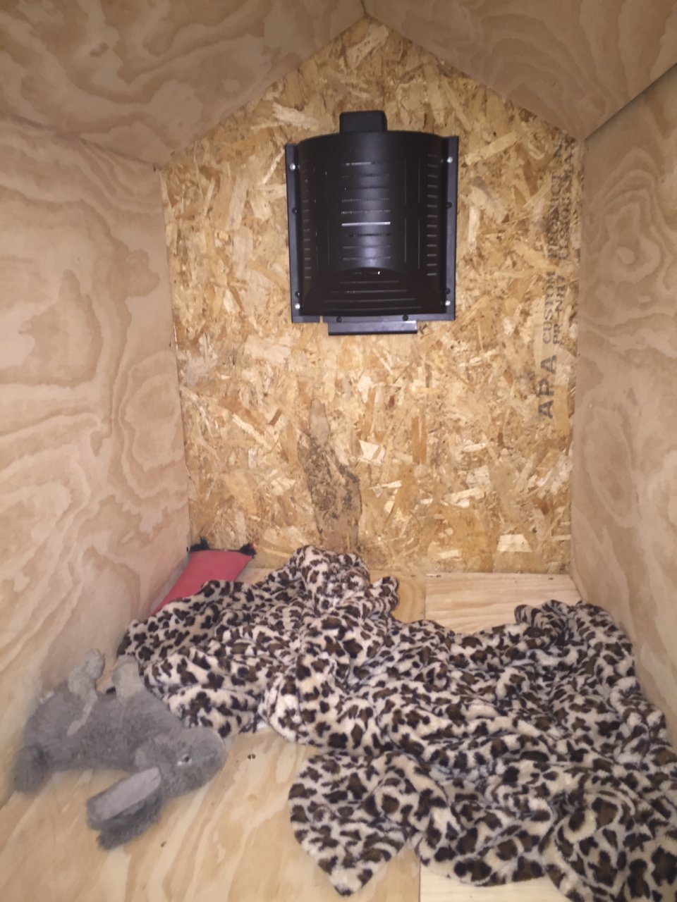

    I left the back wall alone so I could add something I found online called the "Hound Heater". It has a thermostat, never gets hot enough to start a fire or burn a dog, but works great to heat up the dog house.

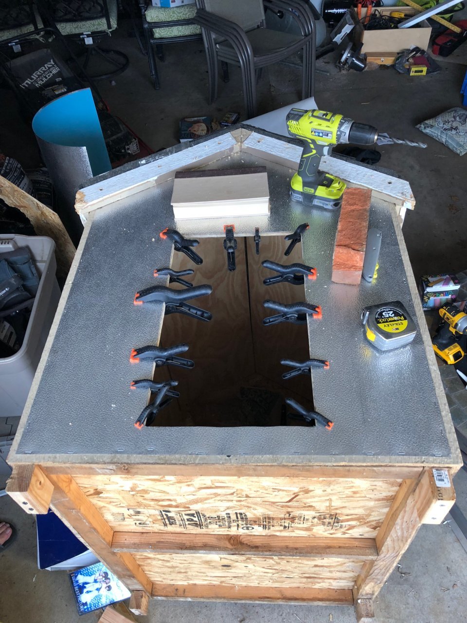

    I acquired some aluminum sheet metal to wrap the house with, and found some aluminum angle iron at the local recycling place for $0.70 a foot. I had to replace the entire front wall of the house before I started the metal work so I cut a smaller door to keep the heat in better and trimmed it out with aluminum U channel to keep the chewer at bay. I used liquid nails and staples to attach the sheet metal.
    I cut the angle iron to fit on all of the exposed corners and screwed it on. I think it turned out pretty nice and it is holding up great. All in I've spent around $200 and a couple cases of beer.
