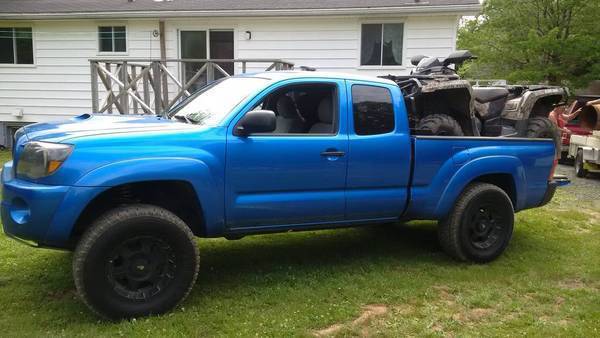

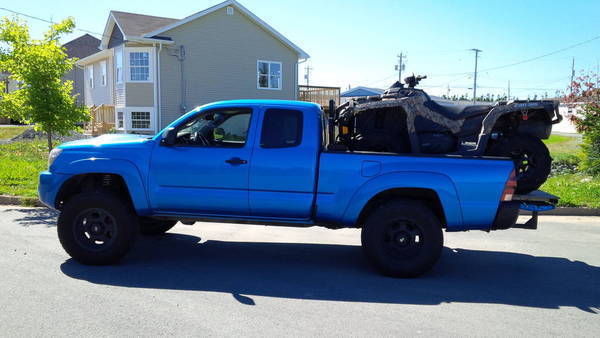

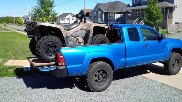

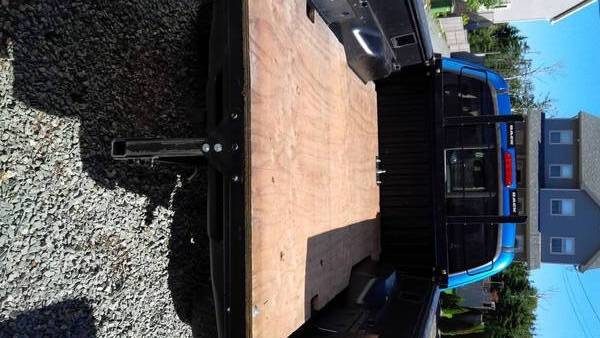

    Got super bored the other day and though of an idea to fit my massive 2013 Outlander Max XT in the bed of my tacoma without putting the weight on the tailgate. Made some brackets and bought some 2x2 square tube to fit in the tailgate. Used a 3/4" piece of plywood and cut it out to match the bed mat. Took a large bolt with a bottom plate to even out the pull underneath the bed and bolted it in the middle drain hole. Made top and bottom plates on the plywood for the large bolt to go through and hold in place. Heres a few pics

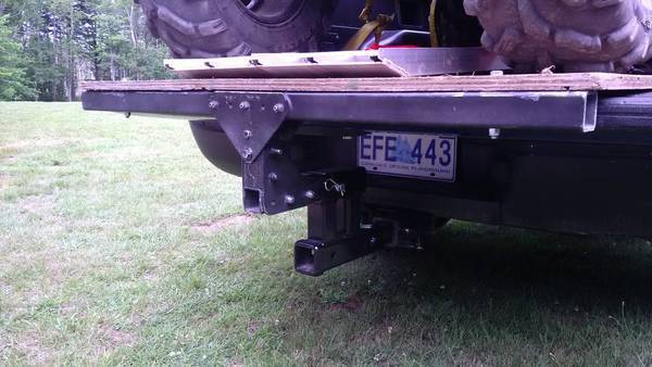

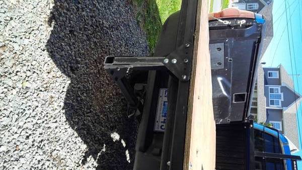

    How it sits today with the new bracket for adding another hitch
    [​IMG][/url]
    Few questions for anyone. Will this be too mucch weight on the hitch? The bike is about 780lbs and im 180 so 960 when Im driving it up. Not ALL on the hitch but a lot. I figure its more safe then the tailgate. That thing would probably bend in half

    It's only half the weight of you + the wheeler at any given time because the other half of your ramp is on the ground, and I think the max tongue weight on class IV is 500 lbs? so I think you should be good. At least the hitch would be good, I don't know about that hitch extender thing.

    The hitch can handle the weight, even with the extra leverage 15" away from the hitch.

    Thats what I was thinking, but when I loaded her up it seemed a lot more weight then I first though. Worked fine though. Now Im trying to figure a way to be able to take the think off once the bike is loaded so I can use the hitch to tow the camper too :D

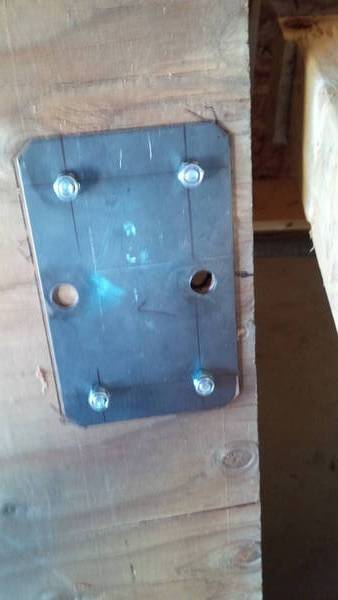

    Here's a pic of the plates bolted to both sides of the plywood to hold it on the large bolt in the bed

    Don't mean to rain on your parade or critize your work, but is only my opinion that your setup would be more ideal for a permanent fix to your issue and not something to remove and put on often. If I needed something similar and still be able to use my hitch, I would have bolted a 1/4" steel plate the size of the tailgate, and beefier steel cable to handle the load of the wheeler. Rig some brackets to where the cables that hold the tailgate distribute some of the weight to the 1/4" plate so not all of the weight rests on the original tailgate brackets.:thumbsup:

    Well it takes less the 5 mins to put on and off. I thought about the tailgate thing but I find it twists the bed too much and you can see it tilting backwards. That's why I wanted the hitch involved
