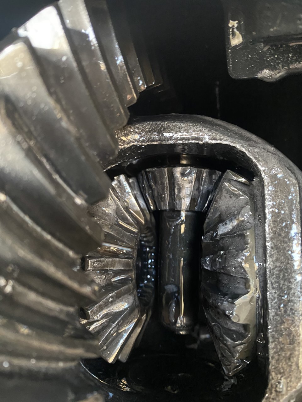

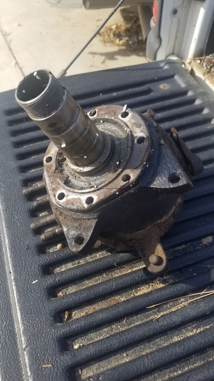

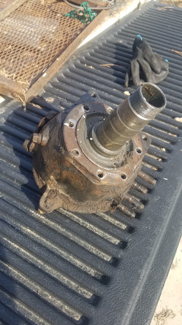

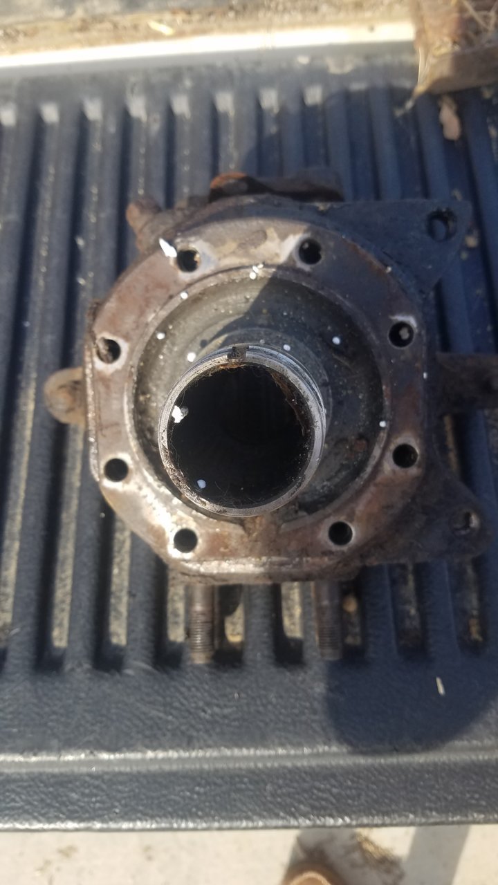

    I wanted to do a little write up on the wagoneer dana 44 that many guys like myself have/are planning on swapping into their rigs based on the last 8 months of my experience to hopefully lead you in the right direction.
    To begin my trucks a 2001 Toyota Tacoma, 3.4 double cab, passenger drop Dana 44, ruf leaf springs on 37x 12.5. 4.10 gears. R1fa transfer case. It’s my daily driver and I wheel the thing hard.
    After these breakages I installed these parts and seem to be having better luck:
    -Dana spice u-joints with full circlips
    -Yukon chromo long and stub shafts
    -Yukon chromo spool
    -Moog grease-able ball joints
    I’ve had 3 major breakages on the trail, all high wheel speed and deep snow.
    1. The first was my spider gears exploding (see pictures) due to being unlocked and high wheel speed. If you’re going to swap this axle into your truck do not run with open gears in the front, lock it straight away, whether that’s a spool, mechanical or selectable is up to you. The spider gears are a weak point in these axles, they heat up and start welding themselves to the housing. So just be aware of that.
    2. I had a lower ball joint fail while going fast in the snow and catching a ditch, cause both the king shaft and the stub shaft to break on the way down. Whether that’s dues to lack of preventative maintenance or bad aftermarket parts from the previous owner is debatable. But if you’re swapping this in just do yourself a Favour and replace all of the ball joints. It’s an expensive and avoidable break.
    3. I had a chromo shaft and stub shaft break due to u-joint failure. I determined the cause of this to be the c-clips that hold the u-joints in place come out. To remedy this Yukon and a few other companies make full circlips for the Dana spicer u-joints (you need aftermarket shafts to run them). I highly recommend doing so.
    After doing those things this axle has been reliable, the reason I went with the Dana 44 is because of the narrow track width ground clearance. That being said if I was to do it all over again I would probably choose a 60 series or 80 series land cruiser axle. We’ll see how reliable it is after these upgrades now.
    Take this for what it is, it’s just my personal experience.85540EF8-9901-45B0-9CF4-C8C0D2EC8ACE.jpg0216435F-A02C-4B4E-BF6D-1BE9DF18BCFD.jpg A3C032FC-1C1A-4F48-8F7C-3B84A3ABEBD9.jpg

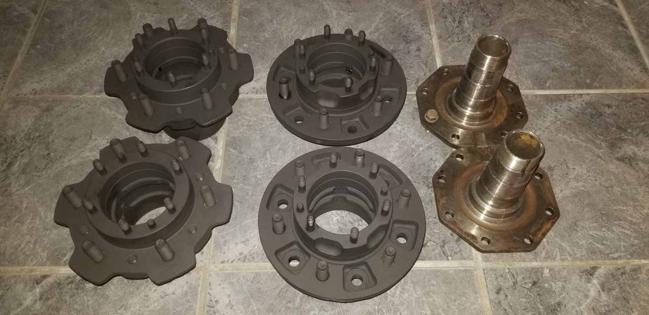

    IFS hub (left) vs 80 hub (right)

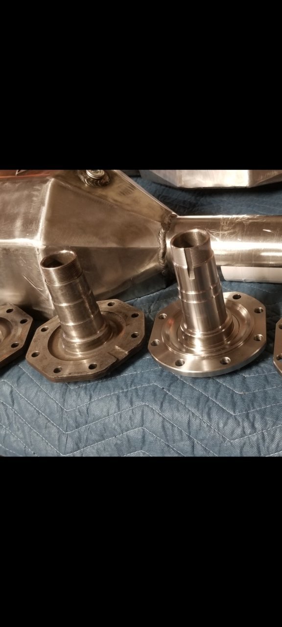

  7. Feb 18, 2021 at 11:49 AM
    Broke Okie Ty
    Broke Okie Ty Well-Known Member
    Aug 27, 2014
    #137043
    1,126
    Ty
    California/Oregon/ Now in Montana
    01 trd with some stuff
    Armor, winch, other stuff
    Sorry that post wasn't a very clear thought lol.
    Rear axle build: 91-92 semi float fj80 rear axle housings is wide enough to center the diff with full float outers to make 63.5" wms (stock). Clean the housing up and weld on spindles and perches. Buy nitro cut to length fj80 full float rear shafts. Bam! Centered rear 9.5 full float axle.
    Front axle build: fj60 9.5 semi float rear axle housing has enough tube to use stock fj80 front axle shafts and knuckles. Then, using a mini truck sfa spindle and ifs hub body, I'm doing the big brake kit with 14wa calipers and gx470 rotors. Then to top it all off, I have sfa locking hubs.
    The ifs hub swap nets about an inch or so in wms over the stock fj80 wms at 63.5" making it 64.5 wms give or take. Hope that clears that up for you.

  8. Feb 18, 2021 at 3:29 PM
    02hilux
    02hilux What do you mean there’s no road, I’m here
    Sep 14, 2016
    #197244
    5,960
    Planet: EARTH
    I'm still confused....
    You won't be able to use 80 knuckles with sfa spindle, the mounting pattern is different. If you're referring to using the 80 knuckle ball with sfa knuckles, I doubt it'll work as the 80 ball are much larger in size.
    I understand the portion of running ifs hub with sfa knuckle to net ~3" extra track width.
    Correct me if I'm wrong...

  9. Feb 18, 2021 at 3:39 PM
    02hilux
    Sep 14, 2016
    #197244
    5,960
    Planet: EARTH
    I recalled mating a sfa spindle to the lc80 knuckles and the mounting bolt are different. Unless you re-drilled the sfa spindle?
  10. Feb 18, 2021 at 6:31 PM
    Broke Okie Ty
    Aug 27, 2014
    #137043
    1,126
    Ty
    I was told that the sfa spindles bolt up, but if they don't like you suggest, then I'll drill them to the pattern and bolt them on anyway.
    The ifs hub swap only nets 3" when replacing a mini truck hub. Ifs vs fj80 it's only around an inch.
    I'll do an axle write up when I get them finished. I'm working on the rear right now and hopefully going to start the front in a few weeks.

    Bolts right up

    I'll be damn... :thumbsup:
    How are you going to incorporate high steer or will you be running slee setup?

    I'm trying to get hellfire's, but if I can't, I'm going to buy a super duty weld on kit. If I swap the knuckles L<>R I can use the brake mounting ears as lateral support for the high steer. Also I'm going to double sheet it with the stock arms.
