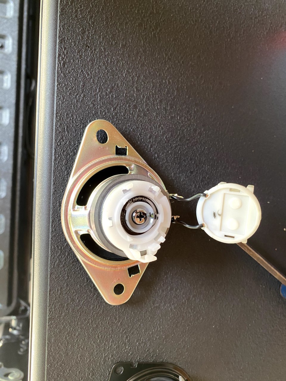

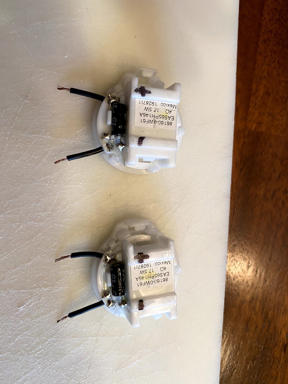

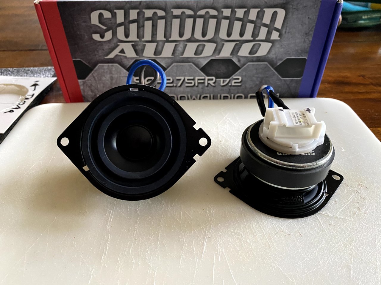

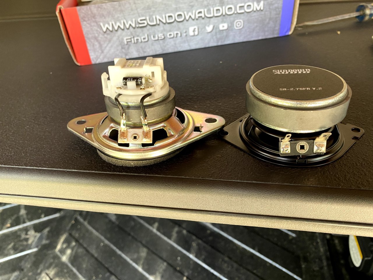

    Full disclosure, I bought sundown speakers for the dash from WoofersEtc, but they were on back order and I got impatient.
    Turns out they were not plug and play. So I thought I would make them plug and play in case I need them or a buddy would want them. I'm no professional and I'm sure others would do better but I was just having fun tinkering. and they work great. I plugged them to make sure. Still need a mod for the holes to line up on the mount.
    Here are the steps it took...
    My stereo system sounds amazing now! What a complete and undeniable difference.

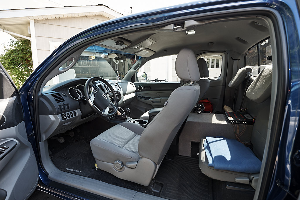

    I had the whole thing re worked in my 2015 access cab.. I'm looking to part off the sub but I can't put a for sale thread up as I am too new of a member. It was a pretty fun build and the results well worth the work

    @Rob . Swapping the crappy stock speakers out is certainly the first order of business.. These speakers have been a joke since I got into the Tacomas in 2009. They are pretty much the same as they were back then. The only real difference I have seen in the JBL "premium" sound system is different color sponge around the drivers.. and what they call a Sub is pretty much a round version of the front speakers.. Truly pathetic. Bang for the buck switching out the factory speakers is a really wise start.
