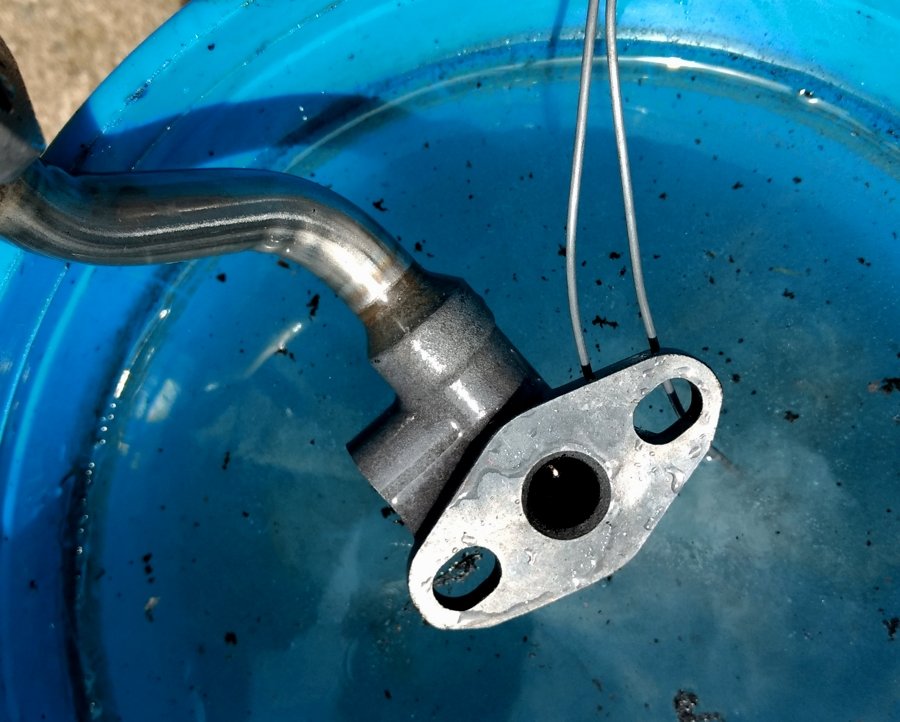

    Rusty part before cleaning. This part of an EGR tube assembly.

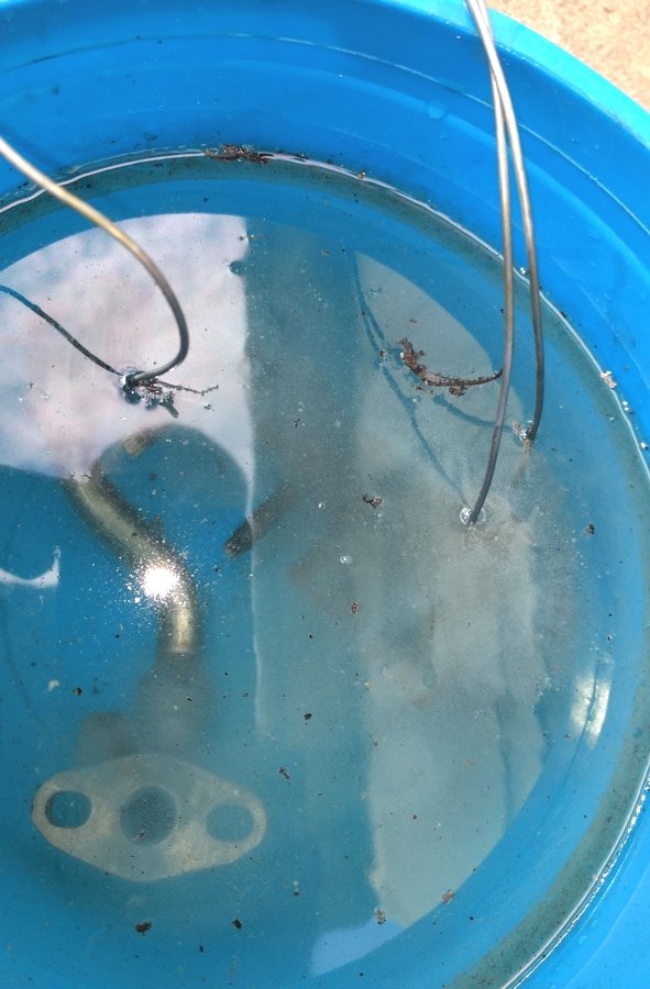

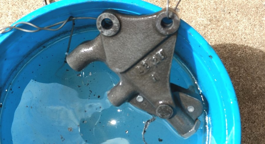

    Dipping the parts in the acid solution. The chemical reaction will start to bubble away the rust like a seltzer tablet in water.
    The acid solution will change color as it removes the rust and cleans the parts.
    Just be patient and let it do its work.

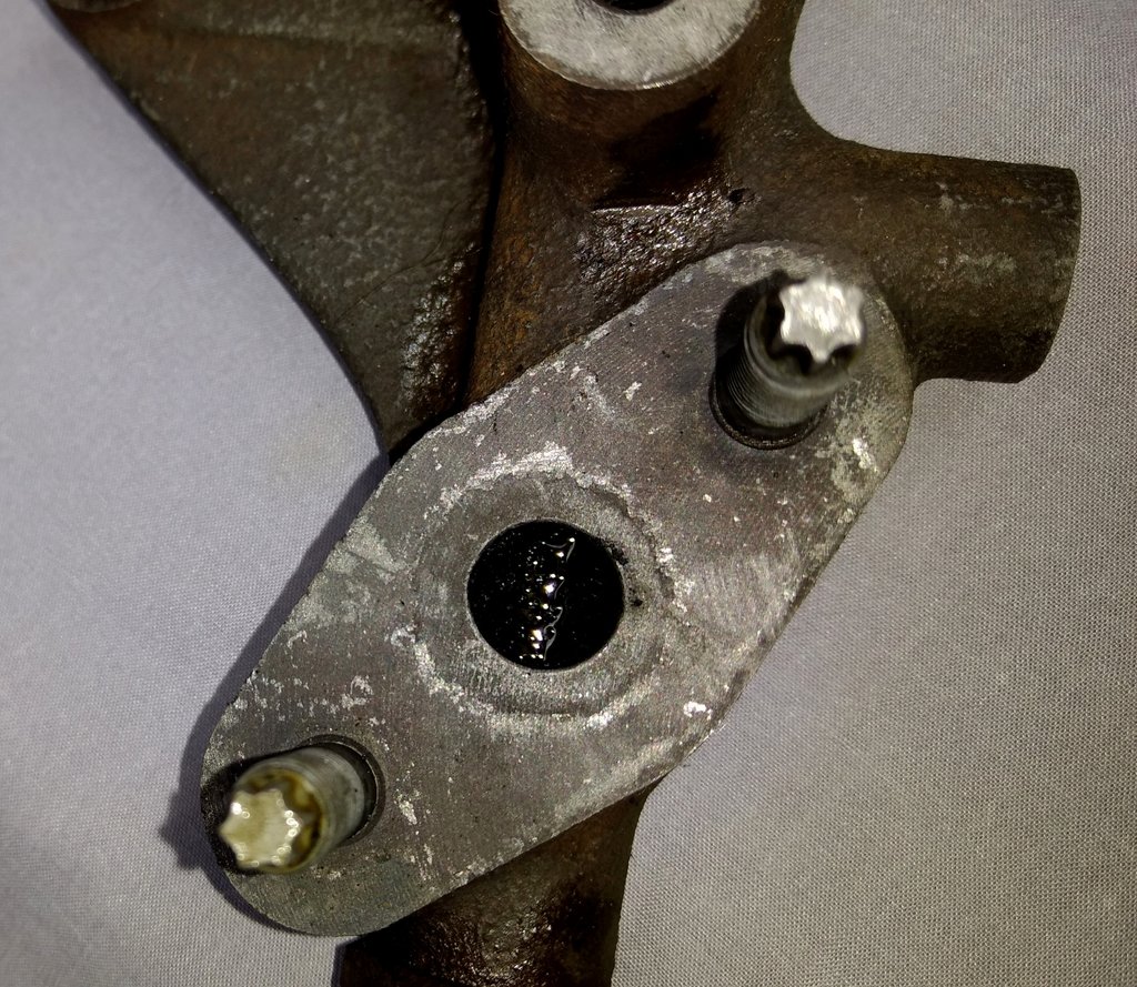

    Newly cleaned parts. Be sure to rinse the newly cleaned parts in water and spray with Fluid Film (or similar) to prevent rust from returning.
