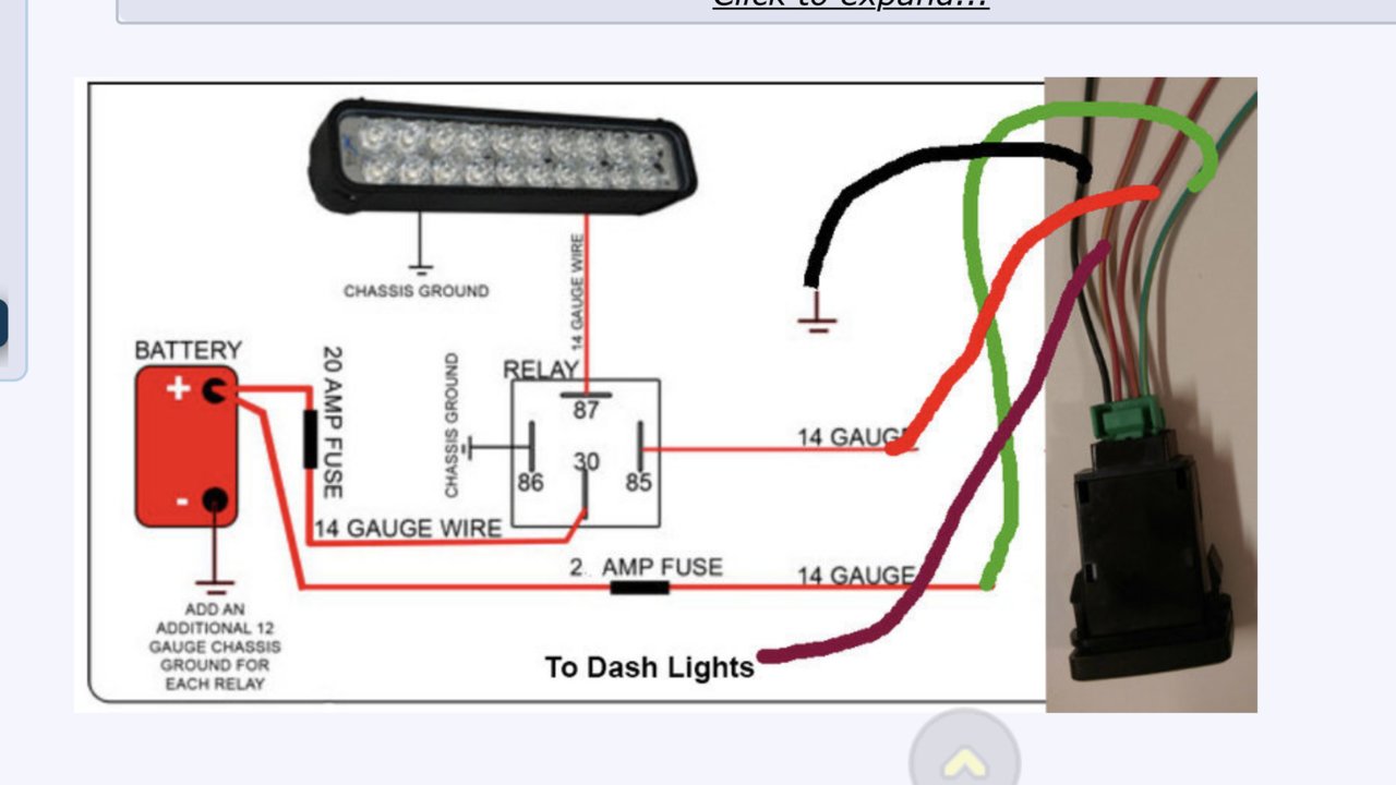

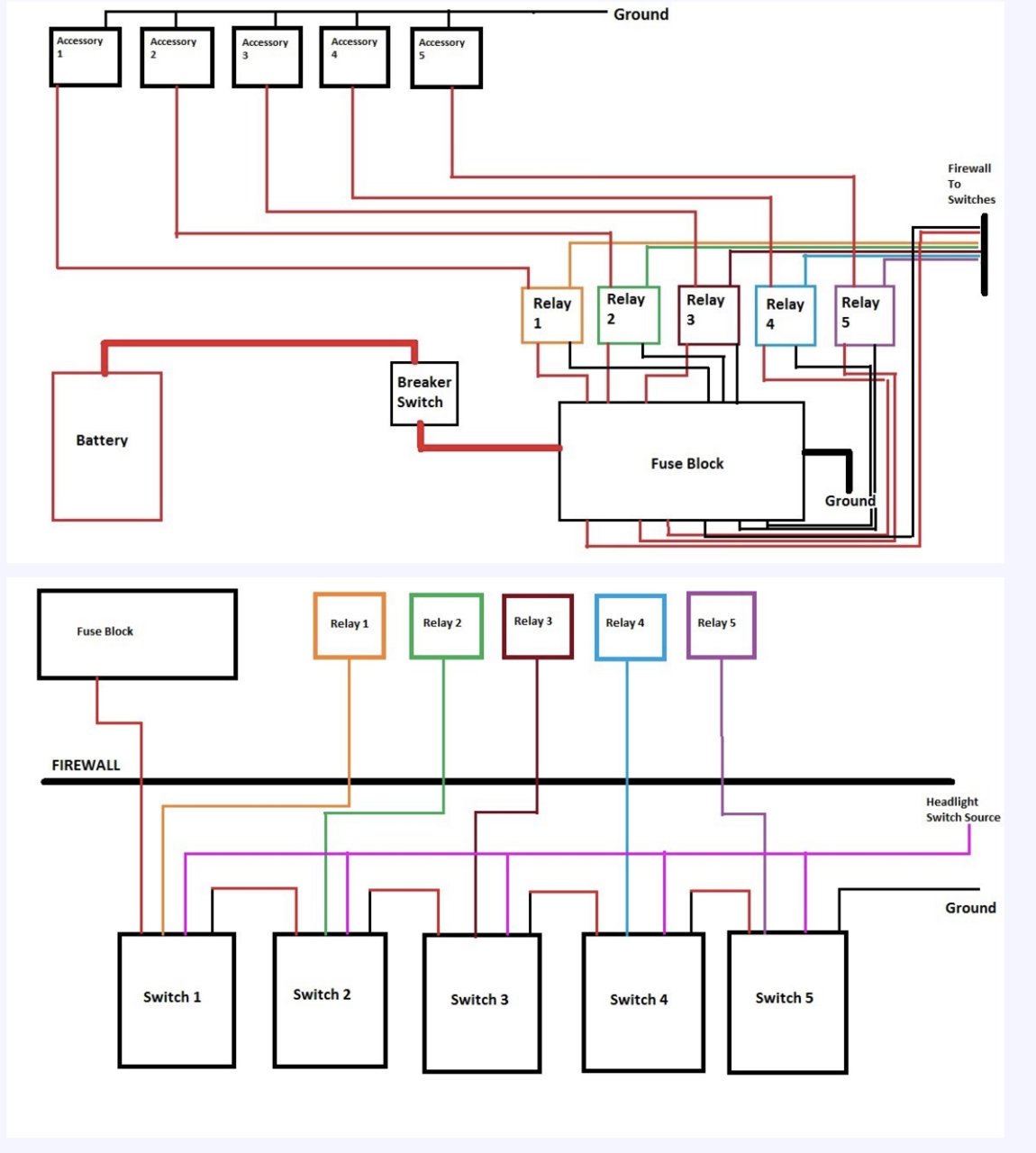

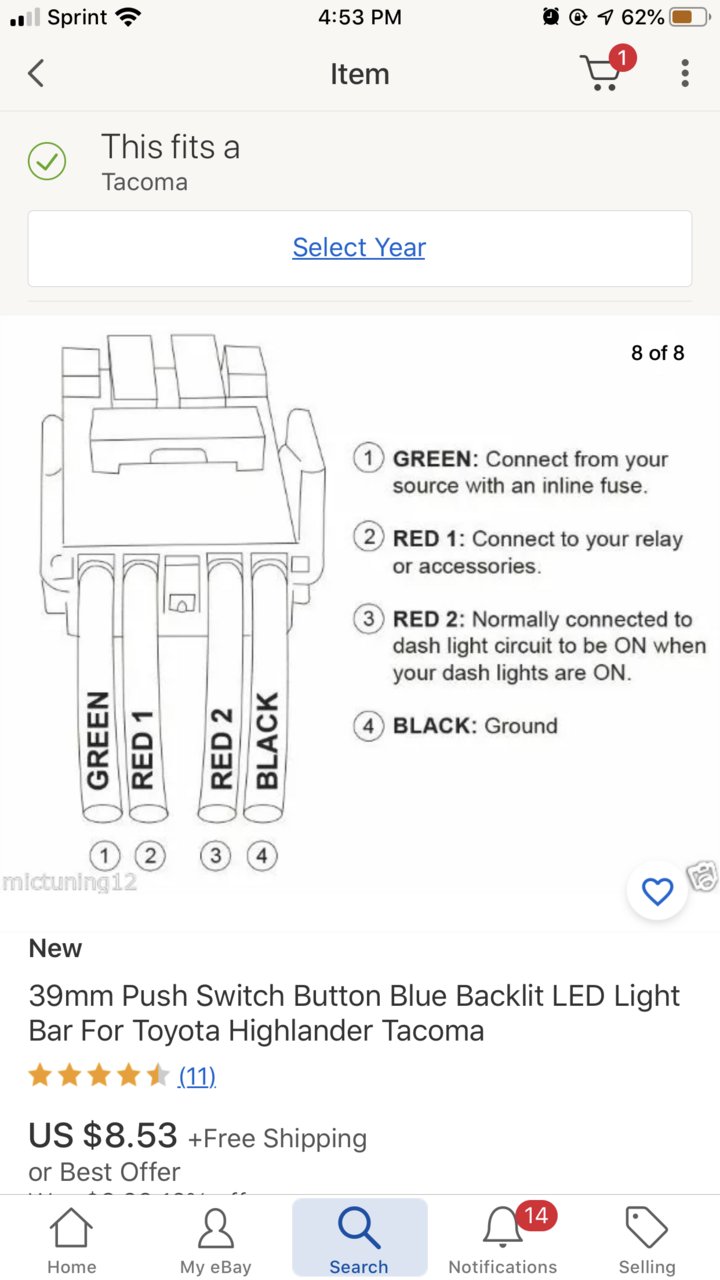

    Mall Crawl Control
    Been doing a bunch of research myself in the technical chat and lighting section of TW. F2711C1D-FF39-4EBD-9A0F-C82D3453D60F.jpg 1D786A0C-2F50-4082-8062-E13DA48FAD72.jpg 3F95DBC2-42E1-45F7-903C-4941747D299B.jpg 73262ABB-7FB0-4549-A356-BAA378465DF8.jpg 62A683CE-1692-41CA-8BA7-1A329C89D8A5.jpg
