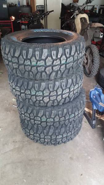

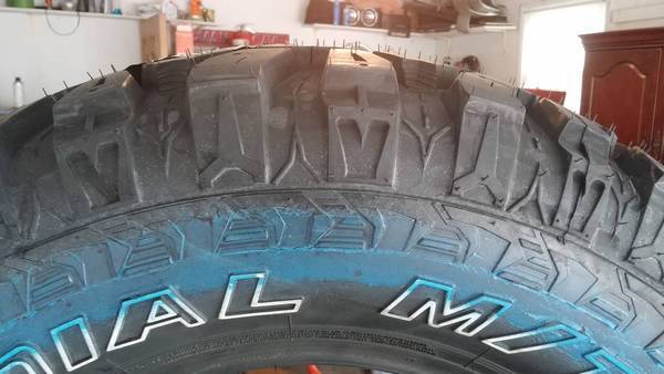

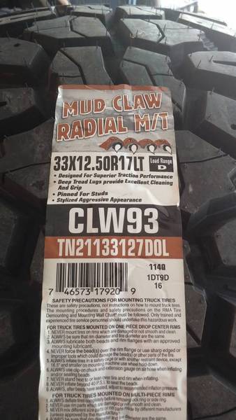

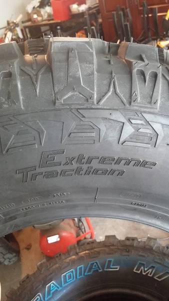

    Just picked up a set of 4 33x12.50r17 mud claw radial mt load range d from a tire shop in town. Paid 1000 out the door for them. . Might have spent too much but time will tell.
    I'm starting this thread as an ongoing review for these tires. I've seen a couple good reviews on them but not a lot of info was real in depth in terms of handling in wet and dry as well as on and off road so hopefully I can be some insight for another buyer.

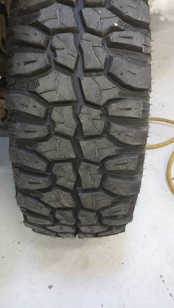

    First impression is wow these are pretty impressive very deep and aggressive tread on them. Tread compound seems pretty durable and sidewall feels sturdy I'm going to mount and balance them soon so I will post again on how they balance

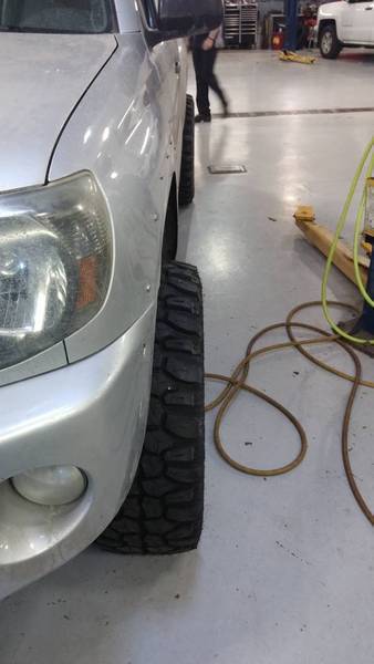

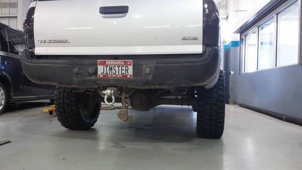

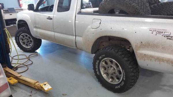

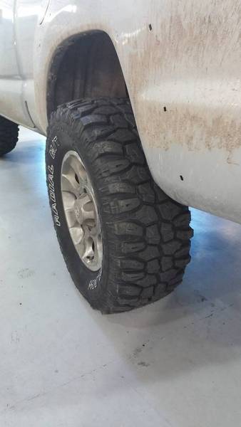

    So I have the tire mounted now and balanced smoothly took approx 5 oz of weight per tire. Not too bad for a 33 inch tire so I'm please with it. Washed all the blue off the side wall and cleaned up the white letters and these things look good. That are mounted on a set of fj cruiser wheels 17x7. The front I had to use 1 inch wheel spacers to clear the uca but I'm fine with that. I do have the cab mount chop done and the pinch weld and fenders cut. Already had all the clearance done for 35s so these fit no problem might be a different story for a stock truck
    So my current mileage on the truck is 190,650 so I will start everything from there
    I'll make a post when I do anything with the truck and check back with any problems I may run into :D
    Edit: tread depth measure 18/32nds on all 4

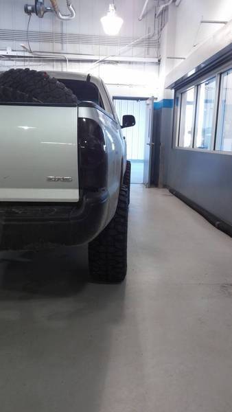

    Where the pics...

    Those are beefy and nice wheels. :cool:

    Lookin good. Lot of offset up front but I like that

    I had to run 1 inch spacers with these wheels to clear the control arms

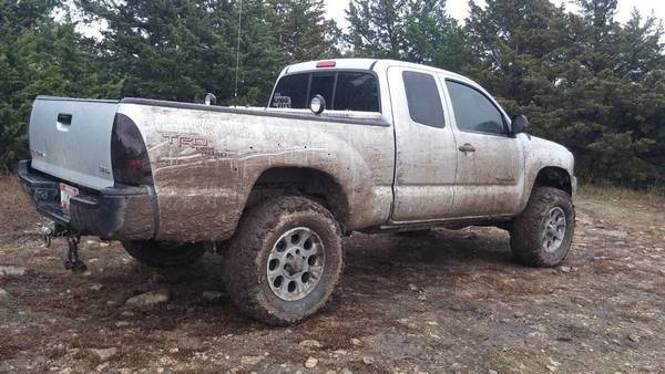

    I had a chance to go to tuttle creek orv in manhatten k this past weekend and holy crap was i in love!!
    I knew these truck were capable but holy crap i still cant believe eveything this truck was able to do
    Anyways back to tires ... Propably one of the biggest reason for making it out alive was these tires
    Aired down to 25 psi and stuck it on 4 and away i went handled the rock like nothing very good grip in the mud, loose rocks, dry packed dirt, sand, clay you name it
    I didnt take many pictures due to i just didnt want to stop but being the only stockish truck there and the only ifs truck that left the parking lot and gettin all the compliments and thumbs up from every solid axle chevy jeep and toyota there felt really great

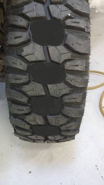

    I know this is a little of track. But for a dedicated trail rig, the pattern of this tire is perfect for shaving a few tread blocks off.
