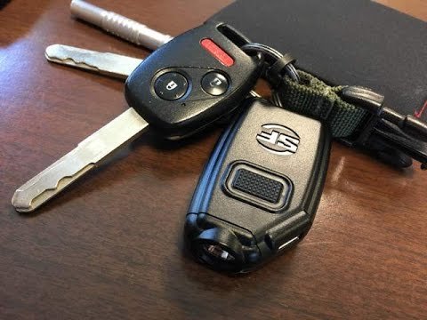

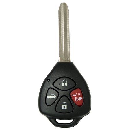

    Ok, so I’m going to throw one more kink in the equation here... For me, my ultimate goal is to have the key fob type that has the buttons on the actual key (I’ll post a pic below) and then I can have room for my Surefire Sidekick (will also post example below).

    I haven't been able to find the all in 1 key pictured that works with Tacos. I have an ebay switchblade key and it works awesome.

    I'm in the same boat as you. I would love a remote start but I don't want to keep an extra fob on my keyring; I also wondered if a Rav-4 key would work.
