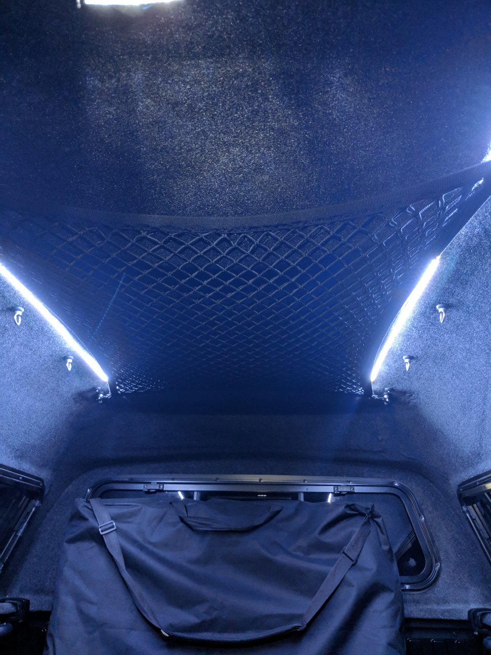

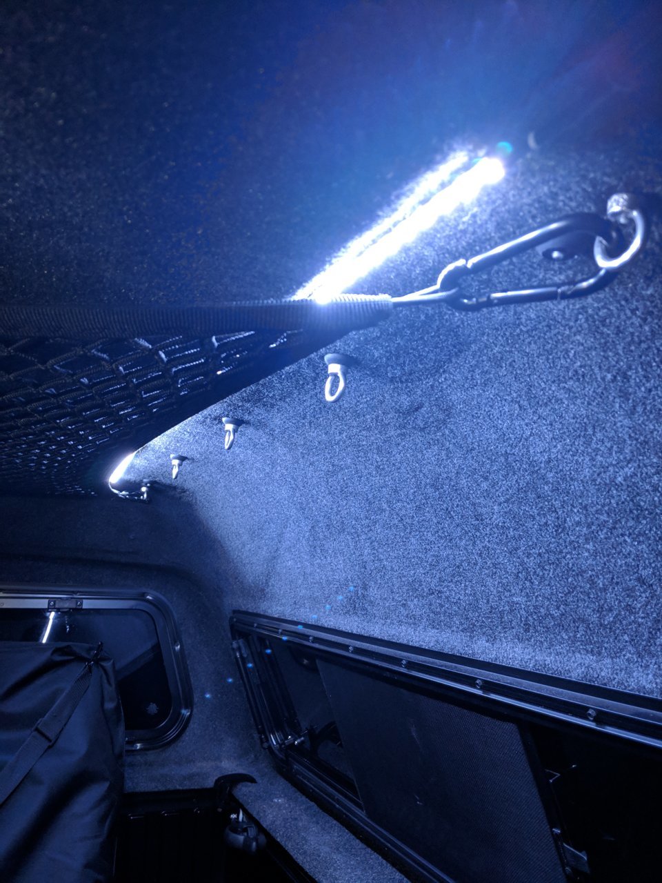

    Finally got the right hardware in and got it all set up today...will attach links below for the stuff I used, all from Amazon.
    Lifting eye nuts...fit PERFECTLY on the ends of the Yakima rack bolts coming through the roof of the shell. Some weren't long enough to fit without removing the stock nut and nut cap, but they're easy to remove and this ring nut will replace it no problem!
    Sydien 10pcs M6 Female Thread 304 Stainless Steel Ring Shape Lifting Eye Nut Silver
    https://www.amazon.com/gp/aw/d/B07GQXT5NM?psc=1&ref=yo_pop_mb_pd_title
    Cargo net...I removed the shitty plastic hooks on the corners and replaced with some nicer steel carabiners linked below!
    $19 Premium Quality Adjustable Elastic Cargo Net Universal Stretchable Truck Net with Hooks,Storage bag for Car, SUV, Truck, Pickup Trucks Black 32x24in
    https://www.amazon.com/gp/aw/d/B0756JPBZF?psc=1&ref=yo_pop_mb_pd_title
    Carabiners...
    $12 Apor Metal Carabiner Key Chain Durable Round Shape Hook Buckle Carabiner Clip for Camping, Fishing, Hiking, Traveling and More Black (4 Pcs Black)
    https://www.amazon.com/gp/aw/d/B07DC429W5?psc=1&ref=yo_pop_mb_pd_title
    This worked out great and I'm super happy with it!!! Can attach more pictures tomorrow if anyone wants them.
