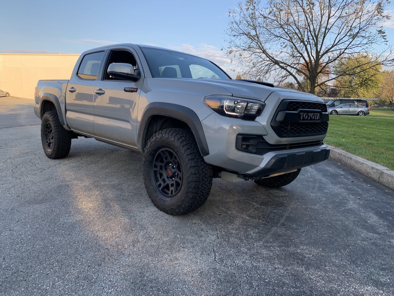

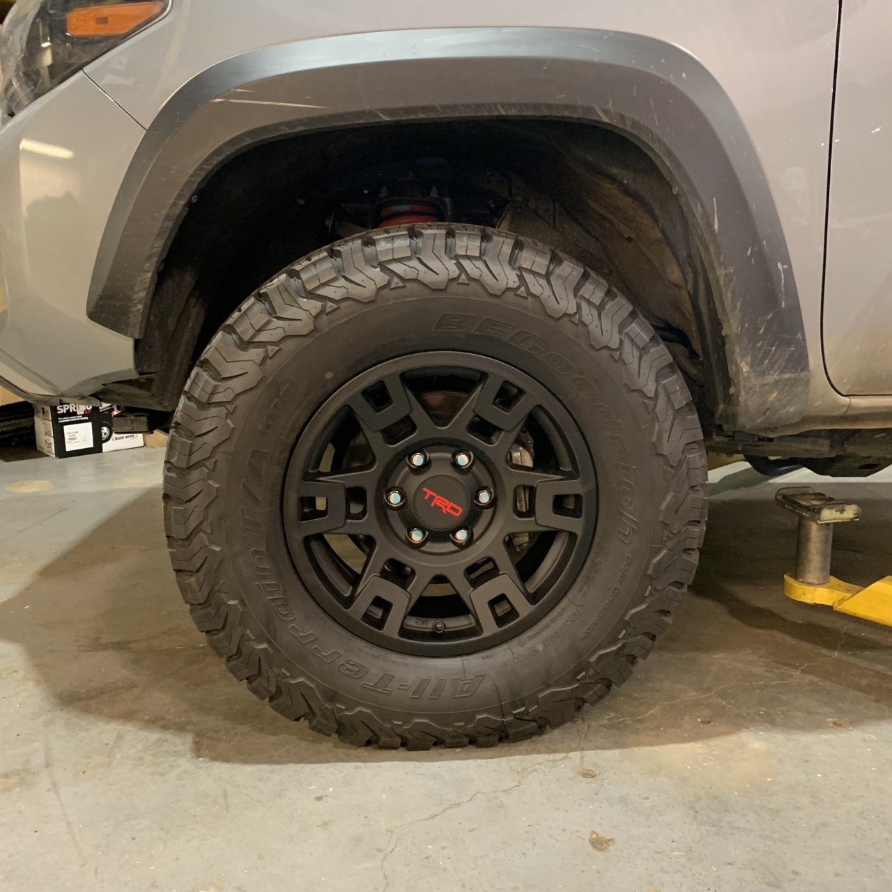

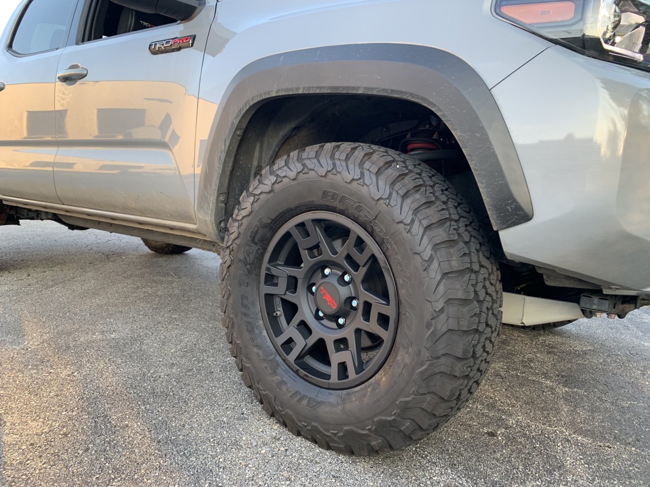

    So I mounted these for fun because there is so much misinformation out there about rubbing/fitment, etc and I had all 3 laying around.
    Wheels: 4Runner Pro wheels in 17x7 ET4
    Tires: 285/70-17 KO2 C rated
    Car: Stock '17 Tacoma TRD Pro
    Alignment: From the factory
    I checked full lock both ways, and loaded the side I mounted the wheel on. It did not rub anywhere. Closest is to the plastic in the wheel well, but the clearance never changed. See below for more pictures.
    Let me know your thoughts. Thinking this is what i'm going to order next week for tires...

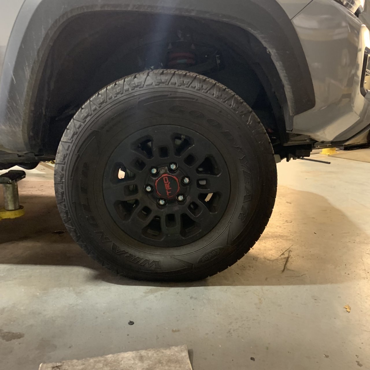

    Stock:
    New:
    Clearances:
