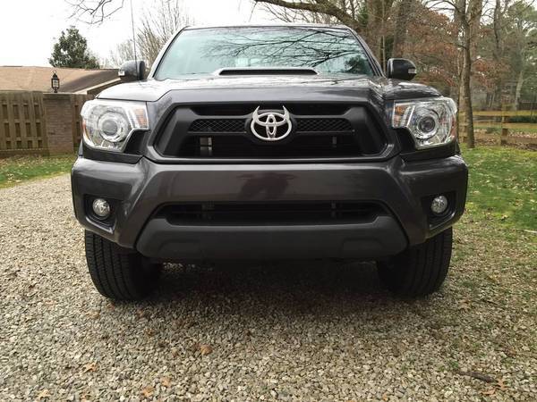

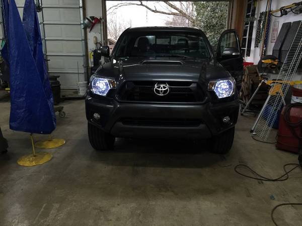

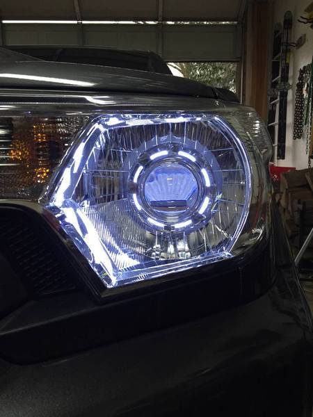

    Finally FINISHED!!!! I'll still tweak the aiming of the headlights a little bit but everything else is done. :) Here are pictures with some descriptions. :)
    Finished with lights off
    Lights on with ignition. I used an add a fuse and exchanged out the IGN fuse in the dash as my "ignition activated 12V power" then ran a wire thru the grommet to the engine bay. Kind of a pain in the ass.
    Uncles of Apollo 3.0 Shroud with the XSB Switchback LED it's 110mm, which is a little bigger than recommended but as you can see, there's no issues.These turn on with ignition.
    The Halos with the "switchback function enabled" for a turn signal. Only problem is when you tap the blinker wire (yellow and blue) you can't use your regular DTRL switch on your steering wheel because it will cause the amber LED lights to be on continuously which TRS says is a no no.
