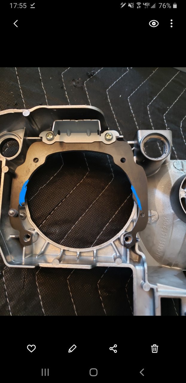

    In the process of installing a d2s 5.0 projector into my blacked out stock 2016 TRD offroad headlights. I can't seem to figure out why the bracket (RQ Hardware kit: Koito RX350 d2S 4.0) doesn't fit? Does the retrofit kit TRS sells come with a bracket just for the d2s 4.0 and is it different than the 5.0 I'm trying to install?
    This part I colored in with blue hits the sides of the projector and it won't let me attach the bracket to the housing.
    The last photo is what I was sent. Is this the correct bracket? PLEASE HELP!

    Did you try asking TRS?
    I’d Dremel it and move on personally... :sawzall:

    When I did my Rx350 swaps I had to dremel quite a bit of material off the stock housings for the high beam solenoid. I wouldn't be scared of making a slight mod to those adapter plated you are using. Considering how much time it takes to remove the permo-seal from the housings, I can understand wanting the projectors to fit perfectly.
    Best of luck :cheers:

    The main reason I went with these is the ease of install (at least I thought it would be)
    Looking at the pictures online of the d2s 5.0 with the brackets mounted on it seems my holes/fasteners are in the wrong spots....

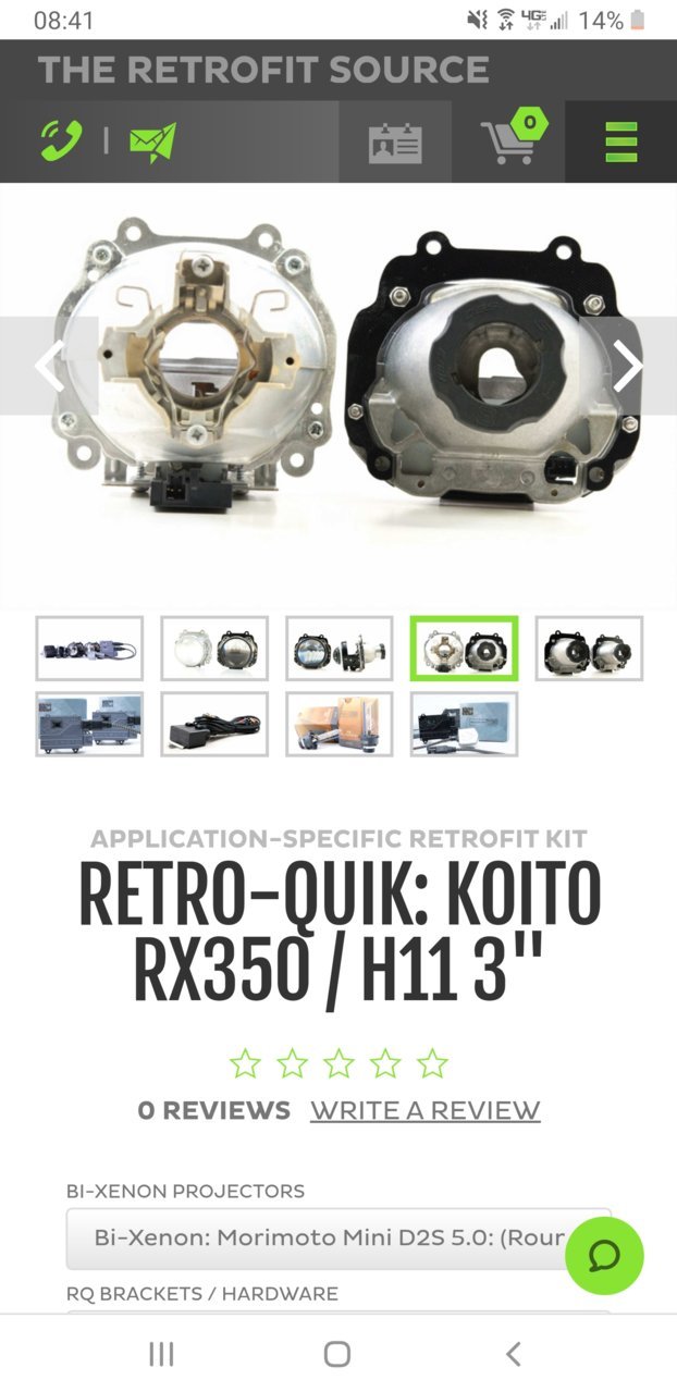

    These are the brackets the The Retrofit Source sent with the retroquik kit for a Tacoma headlight.
    Maybe I'm just overthinking this....

    There is no RetroQuik kit for third gen Tacomas.

    Got a response back from TRS
    "Hello!
    Thank you for reaching out to us. Unfortunately, You would need to drill out the rivet that is not allowing the bolt to pass-through. We are aware of the issue and making-changes. My apologies for the inconvenience."
    Anybody else have this issue with the D2S 5.0s or is this just a bad batch?
