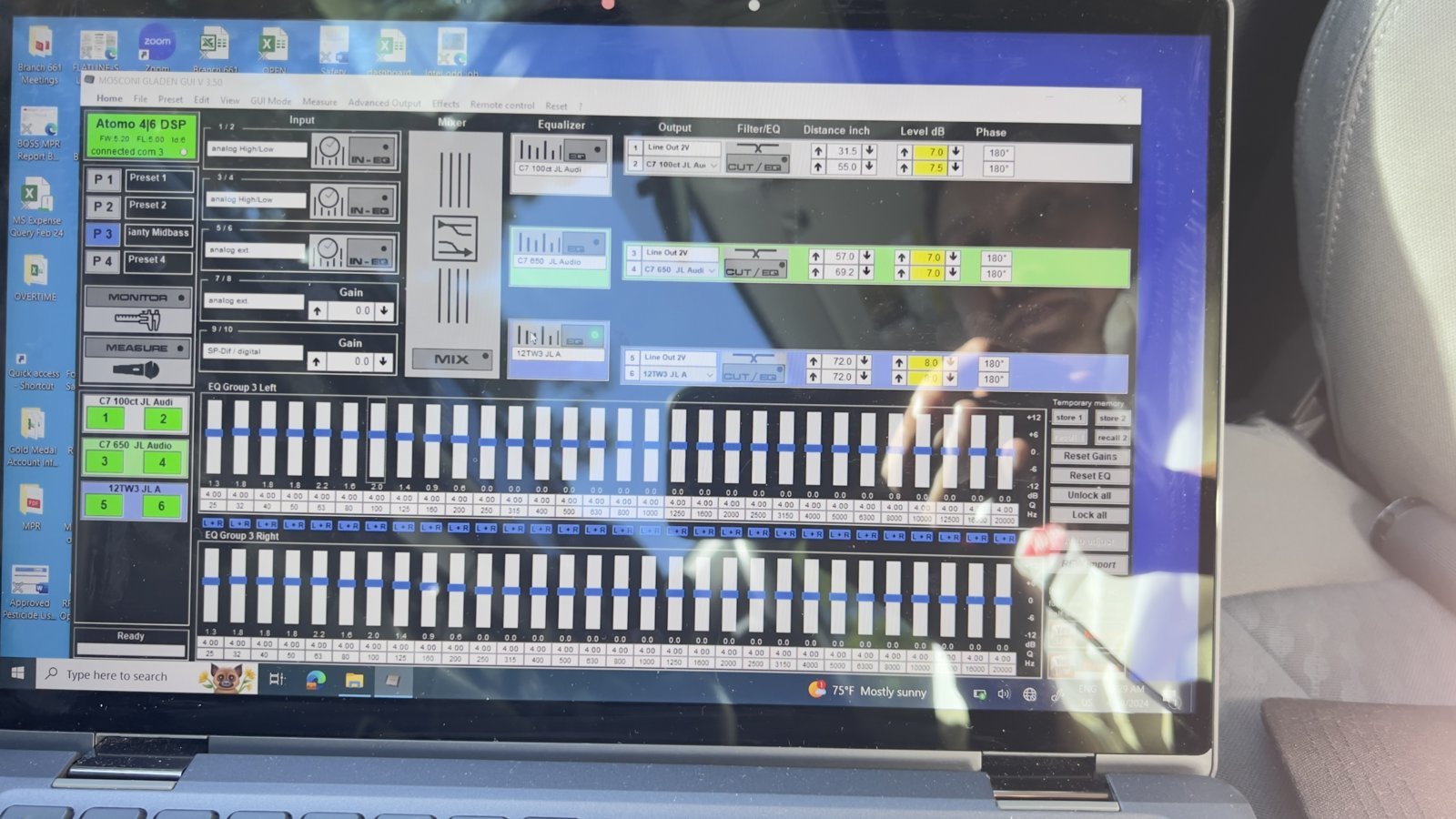

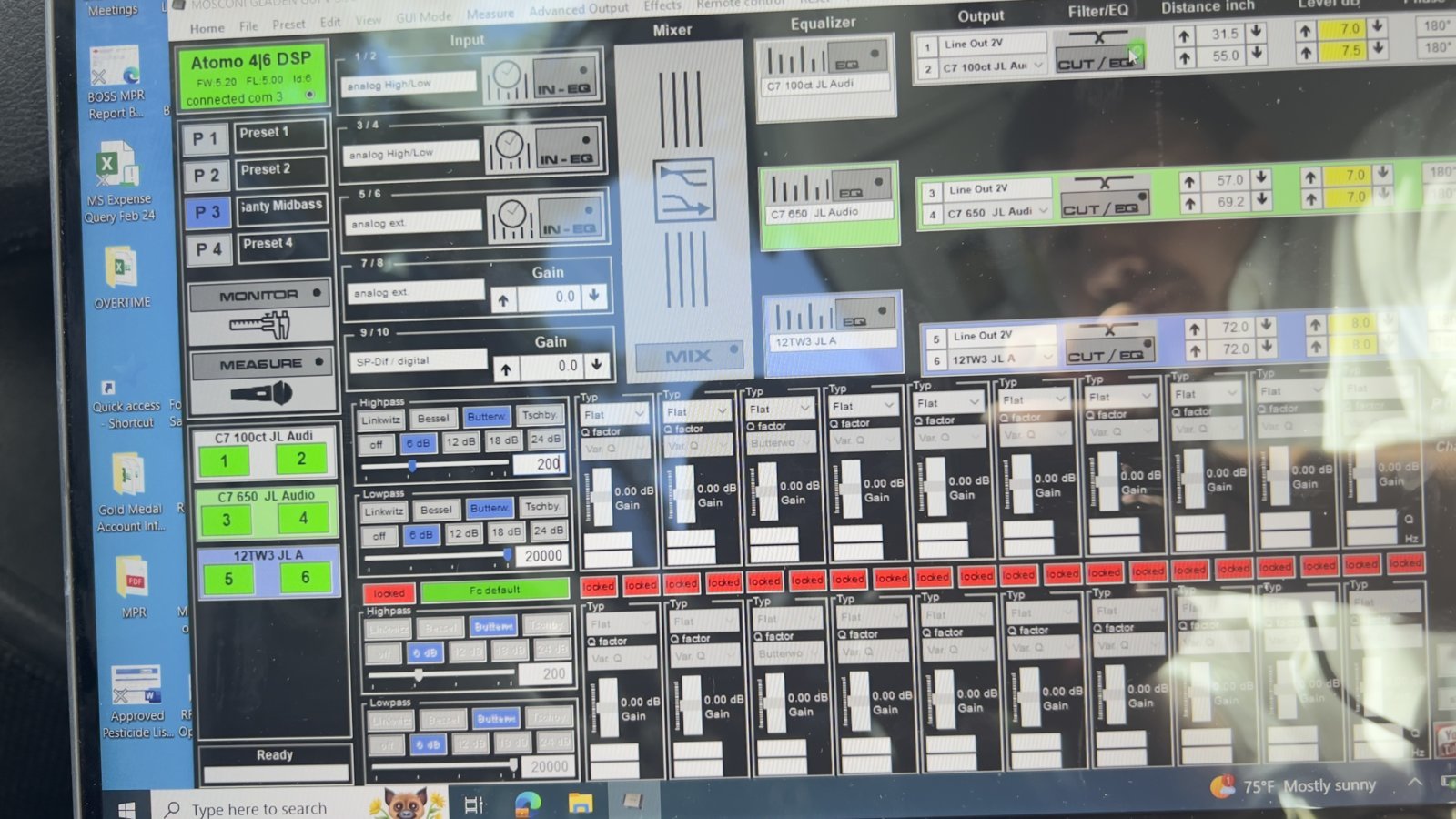

  15. Apr 18, 2024 at 10:16 AM
    Santytacoma
    Santytacoma [OP] Well-Known Member
    Nov 19, 2022
    #411024
    102
    Santy
    2022 Tacoma TRD Sport 4W
    Mainly stock
    Man I tried not sure if followed to the dot but tried to follow your recommendations and ai did get a huge improvement I can feel my speakers breathing sort of speak though. My gains are not as high and was able to handle that high volume distortion here are some pictures of my settings hope they make sense
    I’ll start with the 3.5 inch than the 8 inch in the doors and las my the sub see what you think

  16. Apr 18, 2024 at 10:20 AM
    #16
    Santytacoma
    Nov 19, 2022
    #411024
    102
    Santy
    Mainly stock
    Sorry here they are
  17. Apr 19, 2024 at 8:08 PM
    #17
    soundman98
    soundman98 Well-Known Member
    May 31, 2021
    #367288
    5,682
    NW Indiana
    '18 Taco Sport, '14 Ranger
    i'm not going to comment much on the eq portion, as that's a 'season to taste' thing. i still recommend resetting the eq to flat during setting up the crossovers-- it will allow you to better hear what each speaker is capable of-- adjusting the eq before dialing in the crossovers can sometimes mask issues at louder volumes. otherwise, the way your eq is adjusted looks appropriate, where you've made small, smooth adjustments instead of large drastic adjustments.
    i downloaded the mosconi application you're using, fortunately, it allows for offline adjustments, which allows me to tinker and understand what you're dealing with! it's very early in this post for me to know all the in's and outs just yet(but i will!), but if i can, i'll try to build a setup to match to what you have, and hopefully you can import it as a baseline template to play with.
    something i find interesting is that all your speakers are set to 180 degrees out of phase--all speakers should be set to 0 degree's, though some subwoofer setups require phase adjustment to properly blend, depending on reflections. also, your distance measurements don't appear accurate, given that the default is 31.5", and i doubt the left-side 3.5" driver is exactly that ;)
    this should be the 3.5". right now you have the high pass at 200hz, with a 6db/oct crossover-- because this is the high frequency driver, i would really suggest disabling the low-pass on this. there's no reason to limit this speaker to playing only up to 20,000hz.
    i find it interesting here that one driver has an adjusted measurement, but it also has a bump in output level as well, that would indicate to me that the measurement might not be correct. the measured distance should delay each speaker so the sound arrives at you at the same time, but that should also mean the output level is very similar as well.
    as far as adjusting the output level on the dsp, there's different individual idea's behind it. some people believe it's best to always do as much adjustment as possible on the amp itself to minimize noise. others believe it can be beneficial to spread the overall gain across the different devices so that the amp isn't doing all of the heavy lifting, which can help reduce noise in the amplifiers output.
    take either with a grain of salt-- some setups have different noise, i've done both. some amps are happier handling everything themselves, others start adding hissing noise to the output, and using the dsp output adjustment is more beneficial.
    the main adjustments i've made in the file for the 3.5" are:
    distance:all at default 31.5"
    level: matched your previous at 7.0db and 7.5db
    phase: 0 degrees
    high pass: 200hz, butterworth @6 db/oct
    low pass: off
    i believe these should be the 8" door woofers. they appear to be setup as i was indicating. you can play with using a 6db/oct or 12db/oct crossover, sometimes it makes a difference, sometimes it doesn't.
    adjustments i've made here are:
    distance: default 31.5"
    phase: 0 degrees
    high pass: 40hz, butterworth, 12db/oct
    low pass: 800hz, butterworth, 12db/oct
    with this being the sub, it looks like i lost you a little here. the way you have it set up, the sub will only start playing above 40hz, but up to 110hz.
    i'm changing this so the sub will start playing at 25hz, and stop at 100hz. 100hz is a very generic baseline--every setup is different. the concept here is to set it so that the bass seems like it coming from in front of you. if it blends properly with the front speakers, it will seem like everything comes from the front speakers. this is going to be a combination of frequency(typically somewhere between 60-120hz), and phase(0 or 180). sometimes one or the other, sometimes both. there's no definite rule to this.
    i'm also making an adjustment in the 'mix' tab for output channels 5/6. i'm setting both channels to take an equal input from inputs 1&2. while many amps combine the signals, i prefer to do it at the dsp level specifically so i know they're being combined properly. this ensures that any bass in either the left or right channels will always go to the subwoofer. but it also allows you to only need to run 1 rca cable to the sub amp portion.
    changes:
    mix: 100% input from channels 1&2 to both outputs 5&6
    level: matched at 8.0
