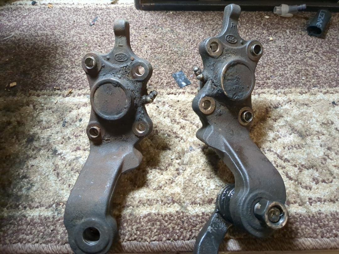

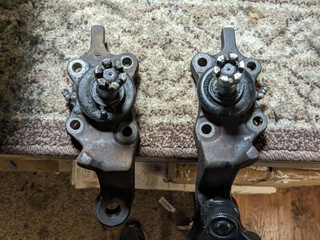

    Posting for anyone considering different brands of lower ball joints and are wondering about life expectancy. Replaced the Moog lower ball joints that I installed in 2013. The set were stamped 555 and have Moog part number K90258/K90259, grease fittings, purchased from ebay. They were installed with re-used black bolts and the rubber dust boots. Best I can estimate these have approximately 90k miles on them. A little bit of play using the jack front wheels and wiggle with crow bar method. Nothing I thought was excessive. But after removing the ball joints they do have noticeable stiction and play and feel rough/grindy. It was time. These were greased probably not as often as I should have done, once every year or two maybe. Mostly hwy and in town driving with occasional weekend warrior dirt trails/fire roads while camping. I pull a small 17' hybrid camper trailer a couple times each summer and live in a CA mountain pass at 4000' elevation where there is rain a few inches to a few feet of snowfall each year. Not a recommendation, or a discredit to Moog, just some info for anyone looking into different options. FYI - for their replacement I decided to go with Toyota ball joints and new black bolts bought from a dealership, along with Toyota inner/outer tie rod ends and JBA UCA's to go with the full OME lift. Truck is very enjoyable to drive again.

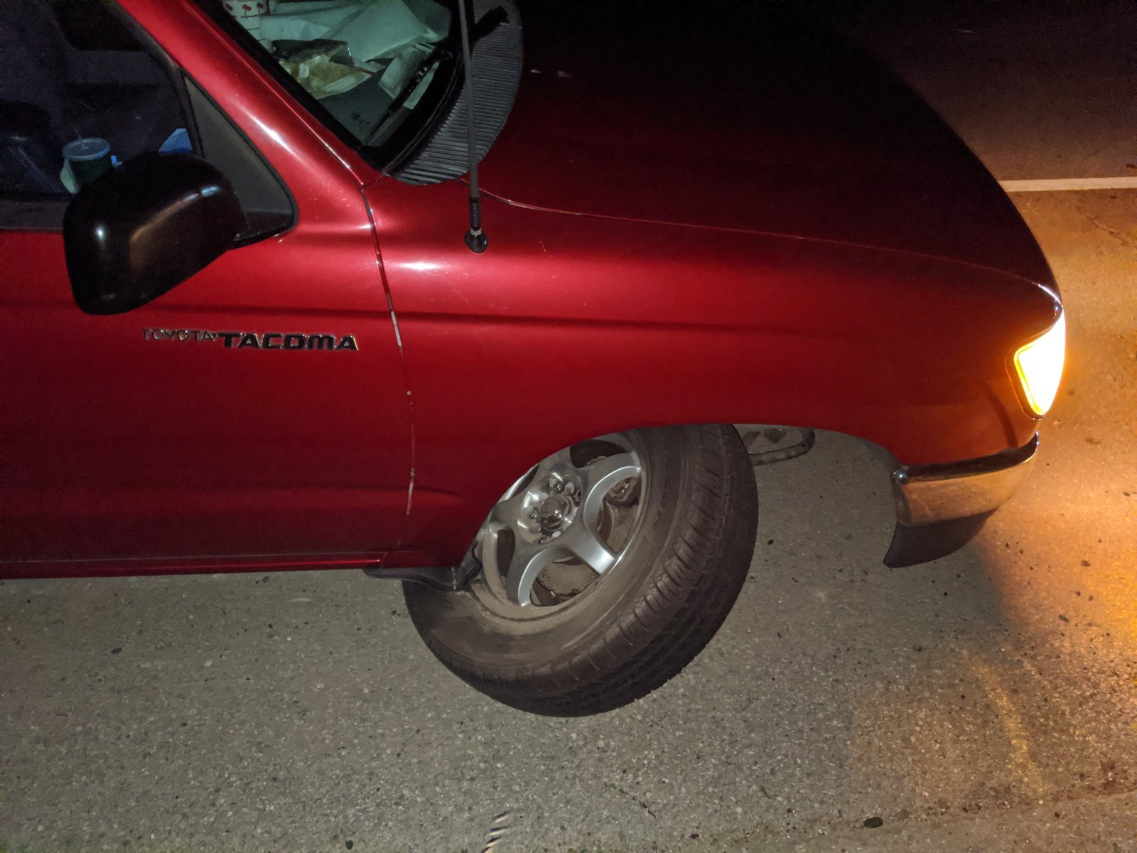

    This happened to me at 65 mph at 90k after I hit a bump. There was no other warning. I was incredibly lucky the wheel wedged itself under the frame, otherwise I might have flipped. Instead, I skied my way over to the shoulder. This was how I learned about the ball joint issue with our trucks. Go get yours replaced yesterday.
    Edit: as others have said, essentially any play is too much. Toyota specs indicate that 0.02" is considered worn out and should be replaced.
