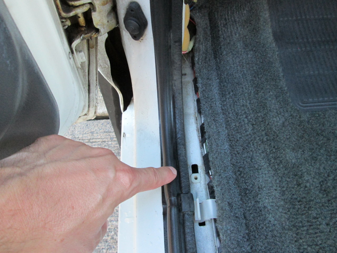

    We just had a heavy downpour for the past 2 hours and I just went outside and found water in the groove where my finger is pointing to and it (water) went over right on to the metal

    How is the fit of your door? We just discussed striker adjustment in another thread a day or two ago. Maybe you need to snug up the fit of the door to the body by adjusting your striker inboard a bit to pull the door tighter when closed.

    Not sure. When it rains, I have always noticed that the outer side of the weatherstripping (as shown in pics above) always has water under the lip
    The drip weatherstrip piece near the roof possibly?

    My Taco guy showed up and the weatherstripping is shot both sides. I did not want to spend the cash, but no choice. I just placed an OEM order ($400 shipped) for the following:
    62311-04010 Door Weather-Strip $131.74 (2) $263.48
    62381-04030 Drip Weather-Strip $71.82 (1) $71.82
    62382-04030 Drip Weather-Strip $71.82 (1) $71.82

    is that rubber still soft and 'squishy' or turning brittle and cracked?
    yes i notice too after giving it a good wash and wiping down the door jams there seems to be a pool of water under the lip there, (but nothing in the groove channel)
    always thought it was normal :notsure:
    my doors still close like new with the nice sound (never been screwed with)

    It's not brittle or cracked, but looks and feels very worn being 25 years old. Same with the drip strip. Those are flattened in a few places also. When I close my door and/or driving it feels like the window is cracked open or the door is not closed all the way (hear noise)
