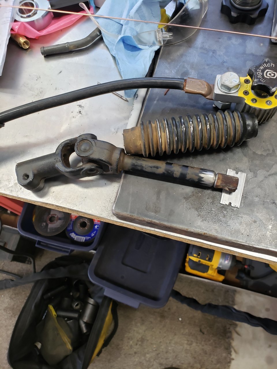

    Then modify your steering shaft...
    I ended up cutting it flush at the yoke...then drilled the yoke out to fit a new rod piece in because I cut it a smidge too short and then double pass tig welded the spline section back on...but removing the big collapsible section makes it clear the frame without having to clearance the frame
    Slashaar, mav, mcharfauros and 2 others like this.

    How much did you have to cut off the steering shaft
    mcharfauros likes this.

    Overall I think it ended up being like 1.5-2" shorter...exactly how much depends on where the rack is..the upper shaft section telescopes soo you have some wiggle room.
    Like I said, this isnt 100% bolt on...and requires a lil brain power and fabrication...but the end result...is a steering system that works 100 times better especially with larger tires 37s
