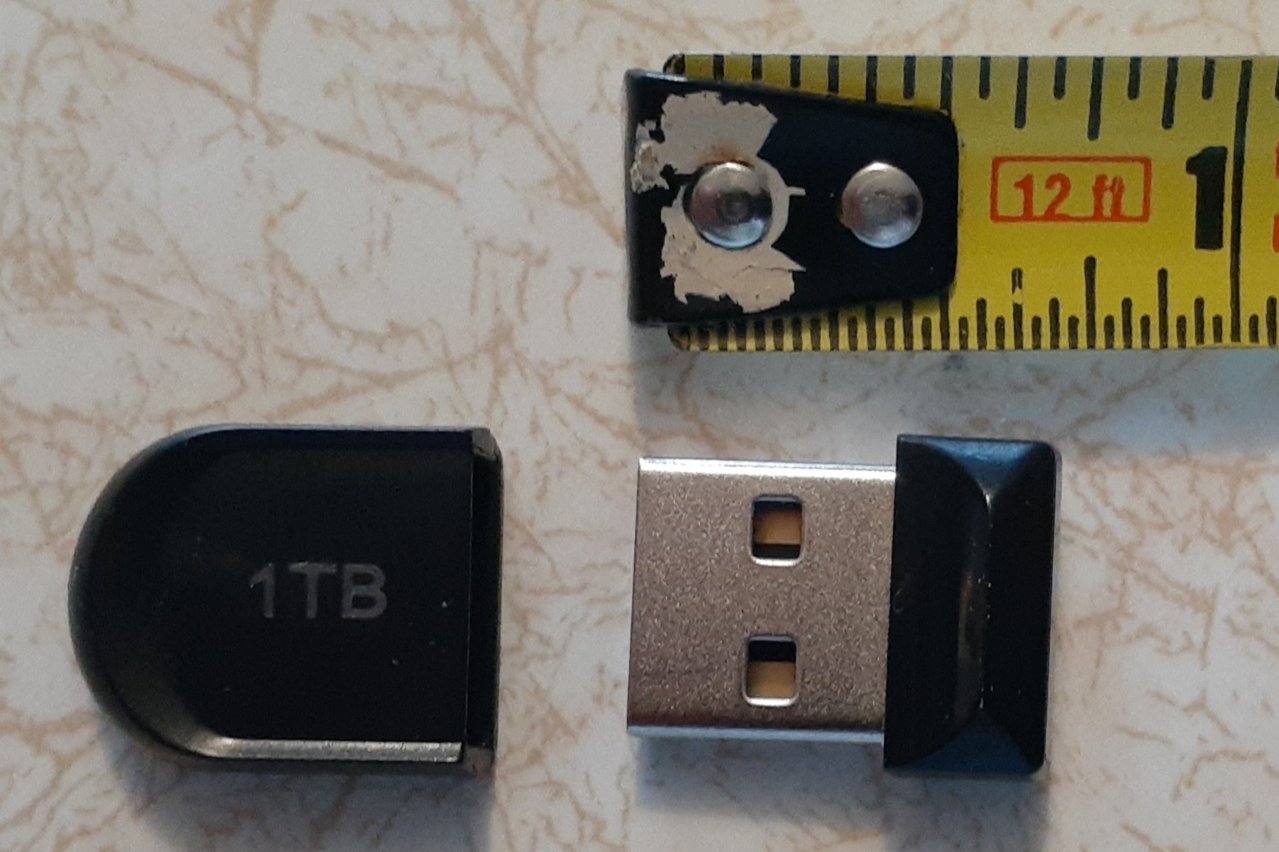

    (2nd Gen) Any one been able to use mini-USB drives to play music? I don't mean drives longer than 1 inch, I'm referring to the 3'4" long drives, see pic. My cars (Toy and GM) say "incompatible" no matter if the drive is formatted NTFS or FAT. I'm currently using one of the longer drives but my Garmin bumps into it at certain angles :)

    Being an IT guy, this could be the size of the drive, whatever operating system radio runs on is only program to accept so big of the USB device connected to it
    just for a test if you had a one gig or a 4 Gig Flash Dr. see if that shows incompatible

    I second this. A terabyte is probably too large for the infotainment OS to handle.

    has nothing to do with the physical size of the drive, the radio has no clue as to the physical size of the drive thats plugged in.
    What is the problem is the storage capacity, like stated that 1TB drive is likely above the limits of the radio's software.

    Thanks guys for the info, I just received a Sandisk Cruzer Fit 16gb flash drive to try in my '14 Taco and Hooray, it works greats, 500+ songs loaded and still have lots more room, very small drive does not interfere with anything and holds all the music and audio books that I'll probably ever need. Great help!
