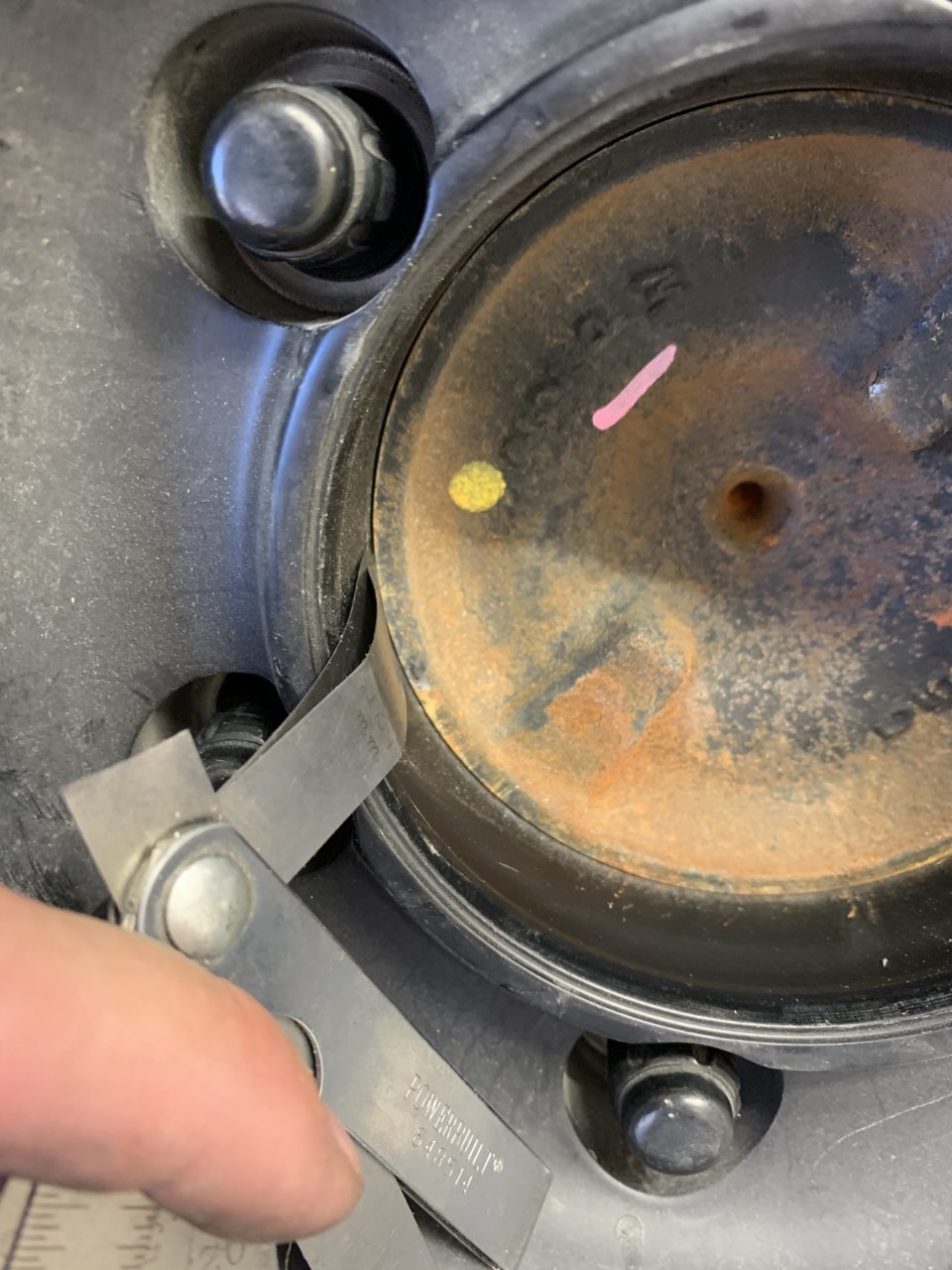

    I held off posting giving both the retailer and Method a chance to deal with the issue and they've both been pretty good so far but I think it's time to give everyone a heads up.
    Details
    Method Wheels MR70368060500
    MR703 16x8 0 offset
    Using lug nuts supplied by Method
    Ordered these wheels online from 4WP. Had new 265/75/16 Nitto Ridge Grapplers mounted to them. Shop that supplied tires got them balanced but their Hunter roadforce machine had a hell of a time, adding 6oz of weight all over the place. Test drive had a nasty vibration at 60mph. Shop tried again, better but balance machine still struggled. Shop tried another set of Nitto's, no dice. Had same shop do it one last time, this time they used the adapter so the wheel mounted to studs and the lug nuts, not the cone adapter. No improvement. While the wheels were spinning on the balancer you could see them oscillating ever so slightly. As if they were off centre. Tire shop determines it's not the tires it's the wheels.
    Off to local 4WP. Guys there are awesome. They have a go. Nope same issue. They throw the truck on the lift and stick it in gear. Sure enough wheels mounted on truck you can see the wheels are ever so slightly off centre and oscillating. 4wp takes videos sends them to Method. Method says we've never seen or heard of that replace the rims send us the faulty ones.
    4WP puts 4 new Method Wheels on today. SAME PROBLEM. That's 8 wheels now!
    I've had a close look myself. When the wheel is placed on the truck the inner centre bore is tight to one side of the axle hub but there's a gap on the opposite side. Even if you're extremely careful when installing the wheel nuts. Carefully tightening them as you go, all 4 wheels pull onto the hub the same way, tight on one side, gap on the other. Not centred. Also something just doesn't feel "right". I've installed lots of wheels in my time. When you mount the wheel to the hub and start a lug nut it's fine, threads on no issue with hand strength. If partially thread one nut on and then try to thread on the lug nut on the opposite side? It gets really tight before it bottoms out, almost feels like it's cross threaded, but it's not. I think it's binding on the wheel itself.
    I find it hard to believe I managed to win the lottery and get the only 8 bad Method Wheels. I would suspect they've got an issue in manufacturing causing this.
    I've asked 4wp for a refund. I'll throw the rubber on the stock rims while I come up with another solution. Hopefully 4wp pulls through with a no hassle refund.
    Has anybody else had issues with their Method Wheels in the last little bit?
    This post is mostly for anyone who's chasing a vibration issue with Method Wheels.
    Pics for reference.

    I left 4wp and Method to sort that out. My guess is yes probably same lot, but that's speculation on my part. I just want wheels that don't womp lol. I'm sure Method will dive into the issue. If they reveal that to me I'll pass the info along.

    Valid points. The lug nuts have been confirmed correct. They have the correct shank and taper.
    In terms of mounting. 3 independent shops and myself have all taken a shot at it repeatedly. There is definitely something not right. The theoretical centre of the lug nuts if you can imagine it, does not match the actual centre of the centre bore. If the wheels were machined to the same specs as factory wheels I suspect you wouldn't even be able to mount them. It's that few thousands of an inch extra on the centre bore of the wheel that's allowing the wheel to be mounted at all.

    Sounds like the center of the bolt circle is not coincidental to the center of the hub circle. Additionaly, you are balancing lug-centric wheels using hub-centric methods.
    If it doesn't have flat/washer lug nuts and a fitted hub, it is not hub-centric. What you have is a fitted bore and tapered lugs and is a problem when the previously mentioned centers do not coincide.
    A lug-centric balance might do the trick. Otherwise, wait for Method to make them right.

    First shop attempted to balance them lug centrically a few times. In fact the worst vibration was when they were balanced that way.
    Yes they did. However these rims are supposed to have the same/close diameter hub bore as stock so the plastic adapter can't be used. I believe the hub bore in the wheel is almost identical to the axle hub diameter. But because it's not centred in relation to the stud holes it binds up against one side of the lip of the axle hub.
    Axle hub is 106.1?

    106.1 nominal...approximately.
    Have you seen the lug seats on the wheels? Are they getting chewed up?
    Runout test on the studs?
    Like I said, I think the centers aren't coinciding...hub centric and lug centric are fighting each other when mounted on the vehicle.

    I haven’t had a look, but I suspect you’re description of hub and lug centric fighting each other due to miss machining is bang on.
    Not worth the effort. Truck ran smooth as silk with 265/75/16 studded Hakkapelitta, plus the wheel an tire’s bizarre behavior on a road force balance machine is proof enough it’s the wheel and not the truck. The setup was literally causing the drum that applies the force to bounce.
    0% chance I ever find out. The fact the wheel exhibited the “wobble” even when it was balanced using the lug centric adapter for the road force balancer is enough proof for me to give my opinion. And there’s no way I got the only 8 bad ones. There’s an issue, might just be this model of wheel, don’t know. Hopefully this week I’ll drop the Methods off and swap the Ridge Grapplers over to the stock wheels and put it behind me. Credit to Method, they didn’t hesitate to send 4 new wheels, ultimately those had issues as well but it sounds like a refund is on my way so, yes it’s been a hassle but that’s life sometimes, both 4WP and Method have tried to make it right, can’t fault that.
