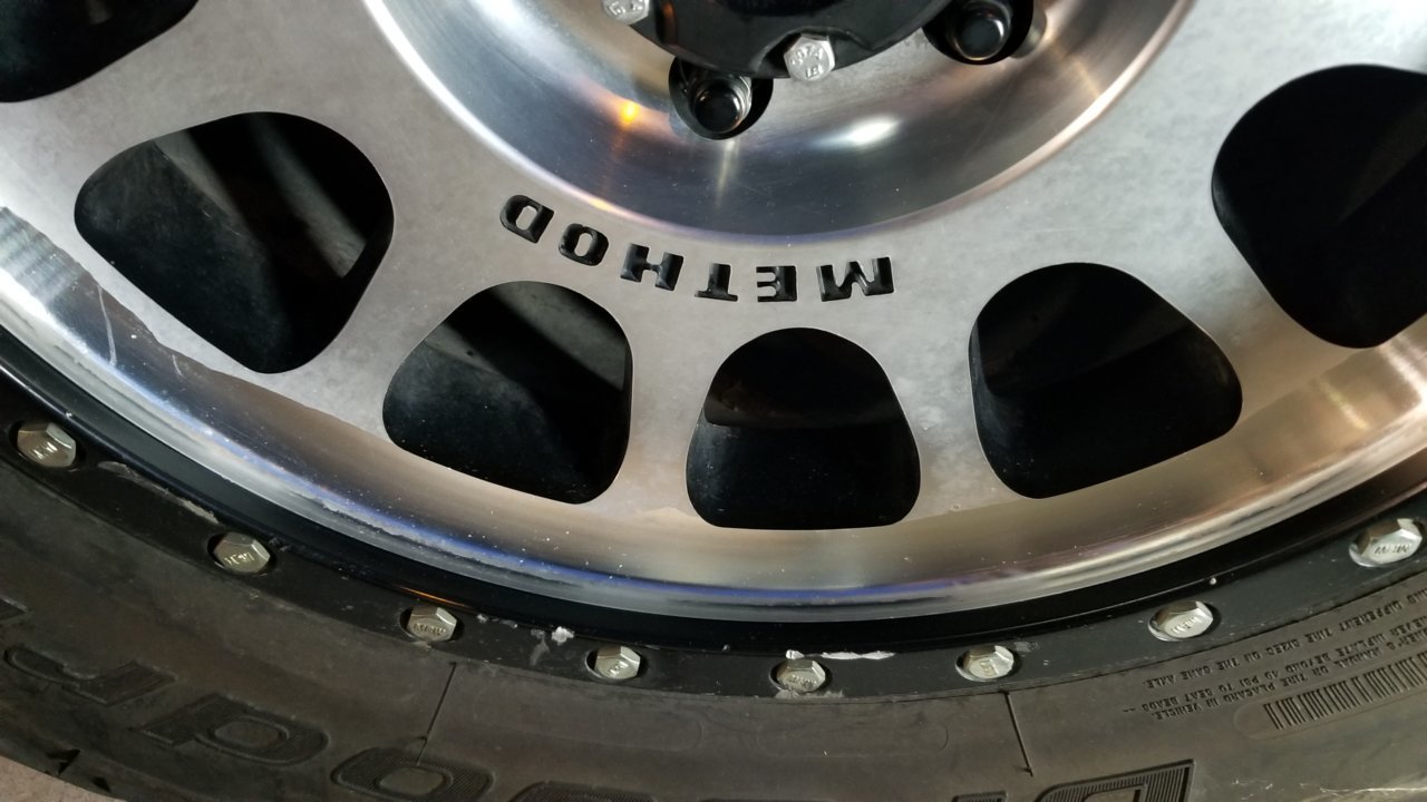

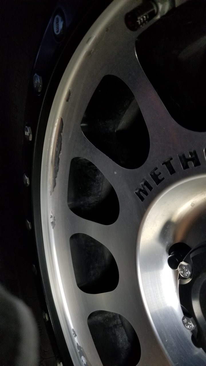

    only been on the truck for a year. anyone else have these issues with there method race 305 wheels??
    to put things into perspective:
    -wheels have been sitting on truck for a year now.
    -driven once a week usually on sat or sun
    -after going on a trail i always go thru a touchless car wash to rinse off dirt and wiped down afterwards
    -truck is kept in garage 6 days out of the week

    It actually started about 2 months ago. It's on all 4 rims now. I don't think dusty rims would cause that kind of damage after only 1 year. And was barely driven on. My offroading is like 2 or 3 hours a week.
    However I did contact method. It is under warranty. But there is a catch. I have to buy all 4 new rims with my own money first. Then send them back these ones. And then they will refund me. Kinda hard for me to cough up that much right now as it already took me months to save up for these to begin with. Lol

    As for the damage. They said they see that kind of damage usually done over a long periods of time for people who go to beaches and dunes where there is sand. Sand get in the channels and rubs away the clear. But in my instance I don't have sand here. Or anywhere I go. I haven't even gone playing in the mud. Just dusty trails and washed when I get back into town

    Any chance the solvents and soaps in the touchless could corrode the clearcoat?

    I had the same wheels with clear coat issues. When googling it I found lots of complaints about clear coat wheels, and not just methods. I stripped them and painted them with duplicolor wheel primer and paint. Took a day and looks good. Put 90k hard miles on them and still look good.

    I thought this at first. But my other 2 cars also have aftermarket wheels with clear on them. One of them is 8 years old on the honda and the Lexus wheels are 5 years old. All cars go to the same car wash. And the clear on those rims are still like the day I bought them. Method on the other hand. Hmmm

    This looks like the identical issue I had with OEM Ford wheels on my '98 4WD Ranger. It happened to a lot of clear coated raw aluminum wheels in that period. Lots of issues with adhesion of the coating to the aluminum and it starts to check. Once it does that, filiform corrosion sets in and it's all over. I still have those wheels on my 24 year old Ranger but I've coated them with PlastiDip because they looked so shitty. It's relatively costly to strip it and then polish the wheel so I let it go. The caveat, it took 10 years before it happened on my OEM's.

    The issue with these Methods looks like an adhesion issue. Like putting down a beautiful paint job on a piss-poorly prepped surface. IDK.
