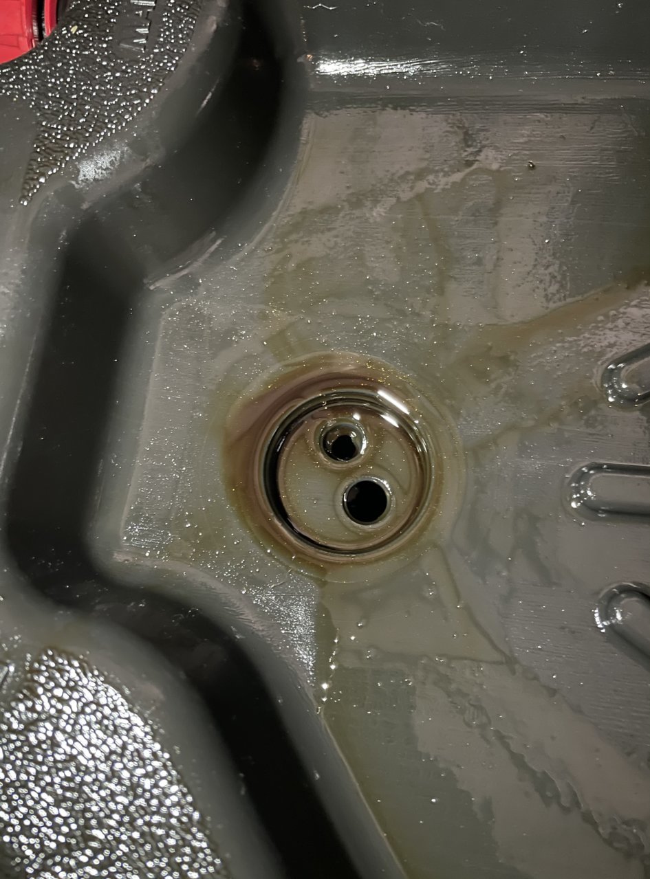

    Hey all! I have a 2020 TRD Sport, and just changed my oil at a 5,000 mile interval. This is the second oil change I’ve done on my truck. It has just under 10k miles.
    I couldn’t help but notice the glitter, and what I can sadly assume is, metal shavings in the used oil..
    My question is: Should I be concerned? Could the truck still be “breaking in” and this might be expected? TIA!

    New engine. Not uncommon to see shavings on the first oil change. That is why every manufacturer suggests it be done at an earlier interval than all the rest.

    First change? i wouldn't worry that's normal

    Normal. The next change you'll likely see fewer shavings if any at all.

    Some of that doesnt look like metal to me. How clean was your drain pan amd the area om the truck around the drain plug when you started draining it.

    It’s normal! I changed my oil in my 2020 4Runner 3k and filter was full of metal shavings. Changed it at 7k and there was nothing trapped in the filter. I expect to find metal flakes in my filter on my 2021 Tacoma when I change the oil.
