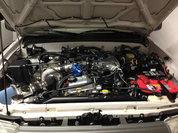

    Here's the engine bay that most of my friends ogle over. I pride myself in keeping my truck clean and detailed inside and out.

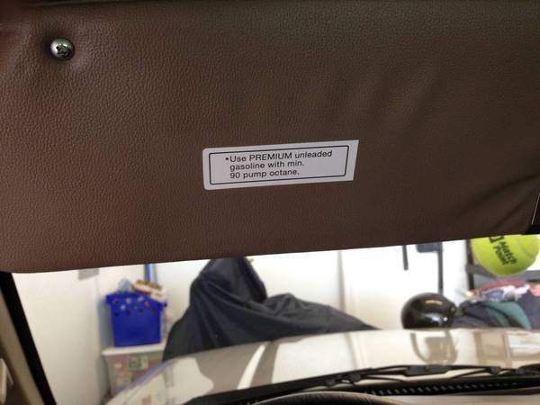

    Gotta have this sticker. There's actually a purpose, too: the snail under the hood only drinks the finest petrol available.

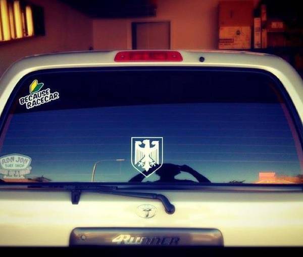

    Also gotta have some stickers on the back.

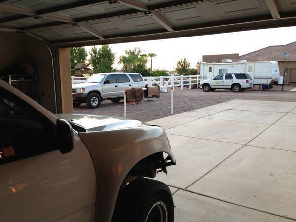

    Sitting next to my buddy Juan’s Tacoma (JuansTaco on TacomaWorld).

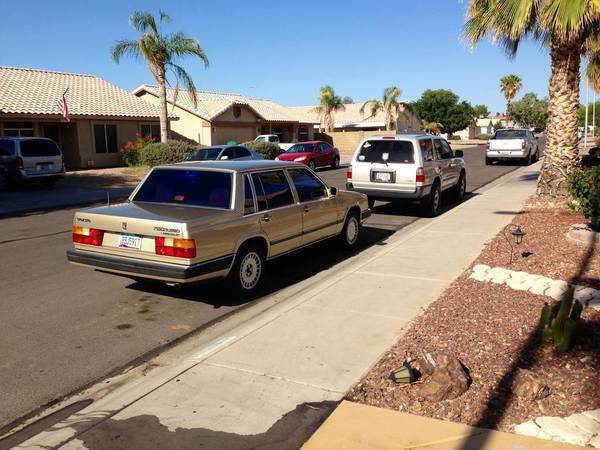

    In front of my friend Angel’s Volvo.

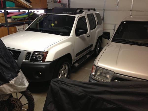

    Next to my dad's Xterra (I tried to convince him to get another 4Runner, but my attempts were futile) and 2 of his bikes. I do not ride but I enjoy working on the motorcycles.

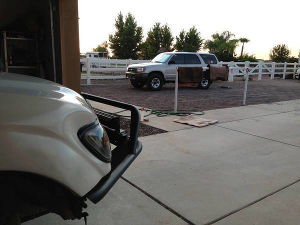

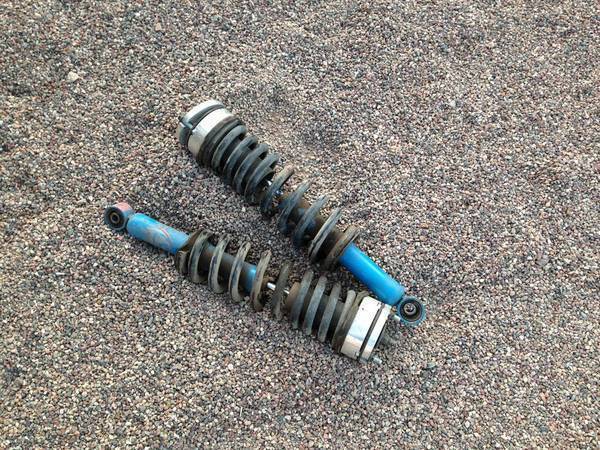

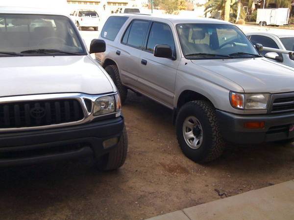

    Hung out with JuansTaco today. We bedlined his new bumper, got some new-to-him 265/75R16 BFGoodrich All-Terrains to tide him over until he does his mid-travel setup, and I got some ToyTec spacers for the front of my truck. The lift is finally coming together! I still have to find a rear setup (probably 2.5in spacers from Fat Bob's Garage). Now for pics:
    You can see the bedlined bumper here - looks pretty sweet!
    And my parts. 3in ToyTec spacers (I am most likely only going to use the preload spacers for 2.5in of lift) on some Tacoma TRD Offroad coils (keeping these in case the preload spacers make my coils sag significantly).

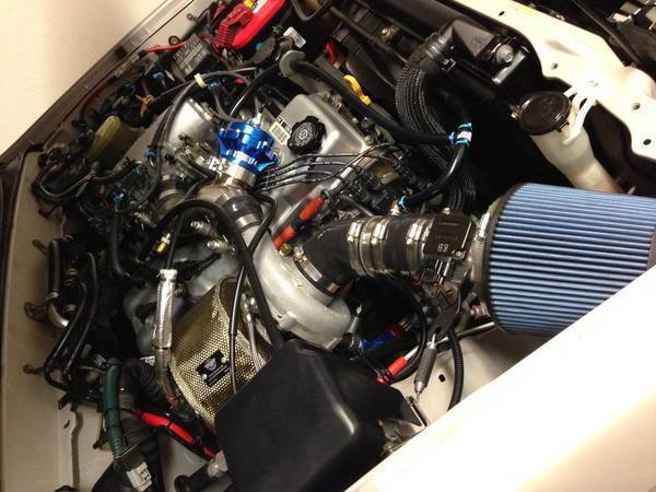

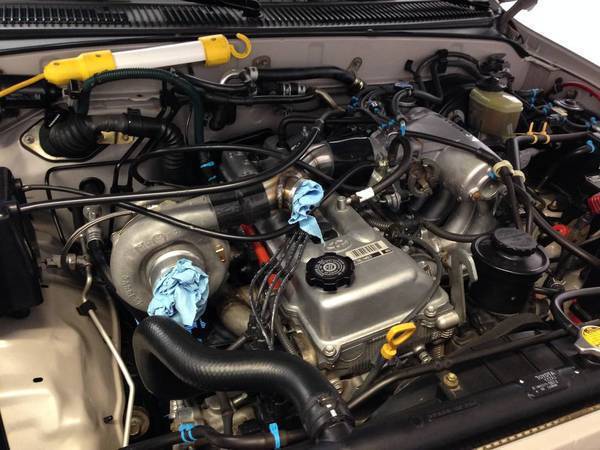

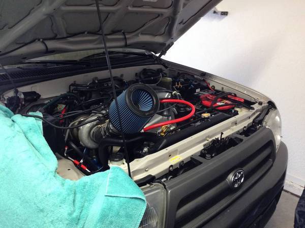

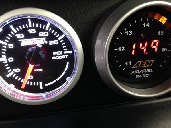

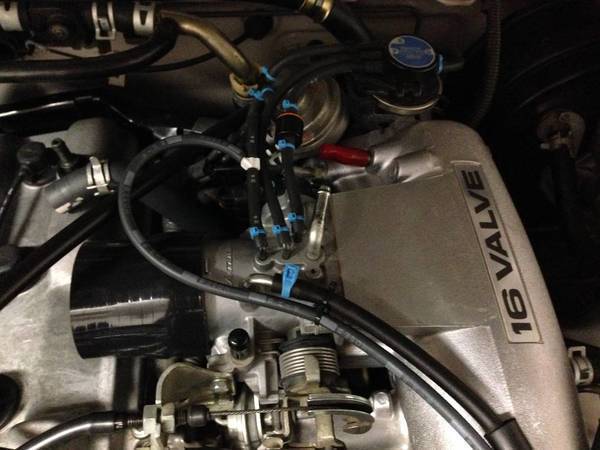

    The turbo 3RZ is awesome. Still working out a few kinks, and may end up getting some sort of fuel management, but overall, it's great (and I think all of my problems stem from the fact that my truck is autotragic). Definitely worth the money.
    Here's some pics.
    Partway through install
    A bit of my vacuum routing (looks pretty factory IMO)
    Gauge wiring (my dad is far superior to myself when it comes to wiring)
    How I got it running before it was all finished (I call it the unicorn setup)
    Gauges in action
