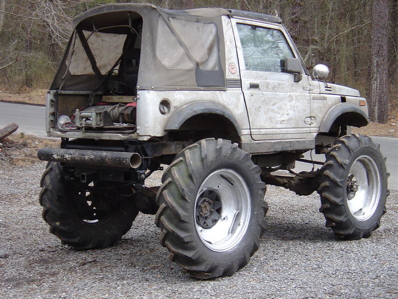

    I prefer the 52" tractor implant tires. With 5.27 gears. Still get 20-21 mpg. /S

    Meters per gallon lol
