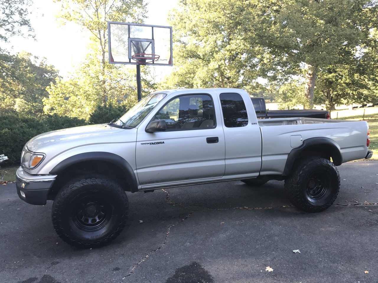

    I’m probably looking at keeping it simple. What does a 3 inch with 33’s look like?

    8511FF5C-7FB7-473F-8E40-3E6F3841783E.jpg This is mine with 2.5” in the front and 1.5-2” in the back with 33x12.50x15s. The front looks a little higher in the first picture because it’s on a very slight incline. Here’s another picture. 52B56E42-0ED9-4DFF-AFA2-19CF414E3267.jpg
