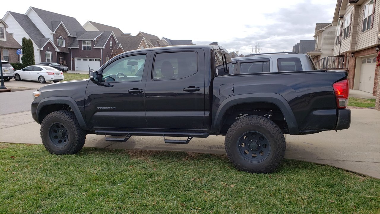

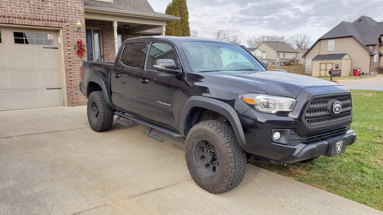

    2017 TRD Off Road DCSB
    SUSPENSION: Icon Stage 4 with tubular UCAs WHEELS: Black ProComp 69 TIRES: BFG KO2s at 265/75/16 Partially debadged Diaz Fabrication Model T up front
    I have the Pro Comp 69s. I like 'em.

    True, they are pretty close. These are at a -12 offset I believe.
    I think Black Rhino has a good set of flat black 16" wheels though.
