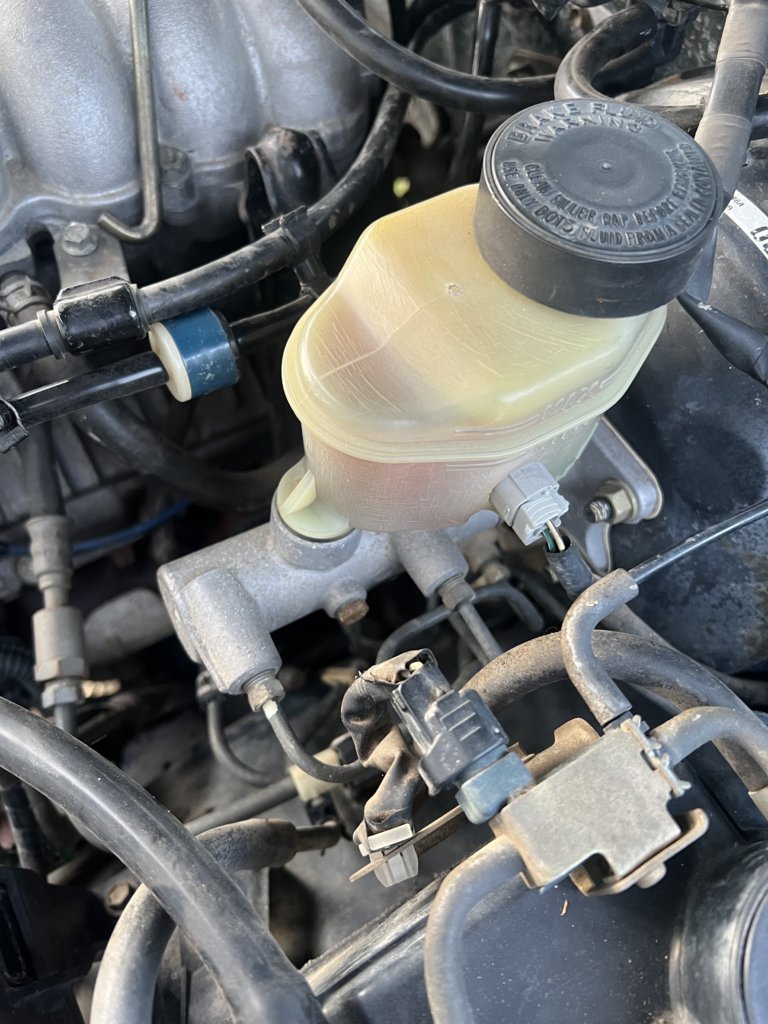

    The master cylinder reservoir in my 1999 Tacoma appears to have a lot of cracks, not leaking, and can't feeling them though.
    I've looked around for a replacement reservoir but other than OEM I can't find a match. Seems like a lot of after market master cylinders don't include the reservoir either.
    Any ideas for a good replacement? Should I just get a new master cylinder, if so any suggestions?

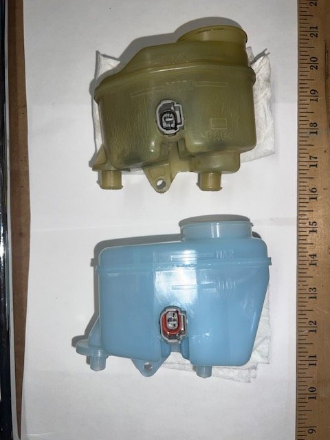

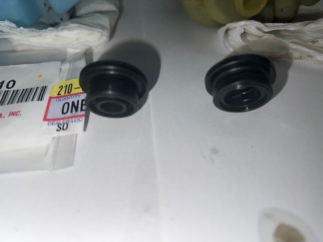

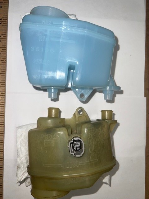

    So part # 47220-35040 fits the non ABS master cylinder too? Is there a difference in grommets?

    Did you ever find the answer to this question? I'm in the same bote, trying to replace the MC reservoir only but the the non ABS version is no where to be found and was wondering if the ABS version will fit the non ABS master cylinder.

    Haven't tried it yet. I just decided to wait until I get a leak
