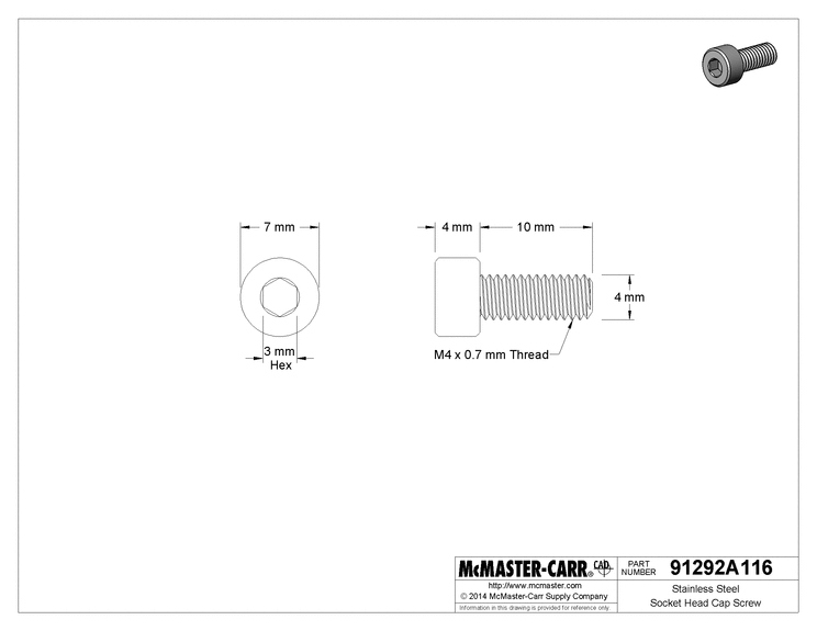

    I slightly stripped one of the mass airflow sensor screws a while back. Still works, but I'd like to replace the screw and have some spares, cause I clean it twice a year. I just found out that some or all of the screws on a Tacoma are JIS Japanese standard which explains why they are so easy to strip with an American screw driver. Got some JIS screwdrivers on the way now.
    Does anyone know the exact screw size for the MAF sensor?

    I took 1 of mine to HD and found a Allen bolt. Been ok for 2 years. Easy to remove/install for MAF cleaning.

    I like the idea of allen bolts too. I'm going to do this too since I remove them often.

    I replaced mine years ago with allen bolts also. It was hard getting a standard length screw driver in there. I had to always use a shorty screw driver to get the right angle to keep from striping it. Now with a small allen wrench its easier.

    I bought mine at Lowes. M4-.70 x 10 Product # 880821 Comes with 2 in a pack. Fits perfect.

    I am pretty sure I replaced them with hex head M4 bolts out of my bolt bin.
    I would need to double check for the thread pitch.

    Thanks. Googled the size and found them at Home Depot for $1.25 for a pack of 2.
