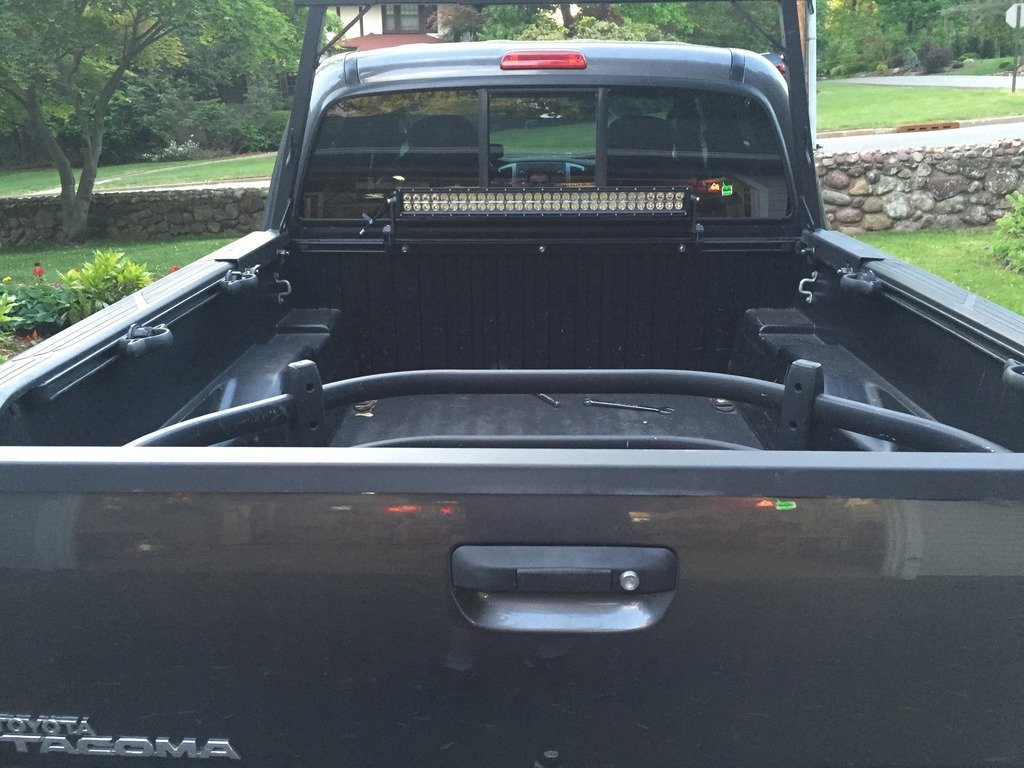

    Pretty simple, but effective. I'm sure I'm not the first person tho think of this...
    Aluminum angle, 1" square tubing as spacers, 1/2" carriage bolts ground on two sides in the bed rail. All Stainless hardware except for the carriage bolts. Couldn't get them locally and didn't want to wait...

    Not for brighting anyone. Backing my trailer into DARK places...

    I dare someone to ride your ass down the road though. They would end up in the ditch lol. Where did you run the wires, into the cab or under?

    I don't think the placement on the rear is going to help with backing a trailer.

    It depends on what kind of trailer.....a flat bed then yes but a box trailer I could see it not working well.

    Yeah, that's why I wouldn't do it. It's blinding... They'd probably end up hitting ME! :)

    Oh, I went the easy route. I ran the wires under the cab. The harness was actually JUST the right length.
