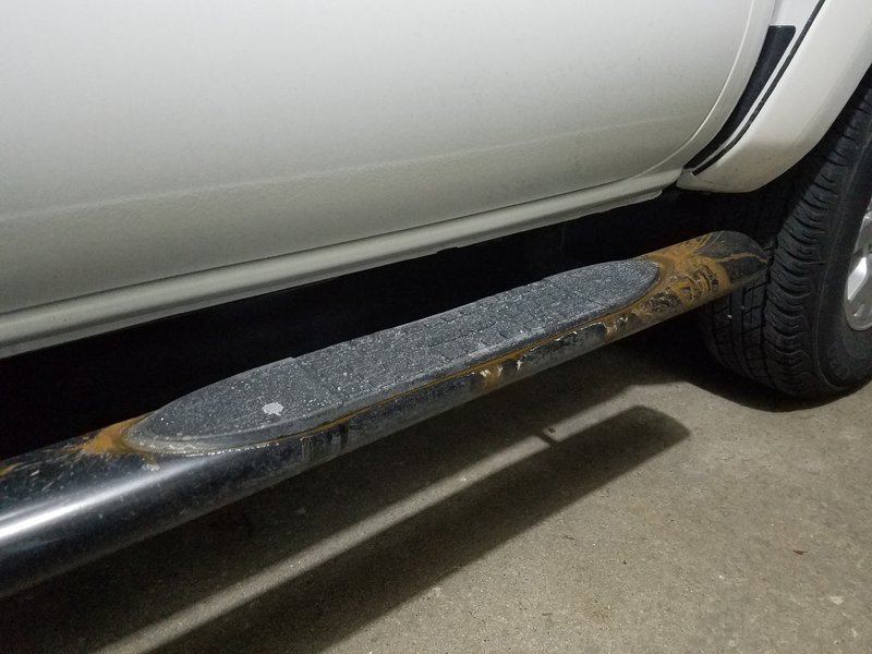

    Had the same issues. Tried to repair it but it got worse. Waiting to hear back from Lund. 20210427_203931.jpg

    I had Lund 3" oval steps on my 2008 a long time ago and had the exact same problem, but it didn't show up until I was long out of warranty.
    I took mine off, sanded them down a bit to move the rust and give them a tooth for the new coating, sprayed them with rattle can bed liner and got a about 2 more years out of them.
    IMO it's a design problem. Water works it's way under the step pads and goes the holes where the pads "snap" into the top of the steps. It gets trapped inside the tubes because the ends of the tubes are plugged.
    If they are telling you to drill drainage holes, you might want to consider doing that in the plastic end caps and not in the metal step itself. If you drill into the metal you're just creating a place where the powder coating is compromised and rust will have another place to live.

    For what it’s worth, I have these same steps, about 2 years old. No issues so far. With this set...
    However, mine are warranty replacements. I formerly had the same set on a ‘12 prerunner, which I drove through some high brackish water after hurricane Florence in 2018. Soon thereafter I started to see the orange stains around the steps. I presume some brackish water got inside through the step clip holes or the bracket mounting holes, and enough salt was present to start corroding them from the inside. No damage was visible from the outside.
    RealTruck.com processed a warranty claim for me via emailed photos and they sent me the new set I have now. The ones that corroded were right around a year old.
    Agree that there’s a weakness in there being no way for water to get out once it gets in. I actually drilled drain holes in mine after I discovered the rusting, and couldn’t get orange water to stop coming out of the drain holes. Wasn’t about to allow my driveway to become rust stained. Agree that drilling holes also creates a chink in the powder coat armor and is not a satisfactory solution.
    All you can do is aggressively pursue a warranty replacement, while understanding that the vendor and the manufacturer probably have no obligation to replace if you’re more than one or two years past purchase date. You’re basically just hoping they’ll be cool and take care of you. But read any fine print from your orders / purchase paperwork for more detail.

    I have same issue with Lund on my 17 Tacoma . Spent 8 years waxing, drilling drain holes , removing and injecting fogging oil . Just installed a new set . Can i remove the pads, lay down silicone bead , and reinstall them?

    Also be watching where they bolt on under the truck, that’s where the most started on mine..good place for salt/mud to collect and start the cancer
