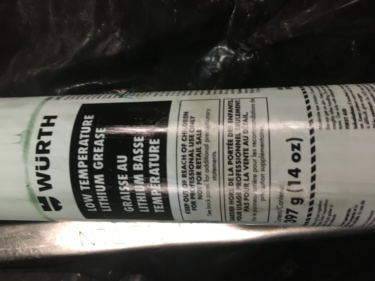

    What driveshaft lube are you guys using?
    I was using this stuff before. Toyota tech gave a couple tubes to my buddy and said it was the best stuff.
    Wurth doesn’t make it anymore so I’m just wondering what’s the lube of your choice. Laugh all you want ya animals.
