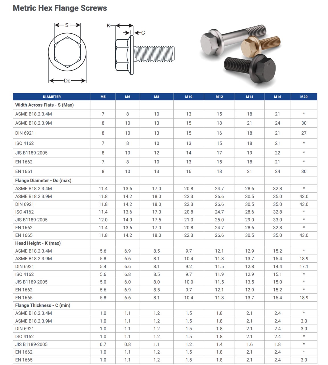

    Nope, those are not JIS. They take an 18mm socket, not 19mm. Im sure they will work fine, and I may end up using them if Im unable to source JIS hardware.
    My tool rolls are already quite heavy with all the tools I carry for possible trail repairs. Keeping these bolts the same as a standard Tacoma and not having to carry an extra / special tool would be a big plus in my book.

    The bolts I sourced are DIN6921 standard 10.9 steel. If you see the chart below, the bolt head drive is 18mm compared to 19mm on JIS B1189-2005. They are both quality bolts and really the only reason to search out JIS bolts that have a similar shoulder length and overall length is to keep the 19mm drive so you can carry less tools, which is SR-71A's concern.

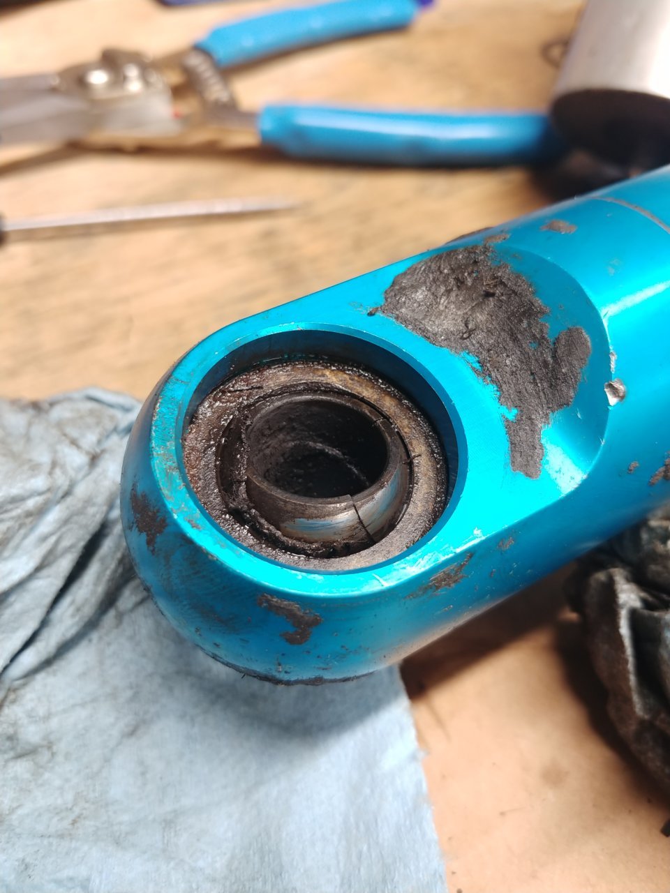

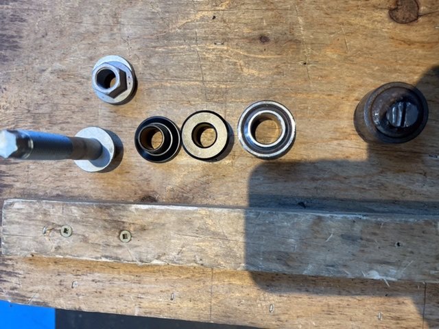

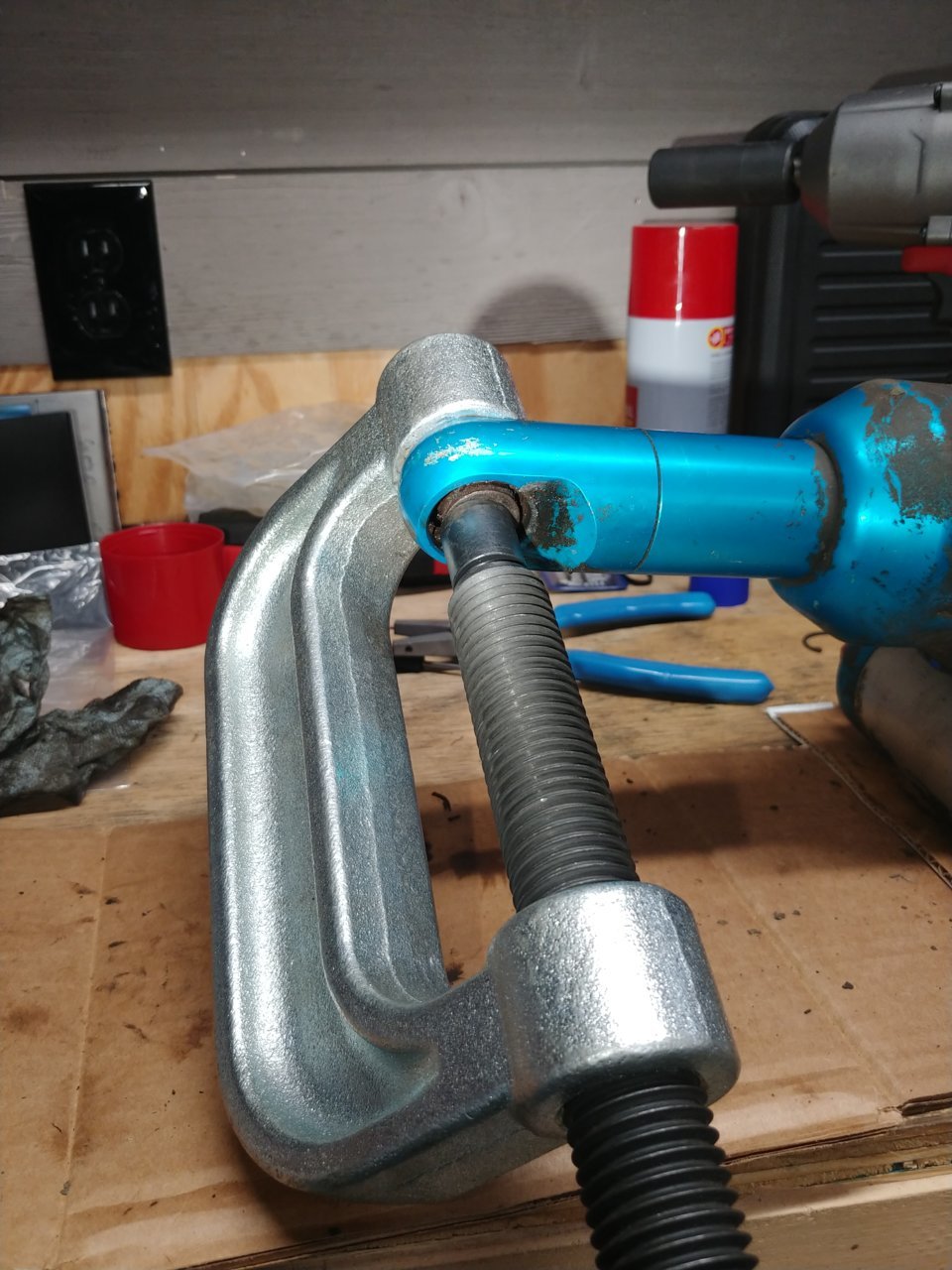

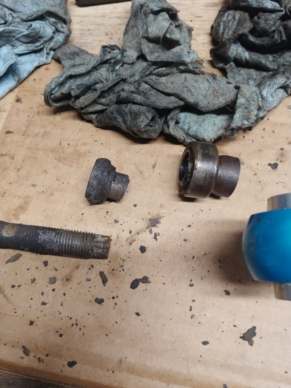

    Yeahhhhh it was time to replace these. Got the drivers side done this weekend. Hope to do the passenger next weekend. Absolutely destroyed. Misalignment spacer worn right through
    Also, balljoint press fit perfectly to press the old one out. Small socket to press the new bearing in then squeeze the new spacers in using the vice. As much grease and fluid film on the new one as I could get :D
    I *think* you could do this on the truck without pulling the shock, but I was able to get it out without pulling either UCA or LCA so I did mine on the bench.
