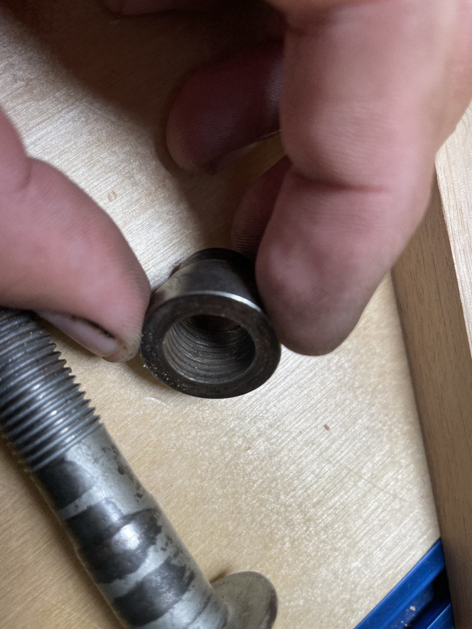

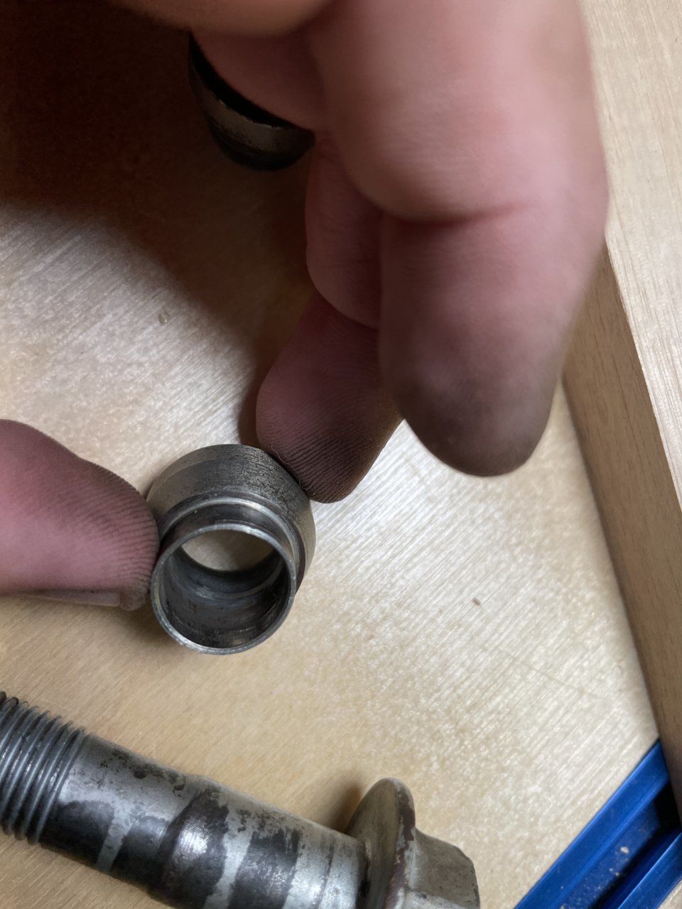

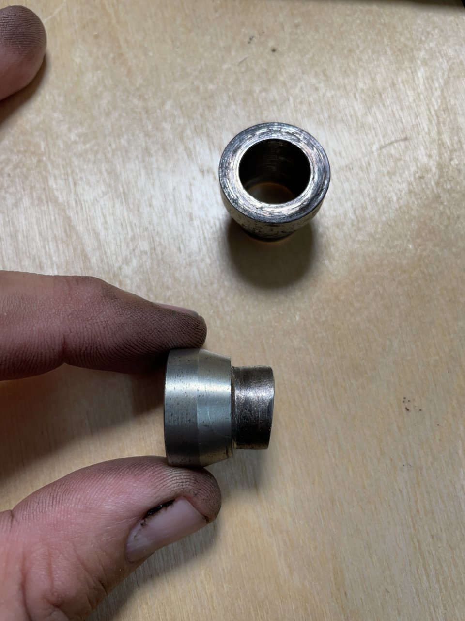

    The other day my truck started creaking terribly. I finally narrowed it down to the lower shock bolt front, driver's side. The stock bolt has a double stepped shoulder that doesn't go all the way through the bracket. This means that the King aluminum spacers sit oddly on the bolt shank. The back spacer sits partially on the thick part of the shoulder and partially on the thin part, causing the spacer to distort and wear unevenly. The other spacer sits partially on threads which cut into it. Is this normal? Has anyone else experienced this?

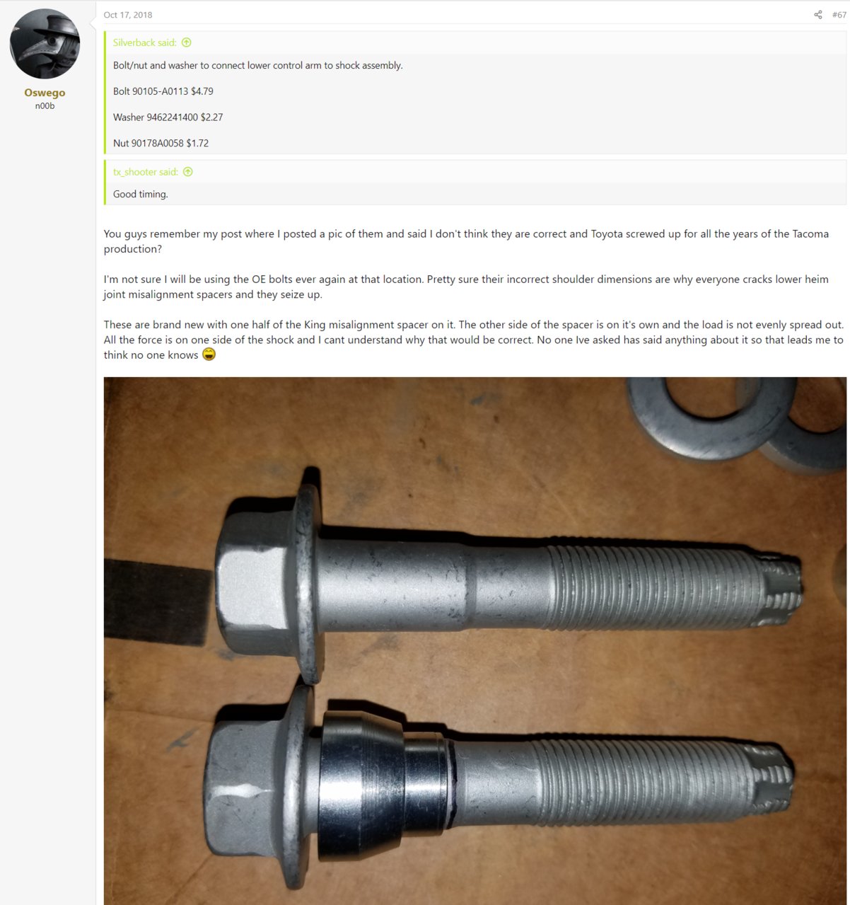

    I found an older thread on another forum talking about the same thing with no resolution:

    It was the galling from the spacer to the shoulder that was making the noise. I greased them and put them back in while I try to find a better bolt or other solution. I talked to King, Filthy Motorsports and Wheeler's and until a few minutes ago, nobody thought there was anything wrong which I find astounding. The facts are irrefutable. The spacers both have the same ID even though they sit on a bolt, in positions, with different ODs. Also the shoulder is so short that one spacer is sitting on threads. This is NOT ok. King got back to me after I suggested that this issue get escalated and this is what they said: "Yes, apparently the new trucks have a step down now, we don't have a fix for that yet, but I'm sure you could use the old style bolt that they used to have before but for the time being we don't have a fix yet."
    They want me to check back at the end of next week to see if they have a fix.
    Strange thing is... My truck is a 2013 and that's the OEM bolt that it came with.

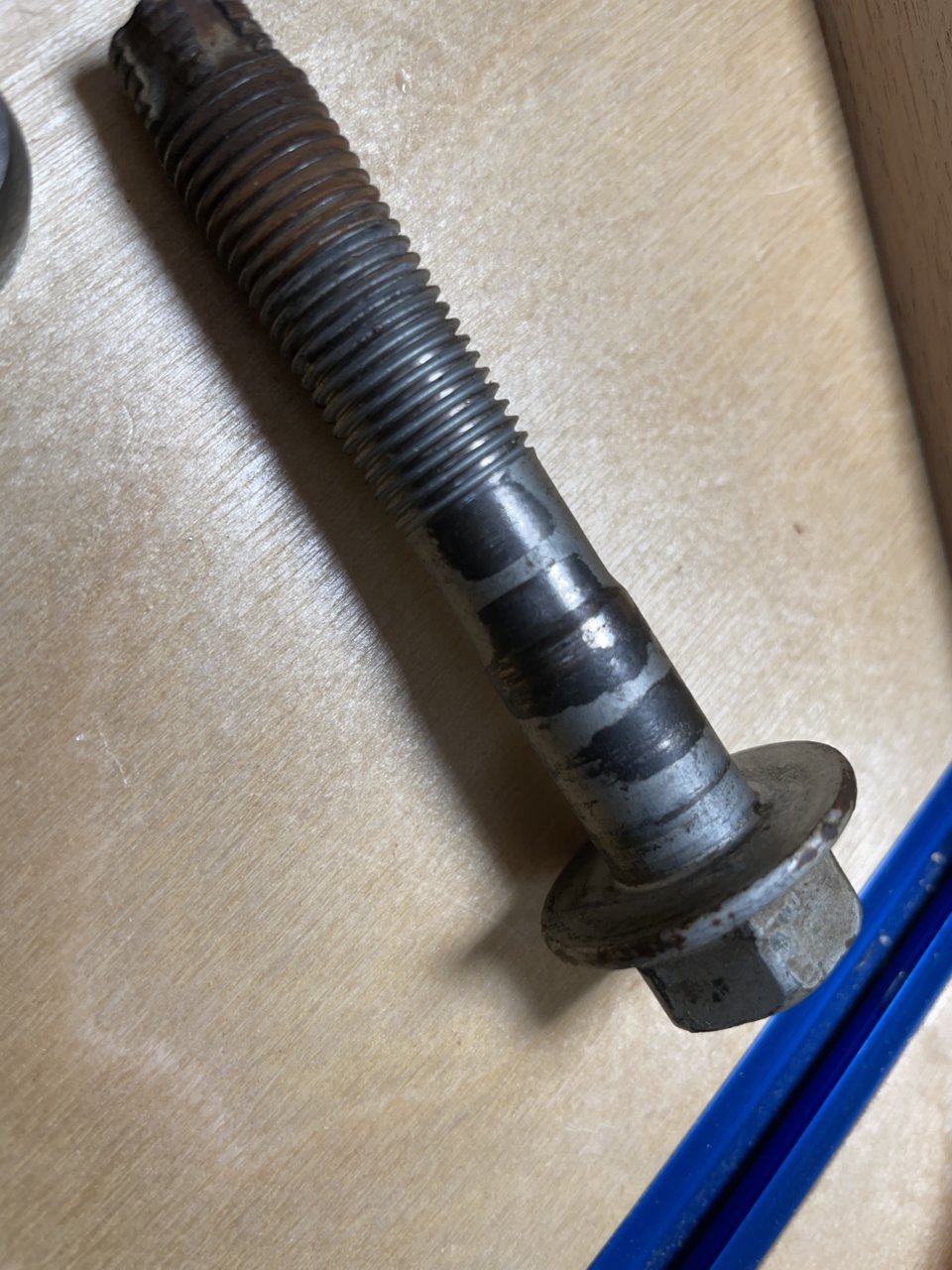

    I ran across some pics of the bolts side by side that I took. The drive is smaller but the flange is the same:

    I did not take any photos of my parts before I tossed them, but my bearings, bolts, and reducers/spacers had very similar wear marks to your photos. My passenger side bearing had more wear and could freely rotate like a ball (side to side and front to back).
