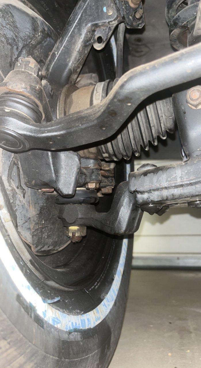

    Hey guys, taking this truck off to college this week and making sure she’s in good shape to go. Do these LBJs need to be replaced? I’m not sure what determines that. Thanks guys!

    If you don’t know how old they are or their use history and you have the funds to replace them with quality ones, I would do it. Hit the reset button on the mileage to a critical part. You don’t want it breaking on the way to college loaded with all your stuff in the back. Def don’t want it breaking loaded with hunnies in the back, that would be embarrassing. Get new bolts too and boot protectors if you want to add more protection to the boot on the joint itself. Use blue loctite for the new bolts you buy.

    The boot looks good but it's impossible to tell from pics and looks don't matter much. What matters is play in the joint itself. Jack up the wheel and safely support the vehicle, then grab at 12 and 6 and attempt to rock the wheel. You can also strategically use a pry bar. It may help to have a second person watch for movement at the joint. This exercise would also reveal wb play so if you find slop watch for exactly where it is rather than immediately condemning bj's.
    If you don't find play I absolutely would not bother with replacing.
    Furthermore, things are not always what they seem; I just disassembled the 4 bolts on a '00 to do the CV and they were significantly rusted in. What should have been 4 minutes turned into well over an hour to remove 4 bolts using the blue wrench to carefully apply heat. I then chased all the threads and reassembled with anti-seize.
    I tried removing the bj stud instead but no amount of PH3050A persuasion was convincing that taper to release.
    IOW, don't fix what ain't broke.

    OP only you can choose the level of fear mongering you find acceptable. If there's no play there's no reason to replace. Furthermore the odds of getting quality aftermarket joints that are any better than what's already in there is questionable. Source OEM I guess.
    If you want to follow the logic of others you better replace upper ball joints, too. Also wheel bearings because they could separate and you'll lose a wheel. You better replace all steering linkages because a TRE could come apart. You better replace your steering rack because you don't dare risk losing power assist in a corner. You should just replace your brake pads, rotors and calipers now rather than risk personal injury (apparently). Also your master cylinder because, safety. Change out all your tires now because you don't want a blowout.
    Or, you could inspect parts and replace when wear is actually detected and verified like all honest, professional shops do.
    It's your money, your time and how much you enjoy panic porn. Good luck!!

    I completely disagree with you. Most of the items you listed will display possible signs of wear or fatigue before they break. It's well documented that the lower ball joints are prone to sudden failure if not maintained (replaced). I do agree that you shouldn't change out parts just because- but for LBJs there is a perfectly rational reason to suggest that if the history is unknown, to simply replace them. The OEM joints are not that expensive, and they are certainly less expensive than the collateral damage caused by a failed one. That's not fear-mongering- that is passing on the collective wisdom and experience of this and other 1st gen Tacoma communities.

    Forget the catastrophic results that can be seen when 26 year old LBJs are ignored because they are 'ok' - this is the simplest DIY job a person could undertake with the most return on time and investment, peace of mind wise, out of all the things you listed; there's really no reason not to replace these.

    Try to search the history of your truck on Toyota using your VIN. You might find that it was replaced not long ago. I would check that and test the joint for play. Wouldn't replace if it seemed fine.
