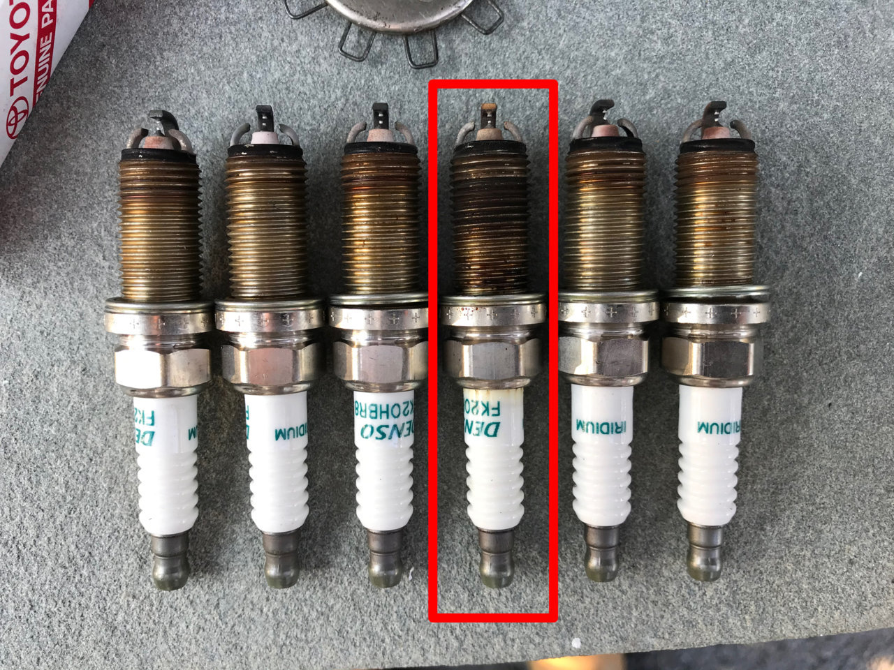

    I recently tuned my truck with OVTune using their new VFTuner software. Even though I’m only at 35,000 miles I decided I would change my spark plugs to ensure the best performance with the new tune. They are expensive spark plugs, cost me just under $22 a piece plus tax at a local Toyota dealer.
    I started on the left side (drivers side) bank of the engine working from front to back. The drivers side is more work than the passenger side but the whole job is a piece of cake none-the-less. I removed all the ignition coils and laid them on the engine cover in the order they came out. I moved on to the right side (passengers side) and proceeded to remove all the coils. When I removed the last coil closest to the firewall (right next to the bright silver high pressure fuel pump), I noticed it was a more brownish color than the other coils. I laid it with all the others for comparison. It was very clearly a different color from all the rest. With all the coils out, I gapped all the new plugs and proceeded to change them out one by one (I don’t like leaving a hole into the combustion chamber for very long). This is where things got interesting...
    All the plugs were barely tight, it took a very minimal amount of torque to break them free, I could have broke them free with a 1/4” drive screw driver. When I got to the last plug with the brownish colored ignition coil, I found the spark plug was loose! There was evidence of blow by happening on the plug as well. Oil and fuel have been blowing past the loose threads and onto the ignition coil creating the brownish color and a brown tip on the spark plug (see attached pictures). I’ve always noticed a little spark knock on hot days, I wonder if this was the culprit the whole time. I installed all the plugs, put some dielectric grease on the inside of the coils boots and put it all back together. I cleared the learned values for the engine using VFTuner and immediately noticed a difference in how the truck ran. It runs smoother and has slightly better power all through the RPM range. This loose plug must have been causing a lean condition on that cylinder as well as a loss of compression. I’m glad I decided to change them long before they were due. I think everyone should check theirs as well because I doubt my truck is the only one.
    This is the second thing on this truck that was screwed up from the factory, the first was the transmission low on ATF. Is Toyota’s QC slipping it’s what? These big oversights are not confidence inspiring at all. Check out the attached photos for reference.

    no doubt it was loose
    may have loss a modicum of compression
    i dont think damage was done to the engine
    actually plugs 1 & 6 look bad ( as U have them line up )
    running lean / over heated
    not sure exactly which cylinders they came out of
    tip
    i use a 4 X 4 block o wood drilled for the sparkplugs & valves.........numbered
    ( analytical retentive/ ocd )
    quite a few OVER tighten risking head damage
    ( 2 piece spark plugs on fords are nightmare !!! )

    This is nothing new. Some of the 3rd gens are known to have loose spark plug issues like they were Monday or Friday builds or something. Your engine is fine. I have pulled plenty of loose spark plugs off of vehicles before and replaced and things have been just peachy after. Misfire recedes and the engine just keeps on truckin'.

    Ain’t nothing wrong with those plugs! Clean them up and slap them back in for another 35,000 miles.

    Checked mine the other day and they all clicked at 13 lb-ft. And yes, with that little torque on them to begin with, it doesn't take much effort to break them loose. And yeah, top drivers side plug is a pain to get to especially with a torque wrench.
