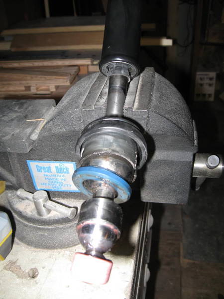

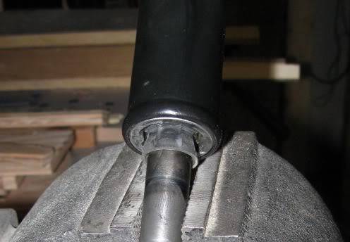

    Sorry no 6sp here. But found some good info on what I think is your problem. It may not be the bottom bushing but rather the plastic in the rod where it connects to the shifter. Read threw the whole thing... You'll see what I'm talking about

    i appreciate the help. however, i think i described the problem wrong. it is not the bushing at the very bottom. its the bushing thats located in the shift tower itself. the shift tower is made of 2 pieces and there is another bushing in between the 2 pieces and thats the part that failed. again thanks for the help. if you need any more clarification let me know! thanks.

    Yeah your pic is tiny could not see it. That's the part they were talking about in the link above.

    yea thats the part I'm talking about. i don't have the tools do do any type of welding and idk if epoxy would hold in the long run... the dealer parts mgr quoted me 160 for the part with my military discount :) so ill probably order from them. do you guys think it would be a tough thing to do by myself? does anyone have any write-ups for this that you know of??

    I had the same issue with my '06 6spd. The rubber that connects the two segments of the shifter wears out and it starts getting really sloppy. Mine was actually rattling because the top of the lower section was rattling against the inside of the upper section.
    My fix was to pull the whole thing off, completely pull them apart(which was a pain), fill the upper section with epoxy, and then put it back together and let it harden. It pretty much made the dampened 2 section shifter into a solid piece.
    It definitely stopped the noise, but I get a lot more vibration coming through the shifter from the transmission now. It makes the shift knob rattle eventually (I've used a couple, and the same thing happens after a while due to the increased vibrations). If I did it all again, I'd just bite the bullet and get a new shift lever.
