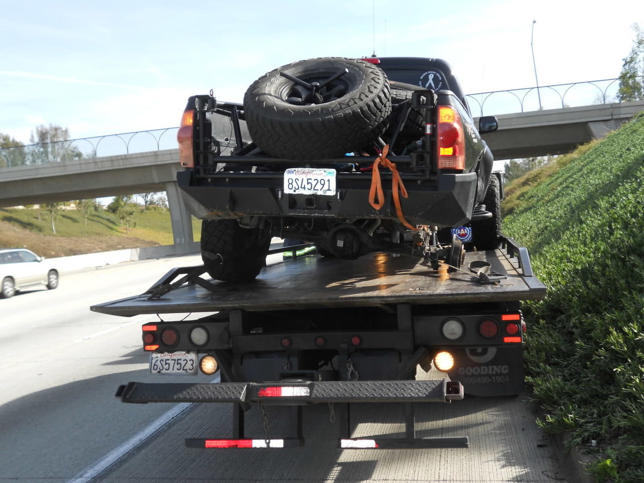

    Torque Values are an engineered figure for a reason
    There is probably, considerable leeway, over/under, to a limit.
    Correct lug Torque keeps your wheels on your vehicle, thus your vehicle on the road (ask how I know).
    Under-torque can result in loosening, over-torque can result in failure, as in pic below.
    Any lube on the threads also changes (lowers) the engineered torque value. Yes, even anti-seize.
    Once again, not a drastic change, but over-torquing a lubed thread a 100 times, can have a cumulative effect.
    One of the results can be degrading of the threads on the bolt, nut or both and possible bolt failure.
    Have to agree with janster and others above,
    Inspect lug threads, replace if worn, new lug nuts and get a good torque wrench.
