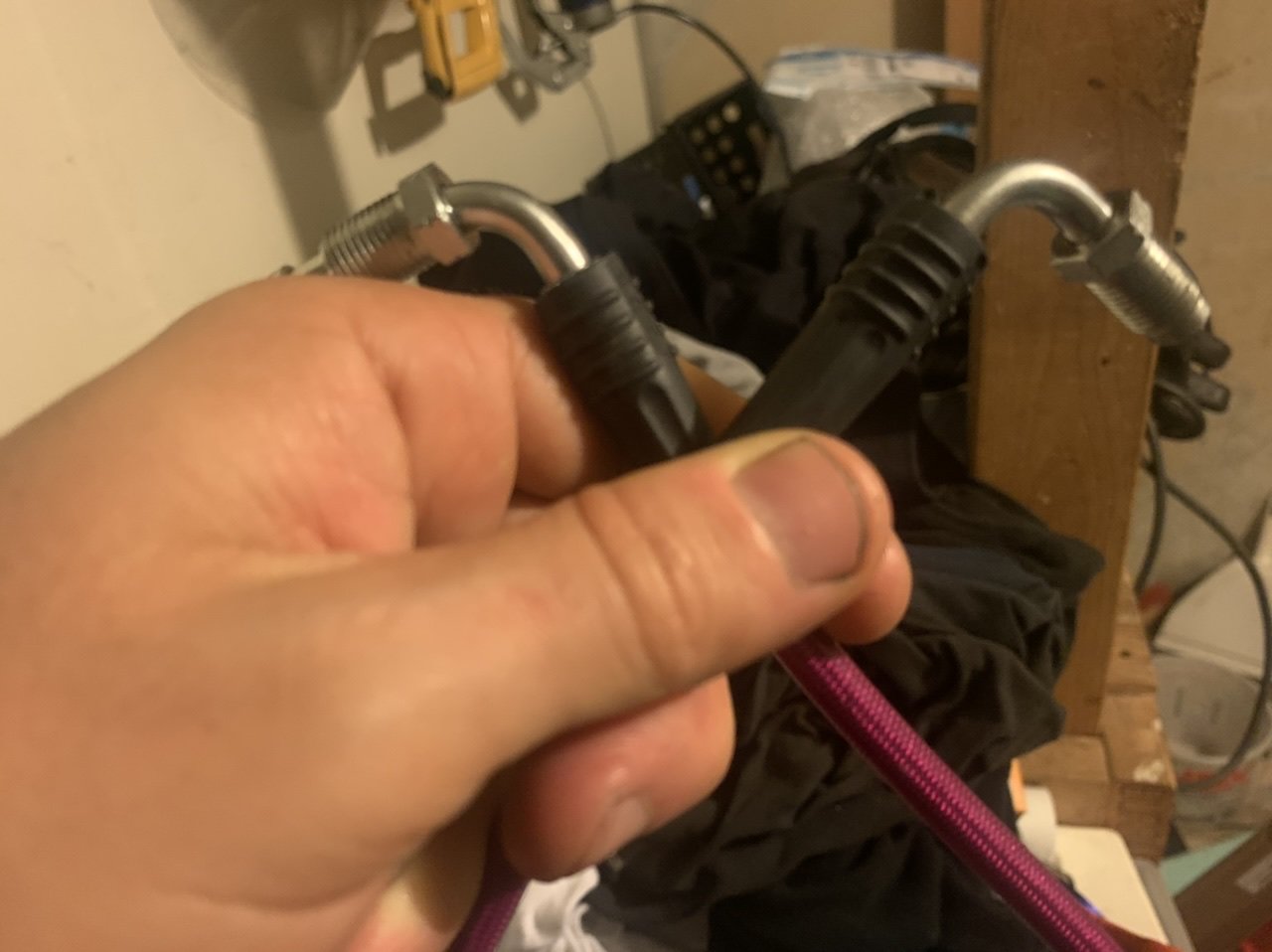

    Look up G and J Aircraft in SoCal- they can make you any brake lines you want - I got these with a hard line fitting at both sides so I bypass the oem soft line locations altogether. These go from the frame mount (junction before the small piece of hard line that mates to the soft line next to the UCA) all the way to the caliper. $69 coated stainless braided.
    In the possibility of someone saying they won’t be able to find a replacement if you damage one - buy 3, plus if you destroy one of these it’s not like you’re going to have an autozone right next to where you break. Bring a hard line plug and / or an extra soft line off grid.
