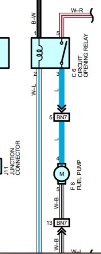

    So aim doing a kill switch but can figure out the color wire thats feeds power to pump . Is it the solid blue wire or blue n white ??

    4,630
    solid blue is +12v "In" white/blue is the ground side.

    So i cut the blue wire but truck still started .
    Ideas ??

    Thanks for the info all done works perfect :thumbsup:

    are these pumps solid on/off or are they pulse width modulated? Best I can tell from the wiring above, they have a direct battery feed (relay activated) and a direct ground. No computer control anywhere for modulation. I'm just trying to be crystal clear before I take the next steps in my project.

    they are a run all the time with a regulator and fuel return line system.
